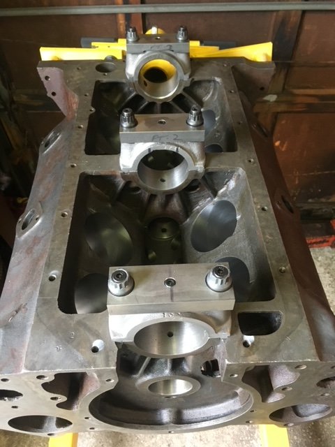

    Hemi, I wasn't planning on running a balancer. I don't know anything about running one except what I've read which is the belt will act as the damper. I'd love to hear opinions on this.
    Again, I don't know anything on four bolt mains. I know on Flatheads a lot of people would say they can weaken the webs of the block. On my blown Flathead, my builder & I opted for the custom made billet cap straps.
    I'm not familiar with the main stud girdle, but I'll look into it for sure.
