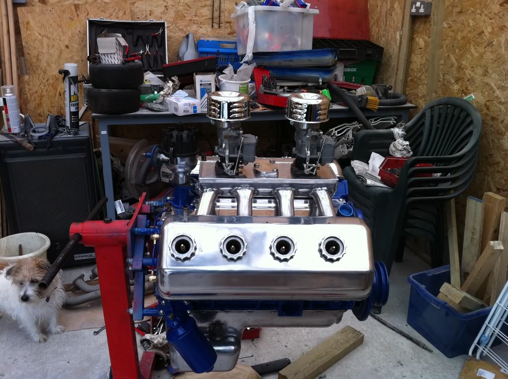

  20. chopper york
    Joined: Feb 20, 2011
    Posts: 18
    chopper york
    from England
  21. Weasel
    Joined: Dec 30, 2007
    Posts: 6,696
    Weasel
    Good stuff chopper york. I am posting the photo from your link here....
  22. chopper york
    Posts: 18
    chopper york
    from England
    and my nearly finished headers,f**king nightmare to get em right but just about done.never again;-)
