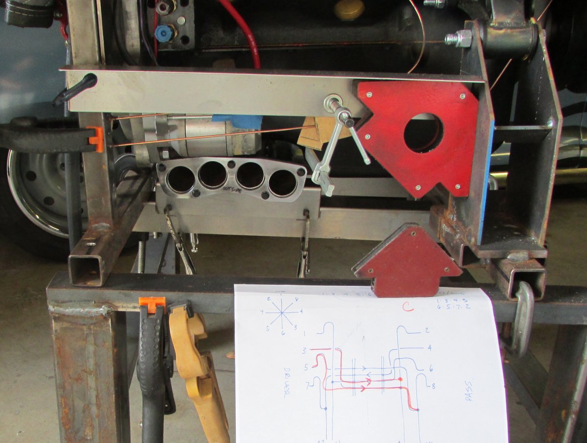

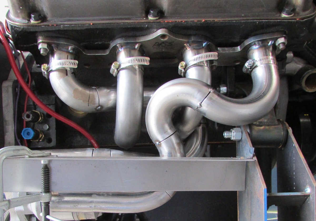

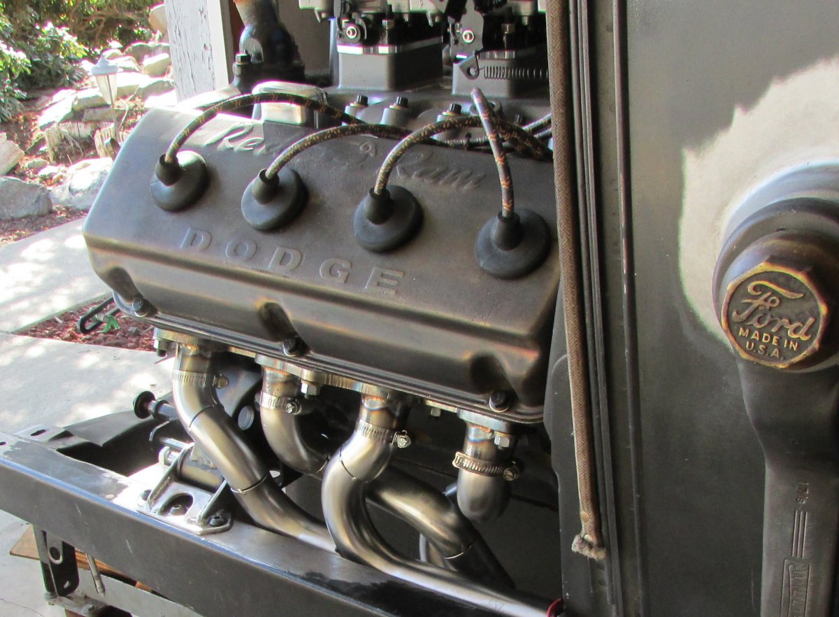

    Well, to start off, tell us about those headers.....

    I made those headers back 'bout 2015. I made a set back in '58 but they were so ugly I gave up. Figgered I could do better 'cause I'm all growed up and more patient now. Still more ambitious than my talent capabilities. I started this set trying to do 180 degree headers but soon ran outta room. So ended with what you see now. In the new build, I'm gonna try once again to do the 180s and have secured a rear sump oil pan. Also I'll use 1.50" primary tubes instead of 1.625".
