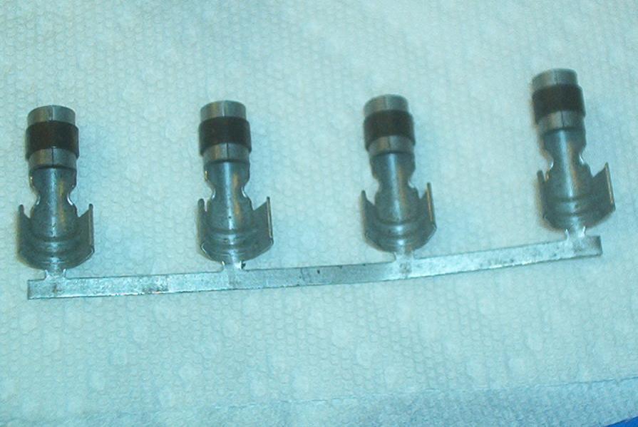

    Where do you find the snap on type ends for the 7mm wires. I have a nice set from NAPA, but they won't snap on the plug with the little clip on it. If I take it off, then it goes on the spark plug(Very loosely) end but doesn't snap on. I'm running no covers but have the 426 boots. My buddie said just cover them with the insulator and they wont come loose cause the boot cover will hold them on the plug. I pulled a wire off the 354 sitting in the corner, slid it on the insulator and it snaps right on....
    1st pic... wire w/ end on it is from a 354 I have sitting around
    2nd pic is the type of clips you get now
    3rd pic is a side by side comparision

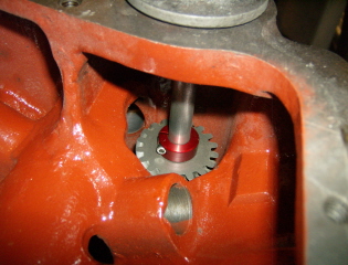

    A common problem with Mopar small blocks, big blocks, and the early hemis. Most of the time it can be ***ociated with the intermediate shaft not staying where it should be..... seated on the lower bushing.
    This item is not a new idea of mine by any means, but it is a new product that I now manufacture and sell.
    This collar clamps onto the distributor shaft and keeps the intermediate shaft and gear from climbing or bouncing.
    It is anodized aluminum with a nylon patch stainless steel Allen screw to secure it. It is also a split collar....so that it clamps 360 degrees around the shaft (ok...maybe 358 degrees....since there is a slot), unlike the solid collars available with a single set screw.... which only hit the shaft in two places...the set screw and 180 degrees opposite.
    It is NOT a generic .500 inch collar that many dealers sell. You know....the ones you hear about falling into the oil pan? The ones you have to wind down with full force to get them to stay.
    My collars are custom machined to fit the Mopar distributor shafts. They slide on snug and are easy to adjust.
    If you have a timing problem, maybe this info will be of some help.
