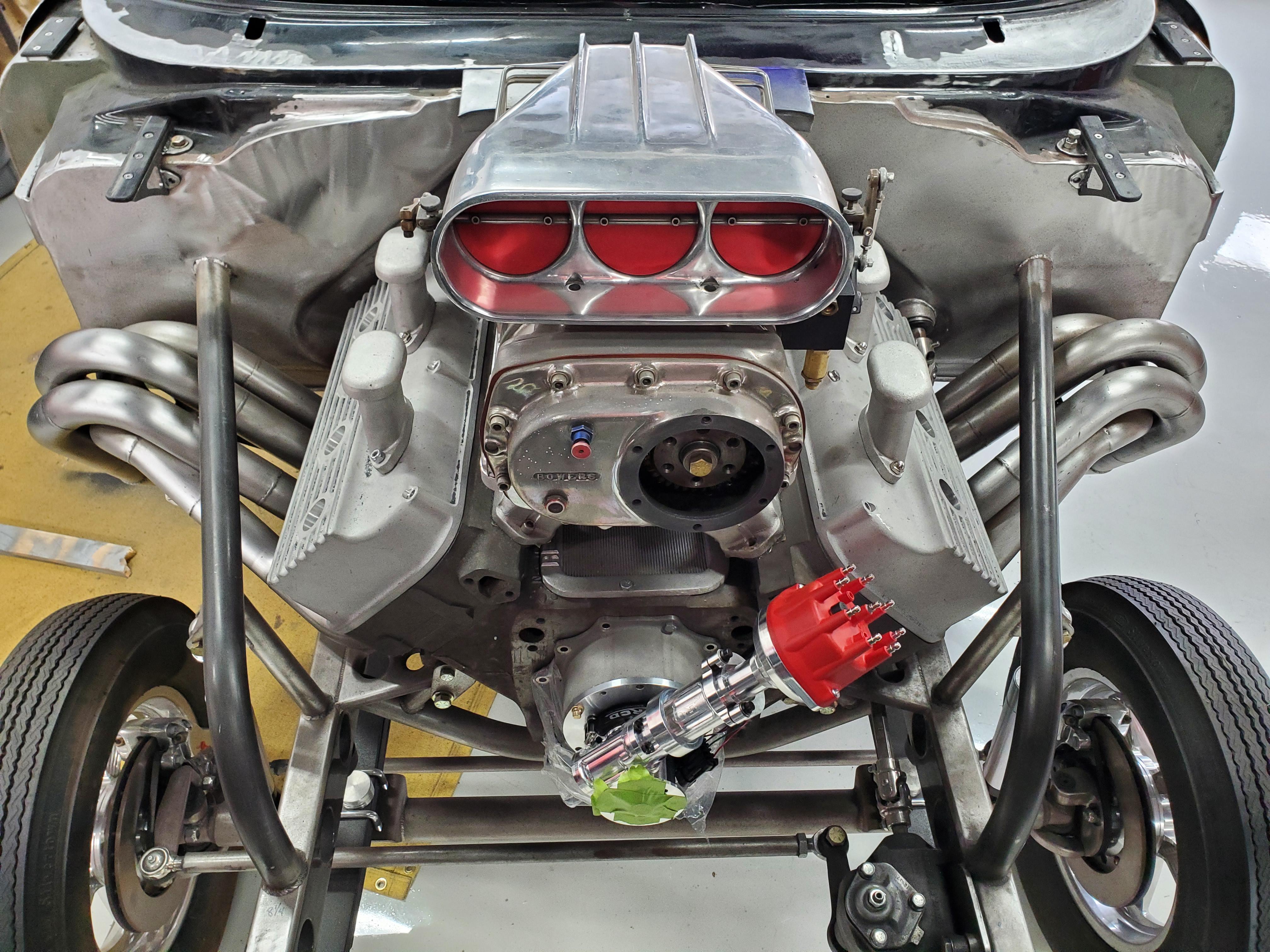

    Anybody ever mount a distributor off timing cover on 392?

    Hopefully this combo will work[​IMG][​IMG]

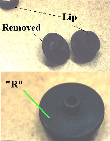

    I run a factory LA electronic distributor with an extension tab I gas welded on. Also run an MSD 5 module. I modified stock steel tubes by hammering over the lip to squeeze the stock rubber seals. I use Toyota tube seals with the outer rim cut off. Finally I use Accel yellow wires with long silicone extenders. Works great.

    One step closer to front mounting distributor on my 392[​IMG][​IMG]

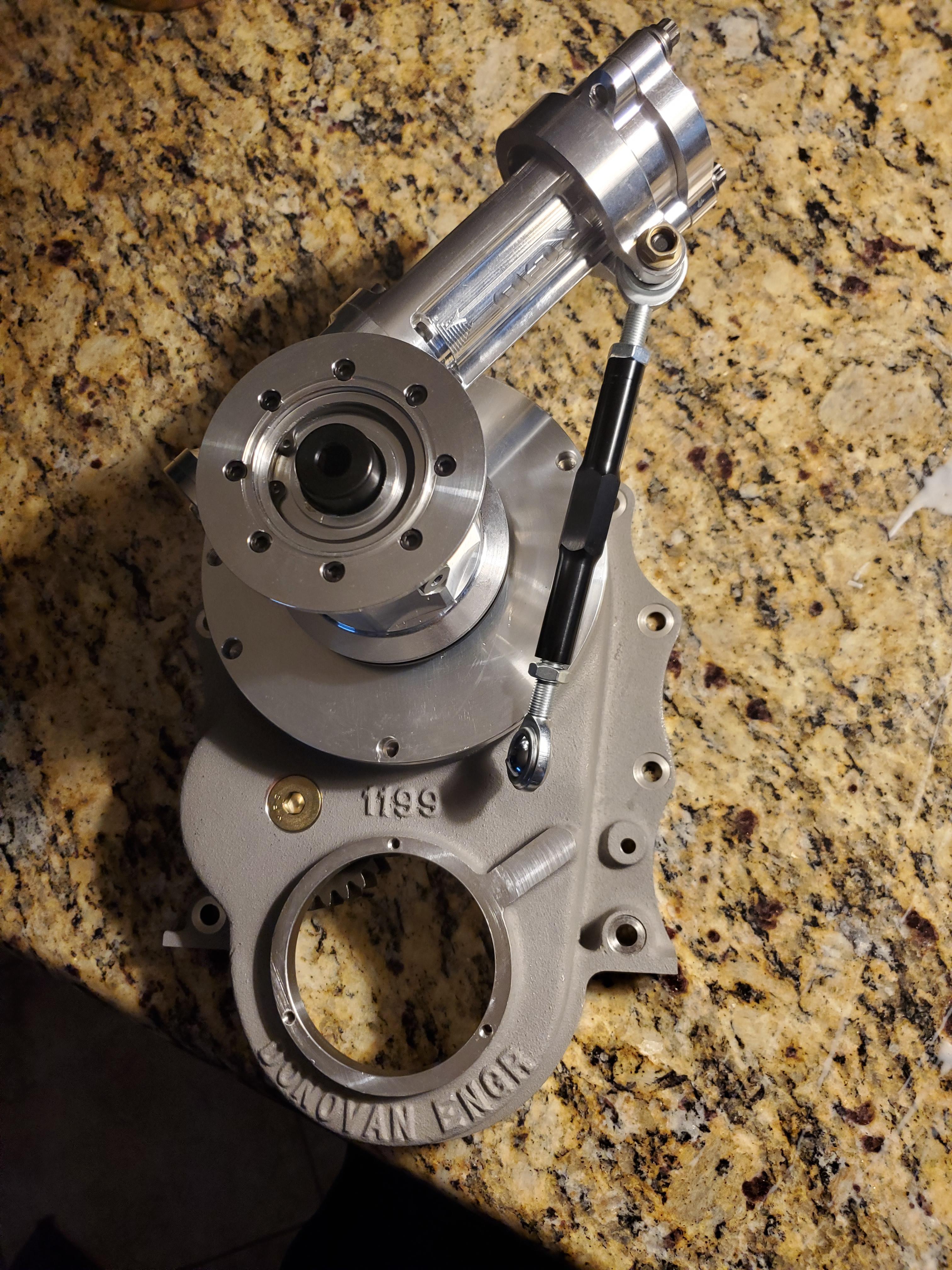

    Waiting for distributor [​IMG]

    One more piece of a big puzzle [​IMG][​IMG][​IMG]

    Dizzy on an air raid siren. [​IMG]
