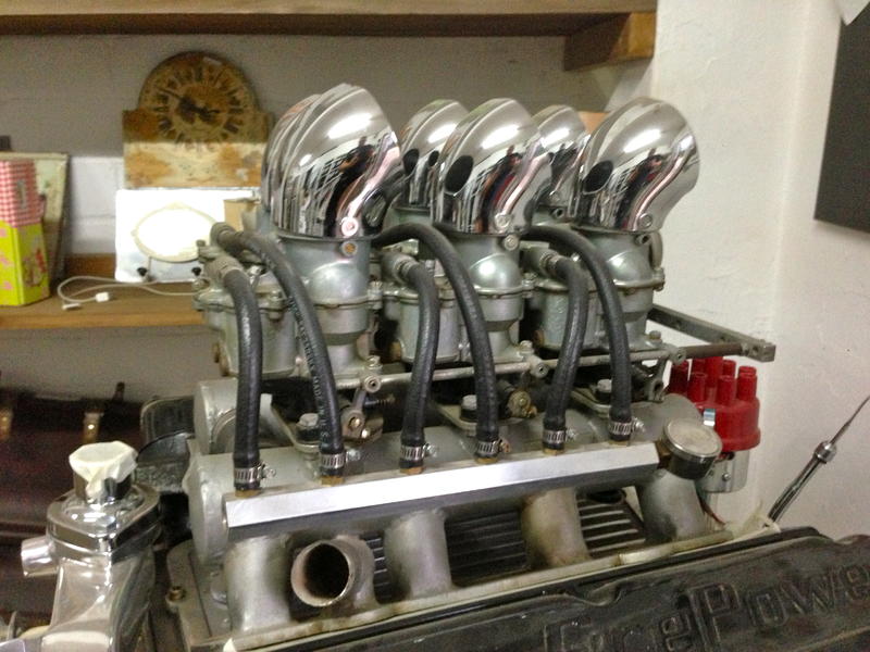

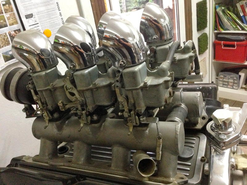

    hello
    can i put this 392 intake on my 1956 354 engine?
  22. 41hemi
    Joined: Jul 2, 2007
    Posts: 1,014
    41hemi
    Yes that intake will fit the 331,354,and 392!:p
  23. otti
    Joined: Feb 11, 2003
    Posts: 43
    otti
    its the angle head to intake 354-392 the same? the 392 heads are higher than the 354/331?
  24. 41hemi
    Joined: Jul 2, 2007
    Posts: 1,014
    41hemi
    When Chrysler made the 392 which is a taller block than the 331,354, they simply made the difference up in the 392 heads. All the intakes from 55 on up will interchange. If you use 331,354 heads on a 392 block, you simply use spacers between the heads and the intake.
