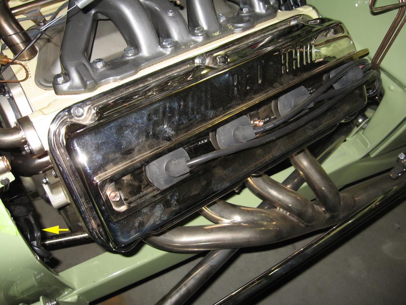

    Can anyone tell me the length/height of a spark plug insulator for the 426 Hemi?
    I am running a 325 KD-500 Dodge in my track roadster and in order to run modern thickness ignition wires the builder fabricated spacers to create more room under the covers. Thus, a longer or taller spark plug insulator might work well if it's not too long.
    Thanks,
    trakrodstr
    See more at my project thread:
    http://www.jalopyjournal.com/forum/showthread.php?t=356019&highlight=track+roadster&showall=1

    Thanks 345 DeSoto,
    I was asking about the insulator/connector that fits over the spark plug and attaches to the ignition wire.

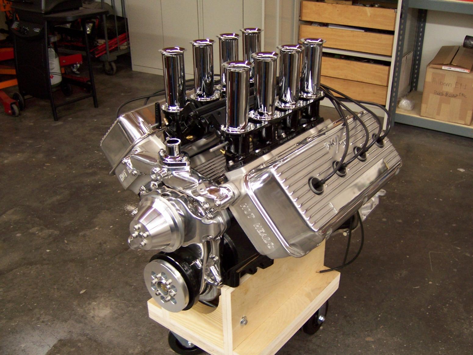

    I have a early hemi I recently purchased (my first) and the seller described it as a 1958 Dodge 354 Hemi out of a dump truck. I finally got it apart (with alot of patience, 2 cans of PB Blaster and heat,. wheew) and it looks like has never been gone through before.
    Headed to the machine shop but wanna make sure I'm on solid ground with the ID.
    Valley casting number is # 1619829-7 and number stamped on the front of the left bank is VT576.
    Any help??
    Thanks, jeff

    Jeff, take a look at the ID thread linked above. You will find plenty of info on that number. At first glance, it does appear to be a truck number.

    The block casting number is 354! I'll add the vt 576 to the list. Thanks!

    Thanks, the link is awesome. I dropped the short block at the machine shop here locally this morning,. I've got the heads that came off of the 354 engine which appear to be truck heads with the "tall" heat p***ages and second set of 392 p***enger heads.
    I want to run a 2x2 edmunds intake but the 354 truck heads with the tall heat riser p***ages in the center arent covered by the intake. In the link you sent me it says the 392 heads will work on the 354 short block but I cant use my edmunds 2x2,. Sigh,. Seems like there should a way,.
