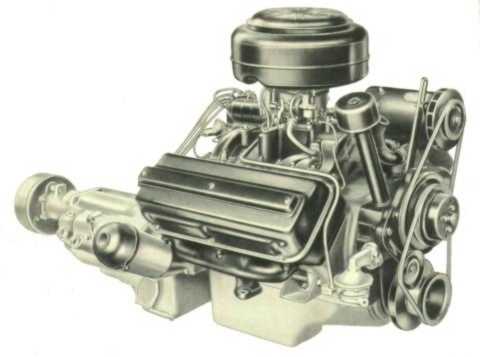

    Anyone have a picture of a restored setup with the linkage and everything intact? All I was able to find was this...

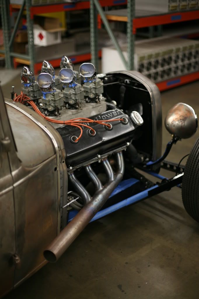

    Anyone got pics of lakes style Hemi headers? Show what you got, homemade or bought.
  13. Kerry
    Joined: May 16, 2001
    Posts: 5,155
    Kerry
    Here's a set I made out of a 36 Ford driveshaft.

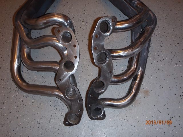

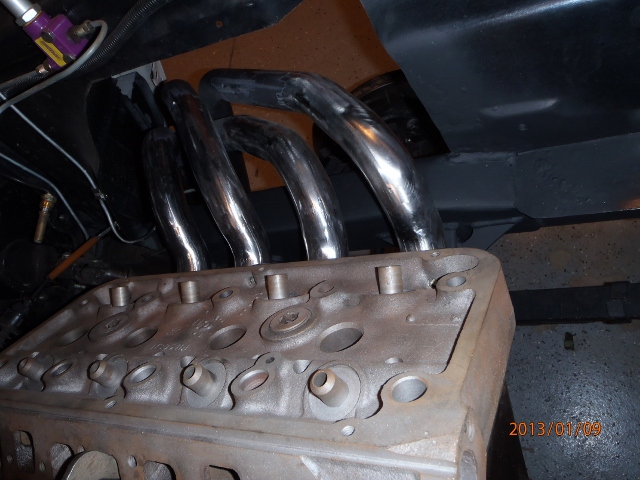

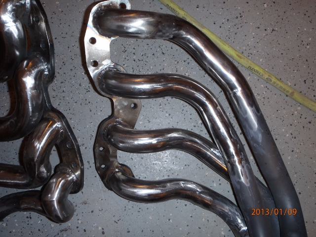

    Just finished up fabbing a set of headers for my 325 Dodge Hemi that is going in a 65 Barracuda g***er. Had a set of chevy fenderwell headers that fit the ch***is so decided to start there. We cut back the tubes a ways and set to fabbing the new tubes to fit the Hemi exhaust flange. Quite a bit of work, but there just aren't any headers out there "over the counter".

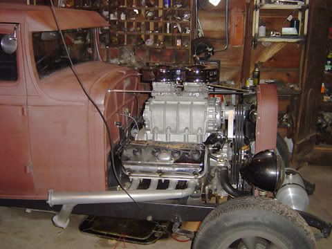

  27. need some help with ID of this blower manifold.
    its marked a wieand wc671 and I thought is was a typhoon, but mine is different,
    Problem is that the blower bolt pattern is shifted rearward, the popofff is also round in the rear.
    This is Kerry's manifold that is a typhoon.
    This is an aussie reproduction of it
    Here's the manifold I have
    larger version
    http://www.jalopyjournal.com/forum/attachment.php?attachmentid=1912508&d=1365855109
    larger version
    http://www.jalopyjournal.com/forum/attachment.php?attachmentid=1912509&d=1365855581
    as you can see, On my manifold, the front bolts that go into the head are not under the blower. the blower matting surface and hole pattern are shifted rearward on my manifold.
    I was wondering if this would be for the 2" belt and coved pullies version?
  28. supposed to be this setup ???[​IMG]
  29. George
    Joined: Jan 1, 2005
    Posts: 7,995
    George
    Well...you were saying yours is well back & interfering with the Dizzy. That's only a drawing, vs a photo, but it far enough forward it seems to be obstructing the view a little of the head block off plate & looks like it doesn't go back much beyond the last plug tube.....
