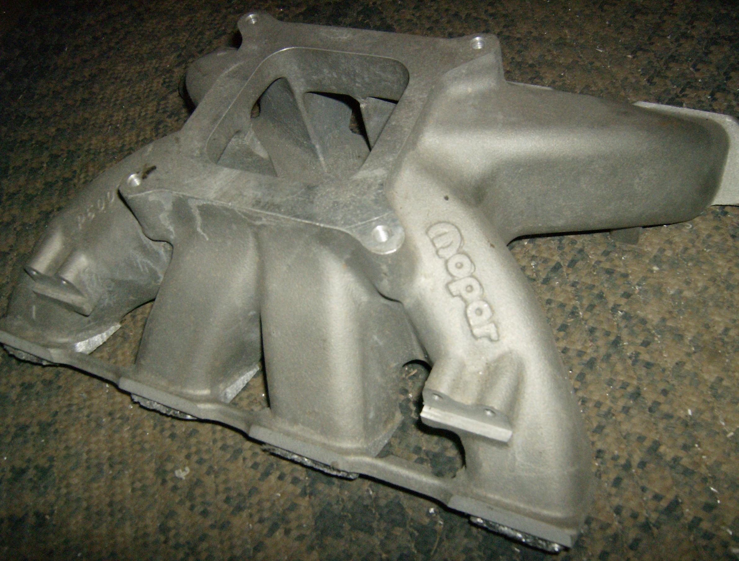

    Interesting. That first picture is the one I have on my digger and is definitely a WC671. Aside from the length difference the popoff is different as well. Did Weiand make different run's with the same model number?

  3. Make it fit , ? ?
    Maybe there's more options but I see 3
    1Make an adapter plate to reposition the blower more forward.
    This misaligns the charge hole by 1.25 rear and 1.25 front 2.5 total smaller. I don't like that much.
    2 rework rear plate and add/make a spacer to the front & put a spacer on the coupling .
    Seems better but might look wired up front.
    3 right manifold . Expensive reproduction of the typhoon or hunt for original,
    Or the new weiand
    I believe the best of those 3 will be the correct manifold
    Maybe there's more options and I have tunnel vision
  4. Kerry
    Joined: May 16, 2001
    Posts: 5,155
    Kerry
    If'n I were in your shoes I'd tackle option two, partially because I'm cheap, partially because that manifold is cool, and partially I the the changes will look fine. The rear plate looks pretty cool pruned. As far as the front, the spacer probably wouldn't look bad at all. Just my 2 cents.
  5. 73RR
    Joined: Jan 29, 2007
    Posts: 7,342
    73RR
    The '3' options are all viable, which one suits your own sensibilities?
    1. Requires a chunk of aluminum and several hours machine time.
    Does the shift forward actually have a big/negative affect on the operation? What is the minimum amount of movement that will produce the 'cure' ?
    2. Not much material, but still plenty of machine time.
    3. What are the costs ***ociated with each manifold option and how do these numbers compare to #1 and #2 ?
    This is a street package, isn't it?
  6. Well my supplier quoted 125.00 for a 3/4" 6061 plate for an adapter.
    The adapter plate is probably the least $ way to fix this but i also believe that making tge charge hole smaller is the least desirable consequent of any option.
    I need a 1.25 shift to accommodate the swing arm vs water pump issue and to align the pulleys after the double groove spacer is installed. It's a Bbc short water pump on adapters with the deepest pulley that just rubs the pump body. A small shim will align this pulley with the second grove of the crank pulley. That's the minimum .
    Maybe the charge hole misalignment is a non issue . Just seems that if 1.25" smaller wasn't a big deal, then nobody would bother to remove the itty bitty cross webs from the GMC cases "to eliminate restriction." It's pretty evident that someone drilled a series of 5/16 tapped holes in the center presumably for an adapter plate at some time in the past. They tried it , did it work or not work before ?
  7. 73RR
    Posts: 7,342
    73RR
    Did it work or not, or was it just something done for mock-up or prototype evaulation? The universe is full of unanswered questions.:cool:
    Having been around this car-thing for several decades and, perhaps like you, have seen people do (seemingly) silly or inconsequential modifications you just shake your head at and wonder "why". Often I have to ask myself if the mod is really needed or just some sort of one-up to keep the compe***ion guessing.
    Unless you can run two very similar blower/manifold packages on a dyno (or perhaps a purpose built flow bench) then it will be near impossible to know if the 'itty-bitty' webs or the off-set mounting position actually have a negative affect.
    I suggest putting the package together in a way that pleases you, your eye and your check book. (put those in any order you like...)
    Keep us posted as you proceed.

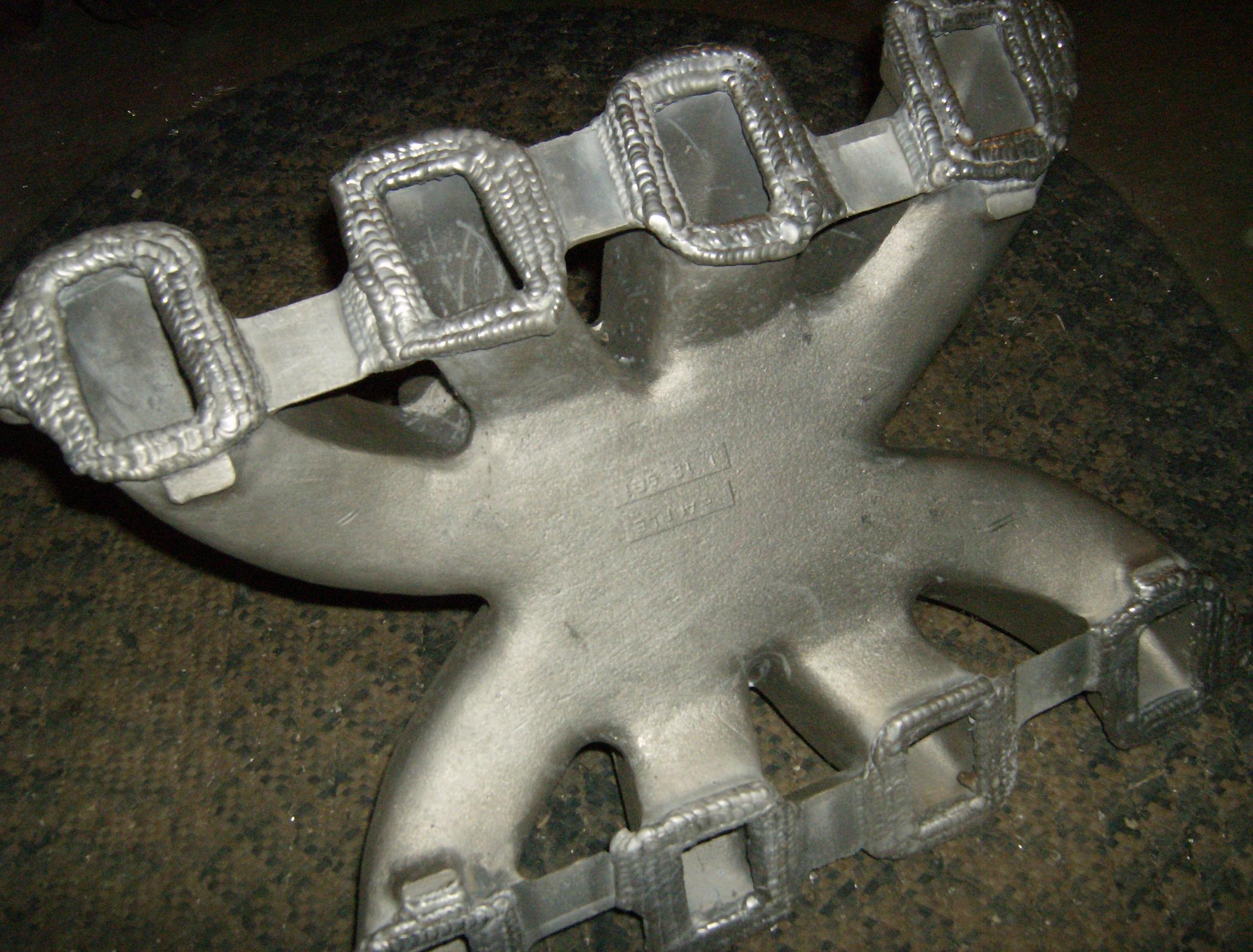

  8. Here's where it needs to be.
    The front blower bolt is damn near in perfect alignment with the valve cover bolt.
    Is that about what you other guys have on your running setups ?

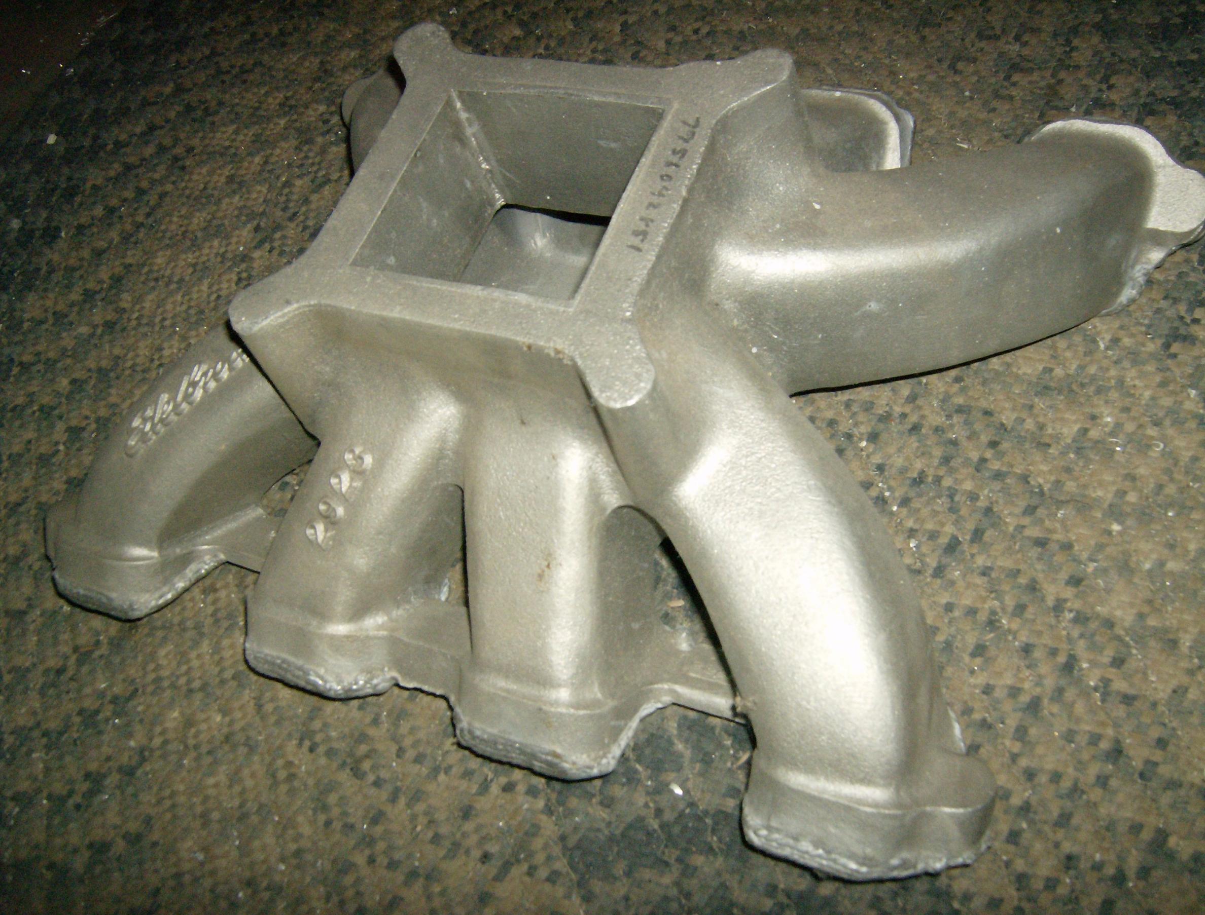

  9. Here's the third design
    And the repro , something happened to the pic up a few posts .

  11. Kerry
    Posts: 5,155
    Kerry
    Most of the WC671's I've seen had the popoff's on the bottom like that. Mine is the only one I've seen with the popoff at the front. Still I can't imagine the changed the rest of the dimensions on the casting for each change. I still haven't taken that picture of the pruned stock rear bearing plate, have I. Sorry...
