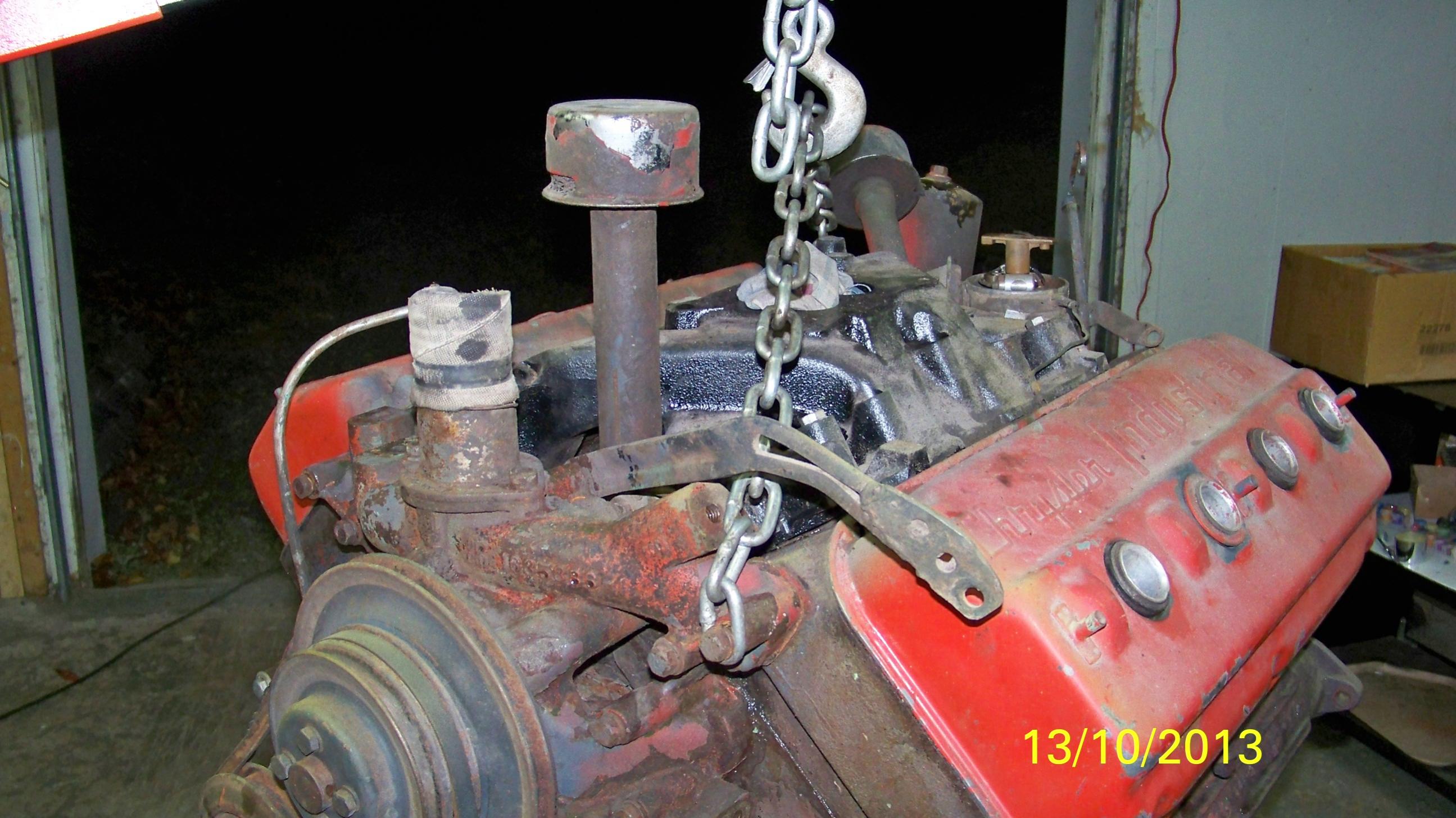

    pic.

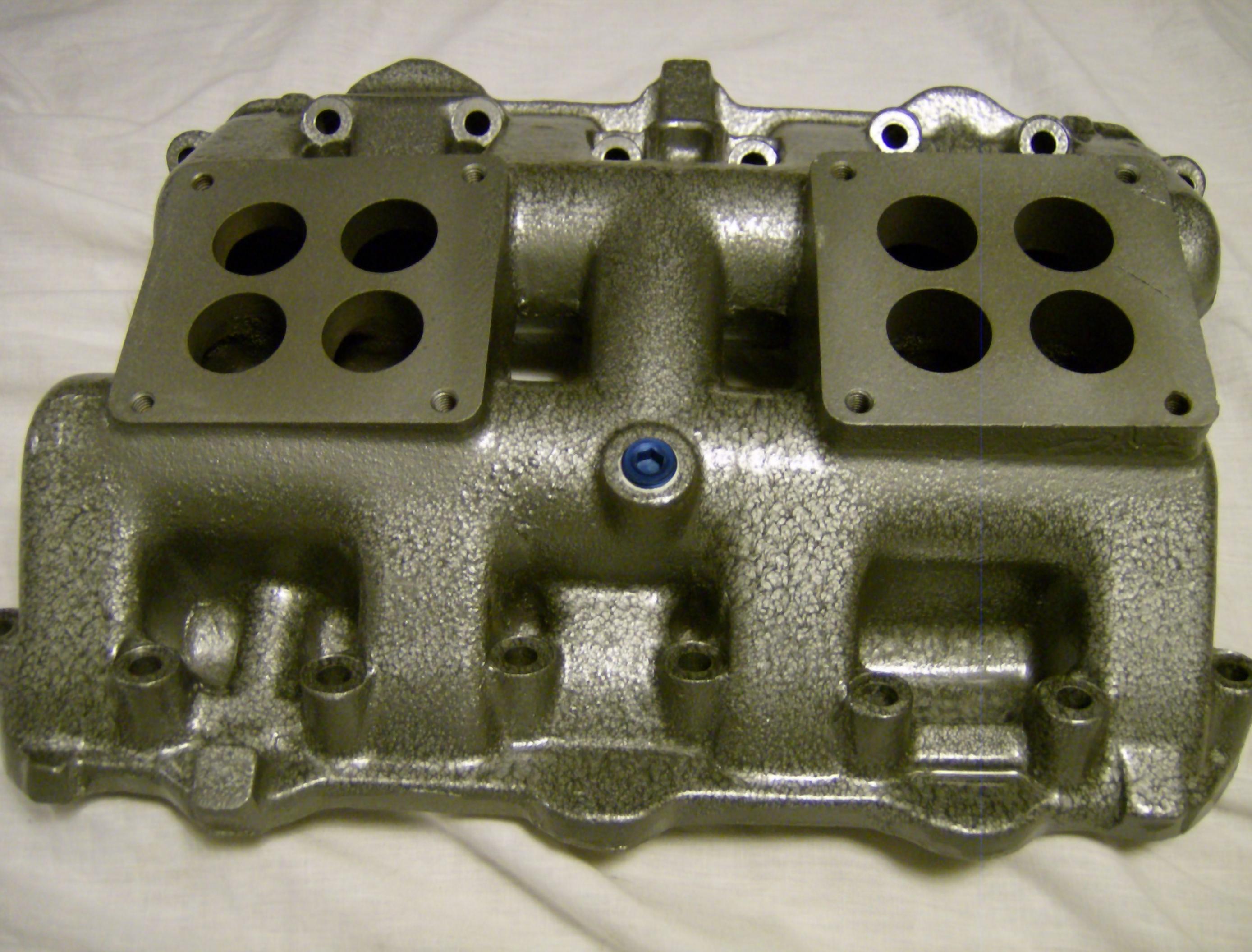

    Hot Heads has the low deck Desoto single 4bbl aluminum intakes in stock.
  3. TR Waters
    Joined: Nov 18, 2006
    Posts: 1,439
    TR Waters
    from Vermont
    Marine 2x4 is the same casting as the 56 300 intakes.
  4. TR Waters
    Posts: 1,439
    TR Waters
    from Vermont
    Converted truck 2bbl intake that I took the water from the sides.

    Yup, the marine 2X1 looks bolted together.

    have a chance to buy a 2 small carb truck intake for good price, I have a spare 331 needing an intake only, can this intake work on the street on a mild 331? I like the look of multiple carbs, and what size carb can I fit on there even if I have to make an adapter for 97's

    Up @ thehemi.com there's a Thread were a guy used adaptors to put 2GC carbs on a 2X1 truck intake. Looked pretty good. I've heard the 2X1 was used on Fire Trucks & they are usually fast!

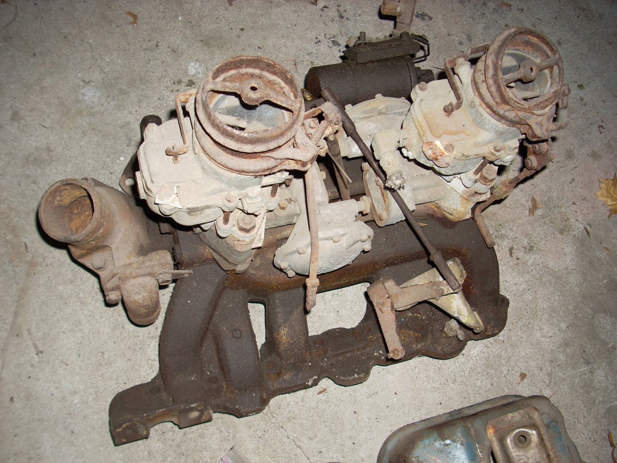

  12. hemi rodder
    Joined: Oct 10, 2011
    Posts: 510
    hemi rodder
    from NB Canada
    here is the intake I was talking about, wet intake, can it be used on a 331 that has the water holes in the heads if I block them?

  14. George
    Joined: Jan 1, 2005
    Posts: 7,995
    George
    You have 2 options: Put the same block offs that are on the back of the head on the front openings & use the integral thermostat in the intake, along with a 392 or Chevy W/P, or...block off the integral thermostat housing in the intake.

    thanks, all the intake ports, bolts holes and water p***ages on the heads and intake all match-up??? any issues?? just want to make sure, he is going to send to me after this weekend. will be paying just as much for shipping as for the parts.it is heavy.
  16. George
    Joined: Jan 1, 2005
    Posts: 7,995
    George
    Should, but there are some heads that have a tall/narrow under carb p***age from the heads instead of the square p***age, can't remember if they're supposed to be truck or IND heads. If you have the tall/narrow you can have the top welded up to match the intake or the HH intake is designed to cover it.
  17. TR Waters
    Posts: 1,439
    TR Waters
    from Vermont
    Will the intake physically fit? Yes. Because it was made for a truck, the casting around the center port (on the head flanges) is enough to cover the smaller car center port. You can use it on your 331 or 354 (your IND engine is a late one which used car type heads) by using a set of block off plates on the front of your heads, where the water pump/crossover would normally be bolted.

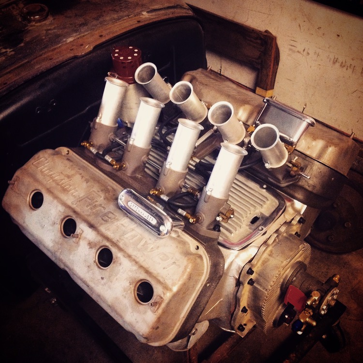

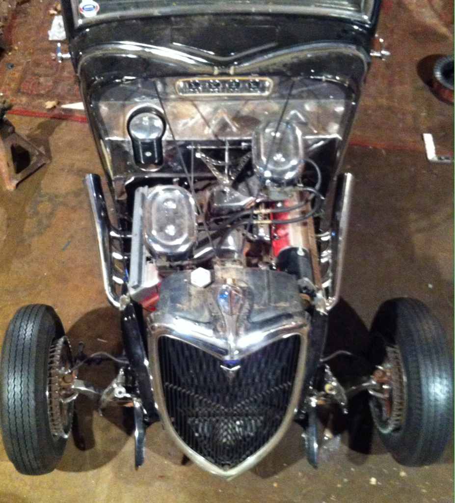

    Here's where I am with the Hemi installation on my 34 ImageUploadedByH.A.M.B.1421771143.799350.jpg ImageUploadedByH.A.M.B.1421771178.274648.jpg
    I apologise for ****py phone pics
    texkbc and Roadsir like this.
  19. I kind of like it . . . a bit 'over the top' like 60's style hotrod/customs . . . but I like that era! Did you have to move the radiator forward - or change it's angle (to clear the fan)? On my 34 coupe (blown motor), had to set the engine back quite a bit.
  20. Wondering the same thing.
    The hood must need to be about 4" longer.
    I really dig the oil filter treatment
  21. Besty34
    Joined: Sep 9, 2010
    Posts: 458
    Besty34
    No I've moved the bulkhead back 3 inches , radiator is in the stock position , apart from the headers going thru the inner fender panels and just the corners of the valve covers poking out of the hood everything will be under the hood

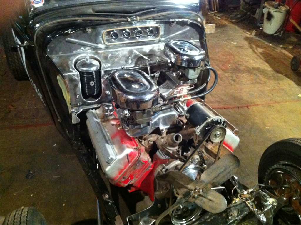

  24. Besty34
    Joined: Sep 9, 2010
    Posts: 458
    Besty34

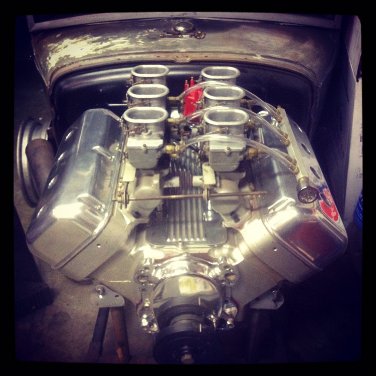

    Here it is finished

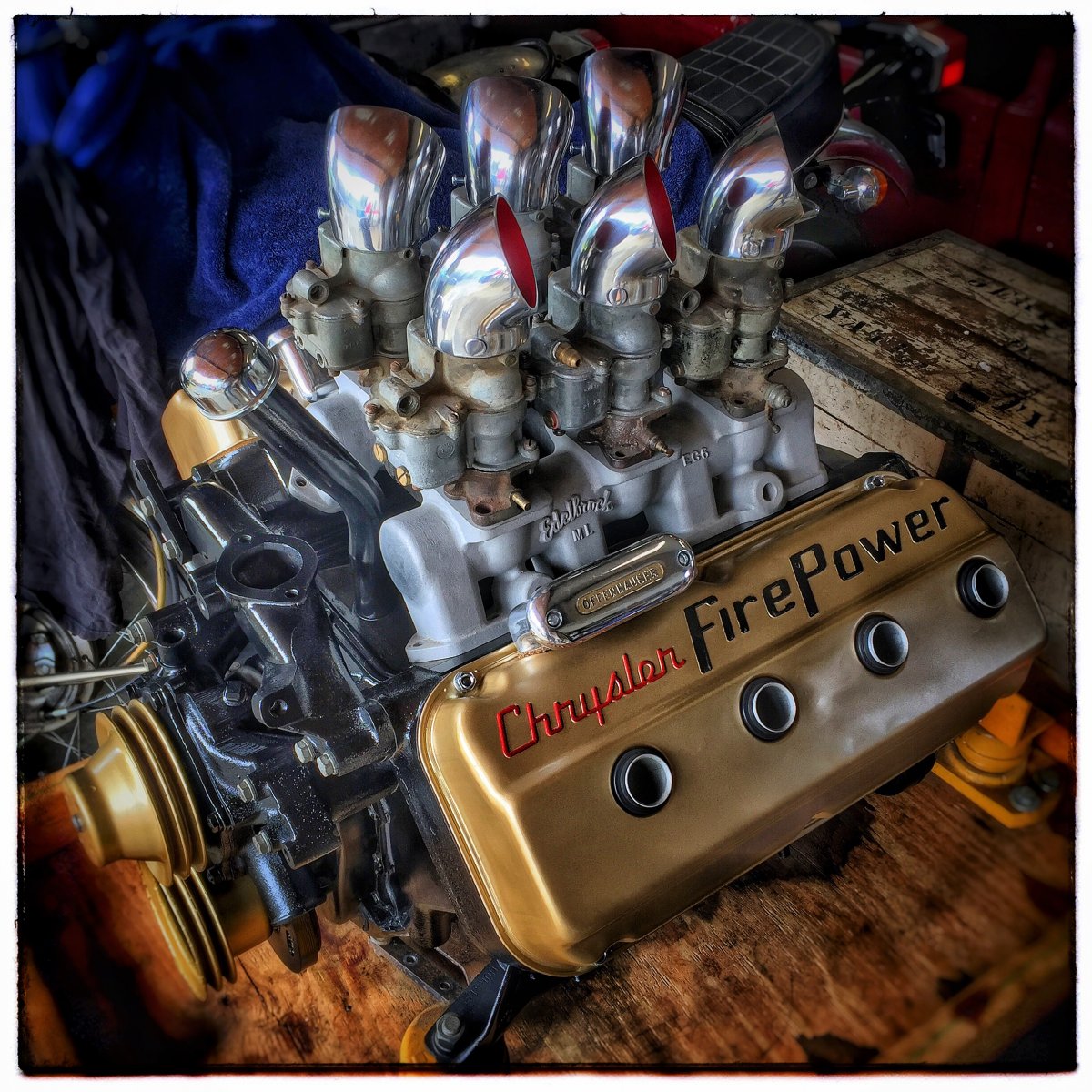

  25. Not really tech, but I figured I'd share a few pics of the intakes that I've had my hands on this year. Some of them are a little bit rare...
    Early Say "Why-And" 2x4 w/ Edelbrock Carbs P/N: WC2QE :
    Again w/ Carters:

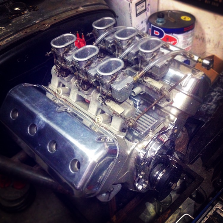

    Hot Heads Tunnel Ram w/ 2x4 top and Edelbrocks:
    Crower U-fab w/ Holley 94's:
    Weiand Drag Star (Short Runner) P/N: WC6 w/ Stromberg 48's:

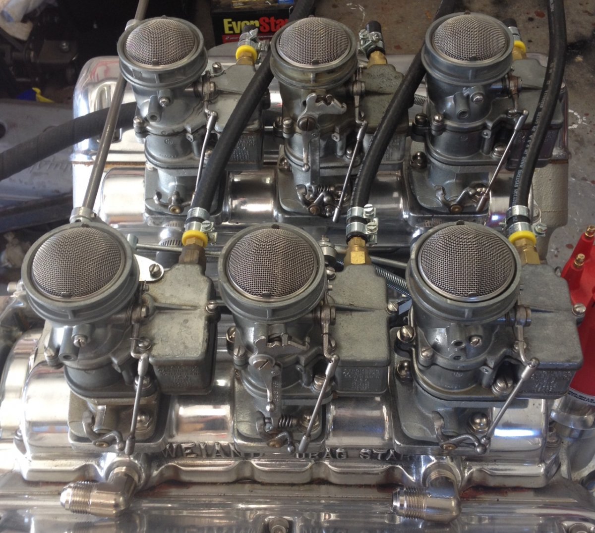

    Weiand Drag Star (Long Runner) P/N: WC6 w/ Stromberg 97's and Repop SP Tops:

  26. Has anybody posted a picture of @saltflatmatt's #GearDrive 6x2 intake yet!? I'll tell you what, it fits PERFECT; no filing carburetor bodies or clearancing for distributors required. And it looks fantastic, if I do say so myself.

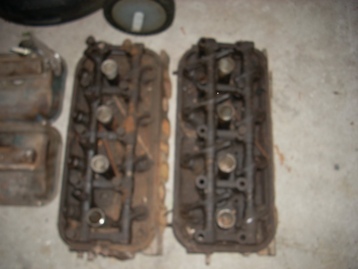

    bostonhemi
    Here is a 2 x 1 that I was told came of a truck and I have the heads and believe they have sodium filled valves. The center intake side of the heads have long narrow openings.
  29. George
    Joined: Jan 1, 2005
    Posts: 7,995
    George
    That is the truck intake
  30. Sorry for posting almost the same exact photo, but this is an Edelbrock ML EC6 Intake.
    One interesting point of the Edelbrock Hemi Intake vs the Weiand Drag Star, is that Holley 94 carburetors fit without filing the front float bowl screw.
