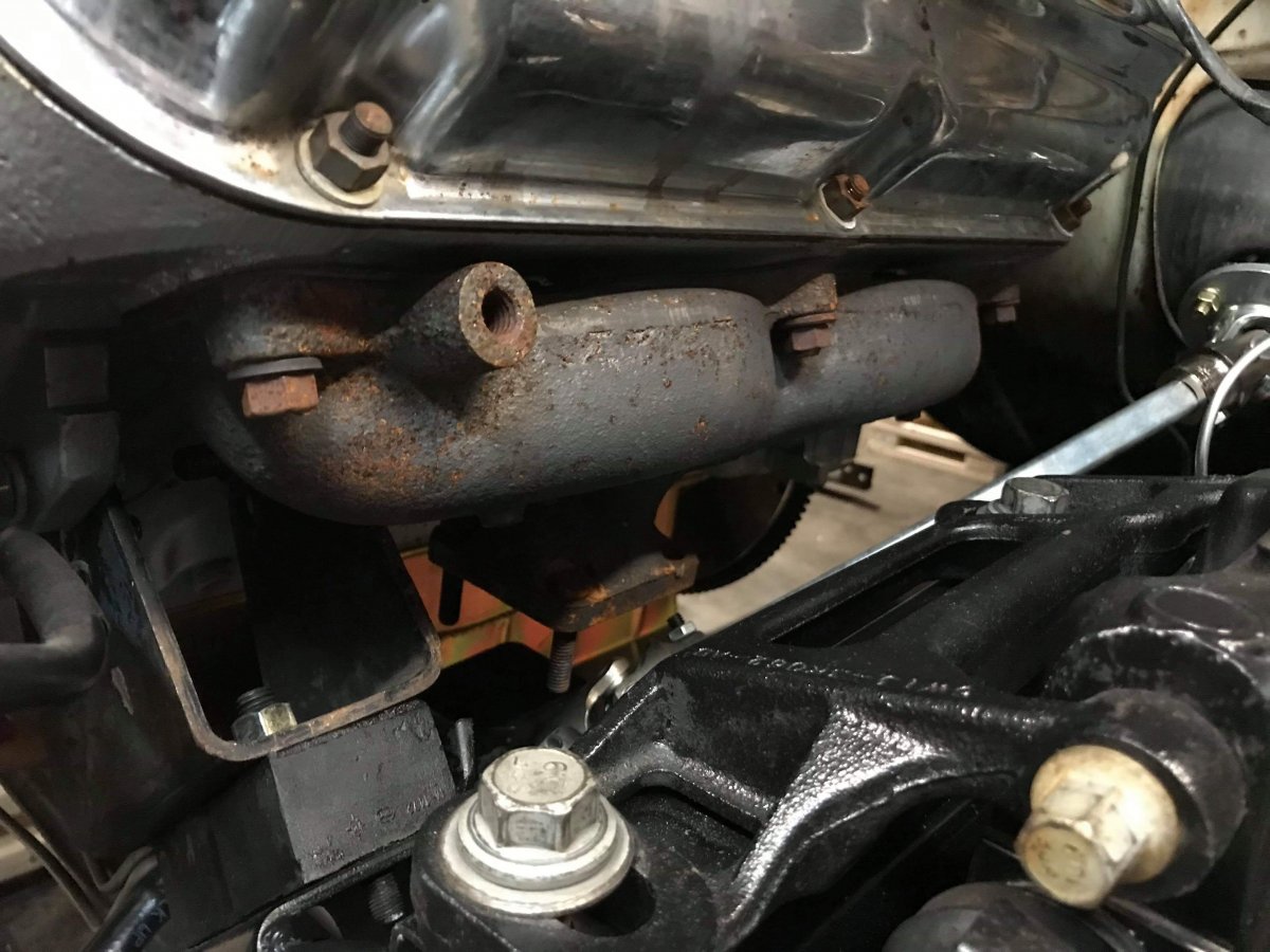

    received_1005388449849792.jpeg received_1991660177610069.jpeg received_10208849921140454.jpeg Hi, Folks... I thought I was in the home stretch on my hemi-powered project, a 1965 Dodge D100 with a 1958 392 Hemi & Tremec 5 speed.
    We got too clever, I guess. We took the drivetrain out and I traded off the Sid's dropped axle & disc brake setup. Then we went ahead and installed a Crown Vic front end.
    All the welding is done and when we went to drop the drivetrain back in... my prized 4-bolt manifolds crash into the original engine mount on the CV frame. I posted a pic where you can see the manifold flange just a little ways above the stand for the engine mount on the CV crossmember.
    I checked the Hot Heads site... they have a nice diagram showing how all of the headers they offer would absolutely not work. I am faced with either fabbing up a set of headers or... trying to find some kind of "rear dump" OEM manifolds. If the collector were moved back a bit, everything would be fine.
    I contacted Sanderson who made a beautiful set of manifolds for my 270 Dodge poly (hand-crafted engine by none other than 73RR). They can't move the collector back unless I send them my truck and (cough) $1500.
    So, anybody have any ideas?

  5. In the big scheme of things 1500 for custom headers isn't bad and Sanderson in California isn't the only ones who'd do it, I'd do it for you in Ohio. I'd bet there's a few someone's in Detroit as well.
    Now you'll be into modifications someplace to get this done.
    Cut out or notch the offending CV parts.

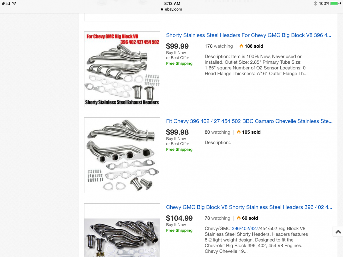

    Modify a set of headers from a BBC, LS, or Ford
    Modifying your plan and Change the front end to suit the hemi or change the hemi to an engine that suits the front end and both of those seem way to drastic if just 1500 gets you out of the jam.
    I'd have to look at it the whole thing but my gut tells me hack the offending CV stuff out of the way would be the best way as that is the problem. Exhaust that doesn't fit is the symptom, but without looking or being familiar with the CV setup modify or custom make the exhaust might be easier

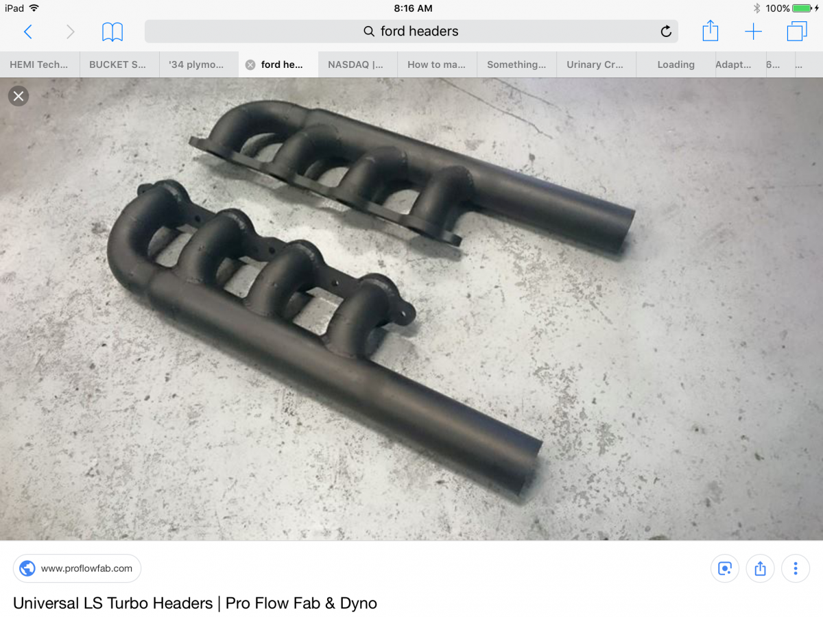

  6. Something to think about
    Modify or build your own
    Very primitive but Something like these could be turned around with a turndown collector
    Make them nicer if you want

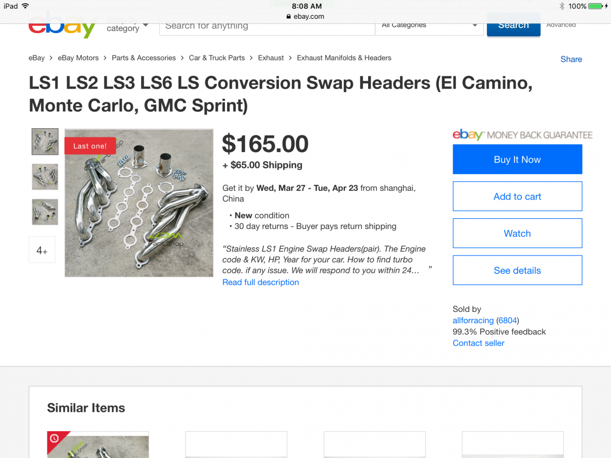

  8. That's an ls manifold pattern holes on center
    BBC hole pattern is high low high

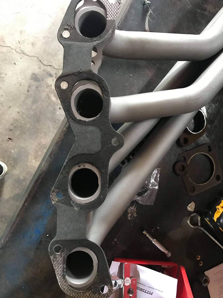

    We ordered LS manifolds & Hemi flanges from Patriot because they have a "tight tuck" piece which has rear dump & is tight to the engine. Here is a pic of a hemi exhaust gasket laid over the LS manifold received_1858673194237688.jpeg

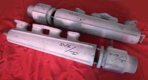

    George
    Industrial ones look similar.

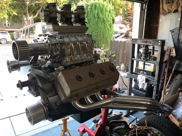

  14. Little pushing after the cutting and you’ll be good.
    I made oval transitions to round to take advantage of the large ports and funnel into round primary tubes.

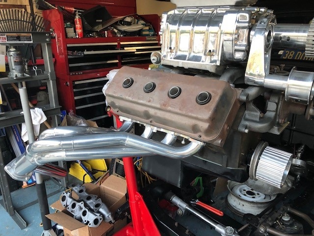

    Well....we keep trying. This set from Patriot hits the starter. I basically need a block hugger with offset collector. Pics show yellow box where collector needs to be. Last pic shows the optimal space where headers would fit. @31Vicky...if your shop were closer....vehicle is in TN right now. received_427255071376636.jpeg received_2135956783153680.jpeg
    Sent from my SM-G892A using The H.A.M.B. mobile app

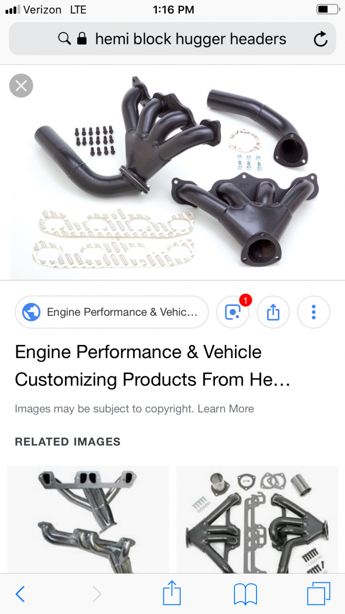

  17. I can’t really move it lol
    The standard issue block huggers won’t work?
