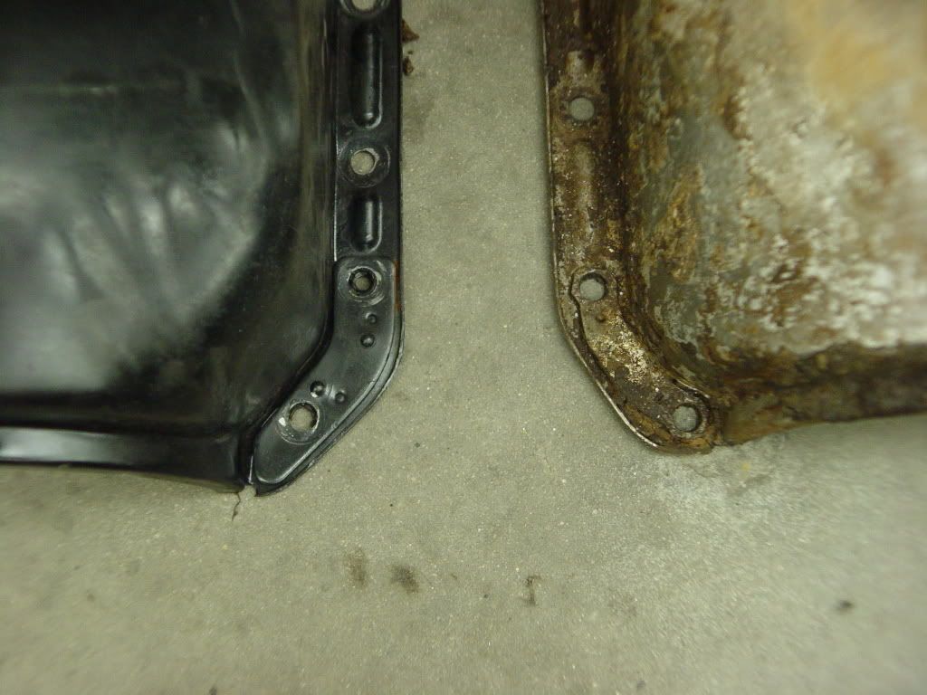

    I just took a few pictures of the two pans I have, side by side. The center sump pan has the later style rails and is about a 1/4" shorter. Here's the two side by side...
    I'm thinking of trying to make the shorter center sump pan work, somehow. I would like to run it. Maybe that will make a nice little tech thread....

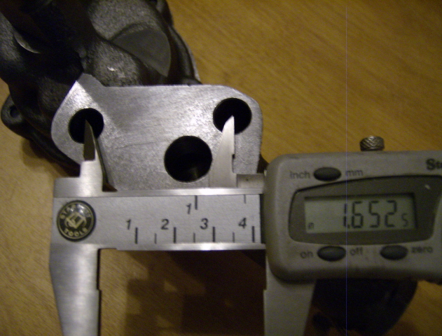

    Nope! They hole pattern is juuuust slightly different, unfortunately. I have a Melling unit for my 331 Truck motor and it will bolt up to the later main cap, but the hold placement is just different enought that it won't bolt up to an earlier 331 rear main. Was another one of those "dammit, I didn't think about" situations when I was building my early 331 motor. Couldn't figure out why those bolts wouldn't go in and then I took a close looks and cried a little. :eek:

    There are two different pumps; early 331 (51-54) and basically, everything else. There are two main differences, one is in the bolt pattern and location of the oil p***age, slightly different between the two and the general design of the pump. The early 331 pump easily fits in a rear sump pan, and does not fit in a centre sump pan (392 style). There are also differences in the pickup tube attachments. Most of the early 331 pumps had a slip fit tube retained with a cotter pin, however, I have some cover plates that are tapped for a screw in style tube like the later units.
    It is curious that EGGE shows six (6) different part numbers in their catalogue (102, 103, 105, 106, 107, and 108), and Chrysler parts book shows four (4) different numbers (1324210 for 51-54 331; 1327466 for the 52-54 276/291; 1532875 for 53-55 241-260-270; and 1851434 for 56-58 354/392; 55 270 Ply; 56-58 315,325; 55-57 291-330-341.

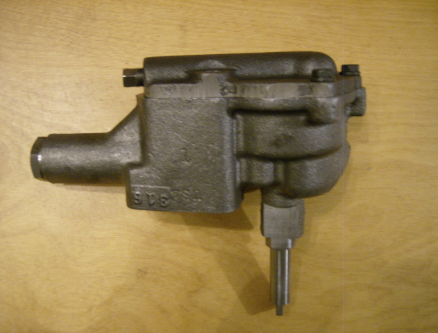

    OK boys and girls. Here is one of the new Melling early hemi pumps.
