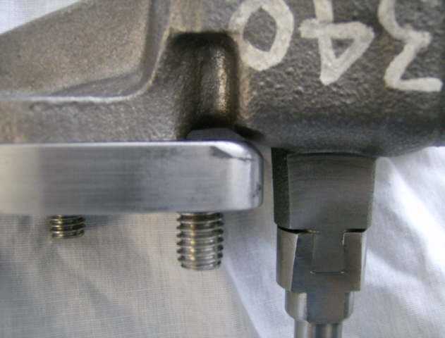

    Here is something that I dont recall as ever being addressed, and it could relate to some of the problems with using a converted LA pump.
    These are a couple of pumps that I aquired a while ago. I have no idea who did the conversions, so I will just call them pump 1 and pump 2.
    Pump #1 is a high volume pump, made in the U.S.A., with no brand name. The adapter plate on the bottm clears the pump body by about .010, but it clears.
    Pump #2 is a Melling M72HV pump. I had to relieve the corner on the adapter piece to make it clear the pump body.
    It could be very well true that some of the pump problems we have heard about, especially the binding shaft problems , are due to the plate hitting the pump body and never being noticed. Something to look at.
