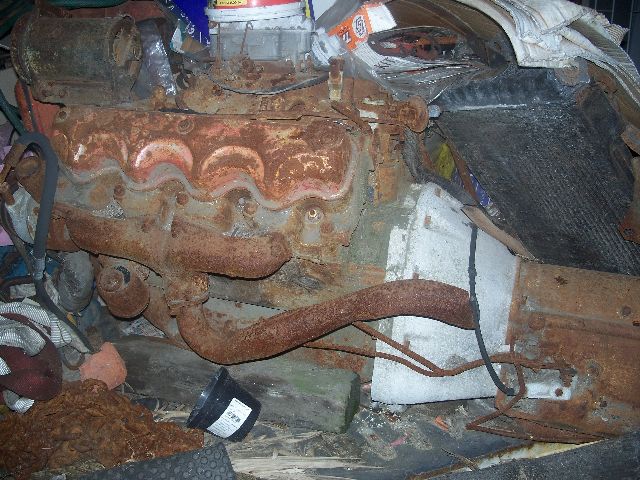

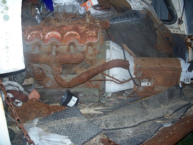

    Hi Guys,
    Joining in here for the first time ; I am investigating the purchase of an engine seems to be a 354 Spitfire. Owner said it was a 392...not aware of any 392 Spitfires
    Clues:
    Apparently out of a 58 Saratoga, Have a castiron intake with a 4BBL of some sort on it - which gels with the 354 out a 58 Saratoga
    I apologize for the pictures as the current owner well it is buried beneath rubbish.
    I notice that is have a power steering pump, and a W cast on the lock just above the starter location.
    I am waiting on better photos - and the engine serial number.

    Very cool, if you can get ahold of it!
    It does appear to be a Spitfire motor, and I would also guess it's not a 392. The numbers you will need to identify it are on the top-front of the engine, right behind the water pump on top of the block right in front of the valley pan.
    Good luck! Hope it works out for you!

    The 'W' says 354..............
    Excellent engine IMHO.

    Does "rubbish" = "a lake"?
    LOL! :D
