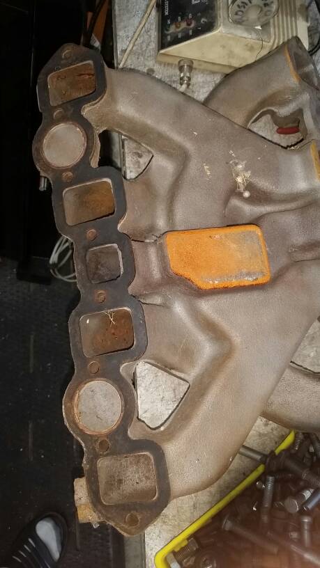

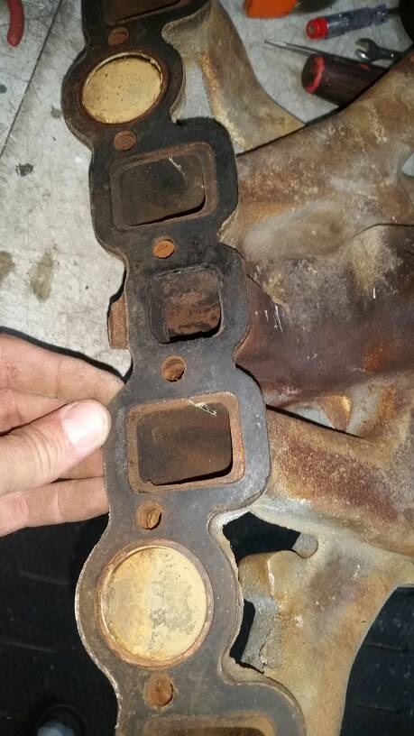

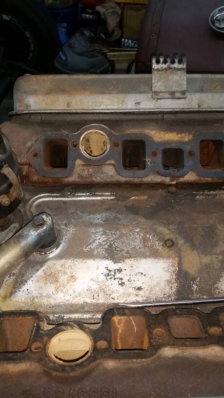

    A little more poly porn!
    The 55 301 poly heads have large ports that match the hemi intake.
    Last pic shows how small the 2 barrel intake ports are!
    0.2 on the floor and 0.1" on the sides and roof
