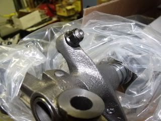

  16. 73RR
    Joined: Jan 29, 2007
    Posts: 7,342
    73RR
  17. bd180
    Joined: Jul 26, 2010
    Posts: 11
    bd180
    73rr looks like nice work what do you charge . how about contact info. thanks bill
  18. TR Waters
    Joined: Nov 18, 2006
    Posts: 1,439
    TR Waters
    from Vermont
    Rockerarms.com has been doing this conversion for years. Gary knows his stuff. This is a set done by them, along with my hard chrome shafts and rocker collar set.

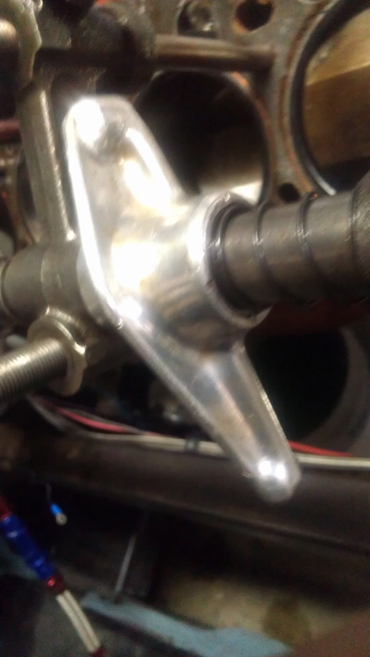

  29. rbpbob
    Joined: Jun 8, 2011
    Posts: 17
    rbpbob
    does anyone know where some of these are I need one ,M/t or donovan ?alum exaust rocker for a hemi 392 ,the ball seat seems to have failed ,or does someone know how or who would fix them?
