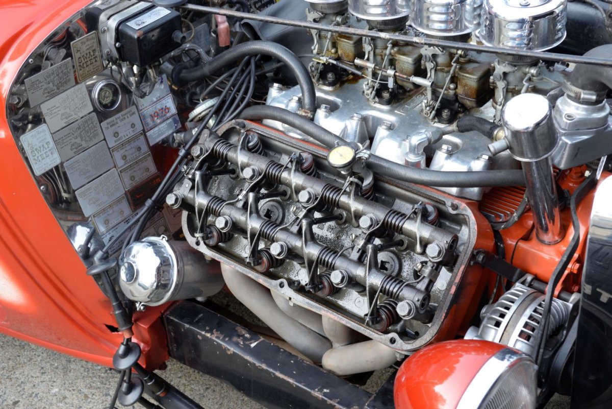

    Milodon made them. we ran them on out AA/FD front engine car in the mid sixties. I put a set on my hemi in '65 and solved the pushrod wear issue. I bought a spare set a couple of year later and had to use one of the springs last fall when one of my original springs broke.
    I've looked off and on for years and never saw any listed anywhere.
    They're a pretty simple arrangement -- springs, chrome-moly rings (to hold the spring onto the outer end of the rocker) and over-the-counter hose clamps.
    All you need is a chunk of 1/2" square stock with a slot in it to install the springs under the chrome-moly rings. Slip the bar in a 1/2" drive extension for leverage and pull the spring down to the tip of the rocker and slip the ring over it.

    Note the missing portion of the spring on #8 intake rocker

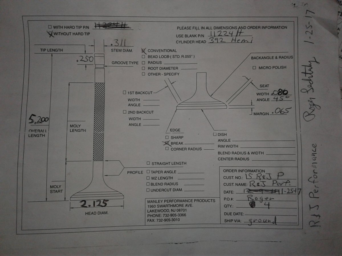

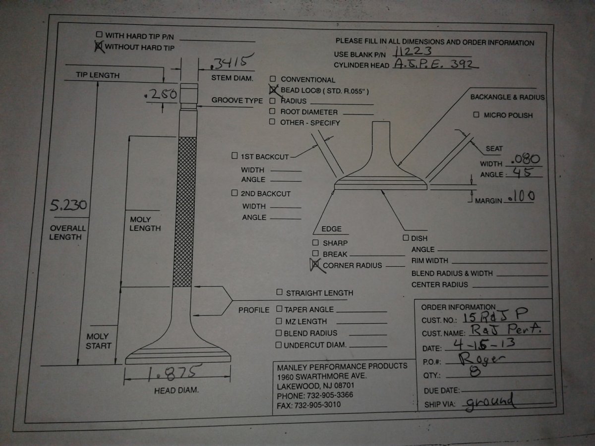

  25. At the risk of pushing a sore topic, I was wondering if anyone has experience with SBC valves in a high block DeSoto. Specifically, I was wondering if anyone has looked at flow using 15* undercut valves or tulip valves in the Hemi heads. Do they help, hinder or just make no difference at all? Looking at little tricks that can be borrowed. Of course, I realize that valve guides would need to be redone to take the 11/32 or 8mm stems.
  26. 73RR
    Joined: Jan 29, 2007
    Posts: 7,342
    73RR
    A valve is a valve is a valve........The only real requirement is that it fits properly. Not too tall, not too short. The stem diameter is a non-issue.
    For length you do have some wiggle room but you must consider all of the operating parameters which then includes the springs (coil bind anyone?) and rockerarm geometry.
    For example, the use of a 'tall' valve in a Hemi usually often causes conflict between the retainer and the underside of the rocker arm so then you need to look at using beehive springs or raising the shaft centerlines of rockers and......
    The valve face is not usually an issue but do not sink the seat into the head as this will screw up air flow. A heavy/deep tulip will add cc's to the chamber.

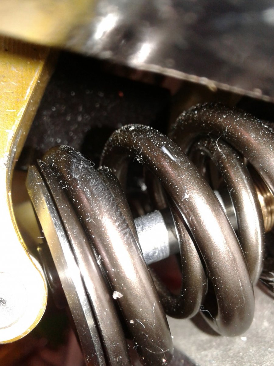

  28. The problem with the early hemi is the short installed height. There is no room under the retainer. Using a cam over 500 lift can create problems. The spring selection is poor. That led to the bandaid helper spring. 20170313_122826.jpg 20170313_122818.jpg 20170612_192559.jpg
    The fix is using .100 longer valves and the proper stands that lift and spread the rocker shafts.
    The last pic shows missle rockers and stands with a two inch installed height. There is plenty of room under the rocker and retainer. The roller wheel is in the center of the valve. The push rods are the correct length with only 1-2 threads showing.
