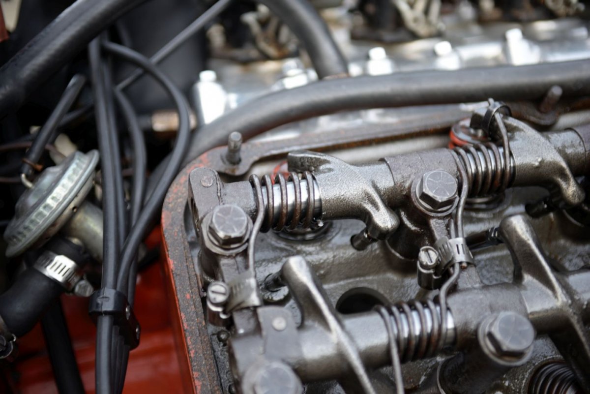

    #8 intake rev kit spring is broken. #6 is still intact.
    The spring lifts the rocker up off the valve stem and tensions the rest of the valve train. The end
    of the #8 intake pushrod was a point sticking up into the rocker arm.
    This happened on the way home from the NSRA Nationals in Louisville in 2015 and I probably threw the ruined end away because it wasn't serviceable anymore.
  26. If you used manton pushrods they could have changed the cup end for six dollars each. The only time i have seen damaged parts it was due to a lack of oil.

    Me too. Lack of oil is exactly why the push rod end gets destroyed. The point worn onto the end of the pushrod when a rev kit spring breaks plugs the squirt hole and the wear process accelerates rapidly.
    In over 50 years the only time I've lost pushrod ends is when a rev kit spring or chrome-moly ring (the ring attaches the spring to the rocker end) breaks and the lash at the pushrod end starts the pushrod wear issue. As long as the rev kit is intact the wear is non existent just as if I were running a hydraulic cam.
    The other "lack of oil" issue occurred when the cover bolt backed out of the new Hot Heads oil pump. That one cost me an engine.
