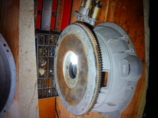

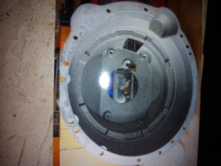

  6. coopsdaddy
    Joined: Mar 7, 2007
    Posts: 884
    coopsdaddy
    from oklahoma
    Heres the pics,i bet its the same guy(richard).

  7. 73RR
    Joined: Jan 29, 2007
    Posts: 7,347
    73RR
    It appears to these old eyes that your bell is designed to be used with an oem starter mounting plate. Many, if not all, of the bellhousing adapters required the 57-58 plate so that the common 12volt starter could be used. The 57-58 starter mounting plate then required the 172 tooth flywheel, so you will need to verify what you have.
  8. TDWZ28
    Joined: Sep 18, 2007
    Posts: 152
    TDWZ28
    from Michigan
    I'm thinking so. Davison Michigan? Small world.
