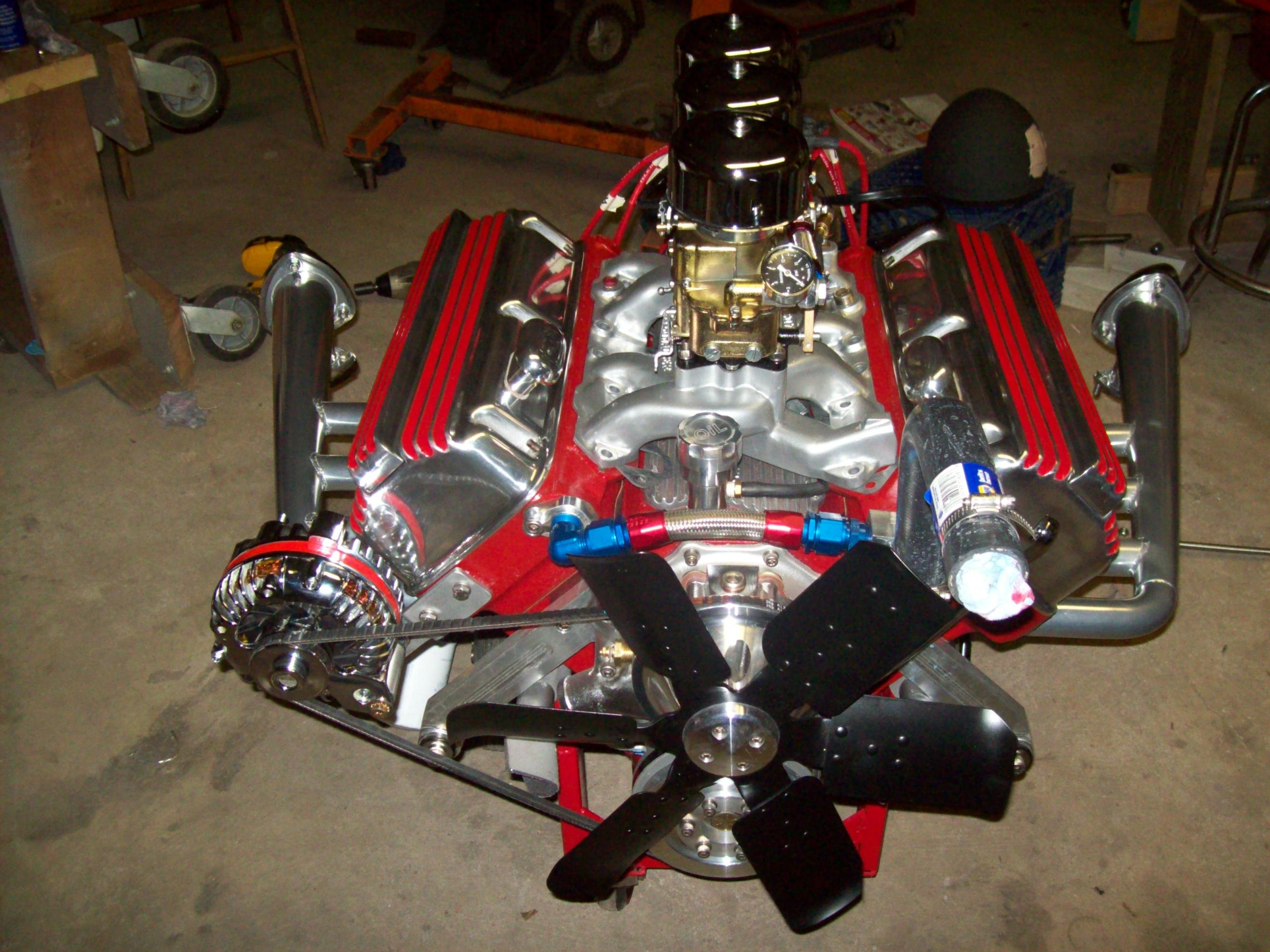

    Bored & Stroked is right. If you like to build engines (as I do ) buy a good core, mag it, and build it new. I just finished my 270 and it was way north of $5000 but I know exactly what I have
  8. Nice looking engine! I'm sure you have closer to $10K in it . . . but then again, you have all the "shiny go fast stuff" that I like :D

  10. Is that an early Mopar alternator? If so, what year and where do you find one?
