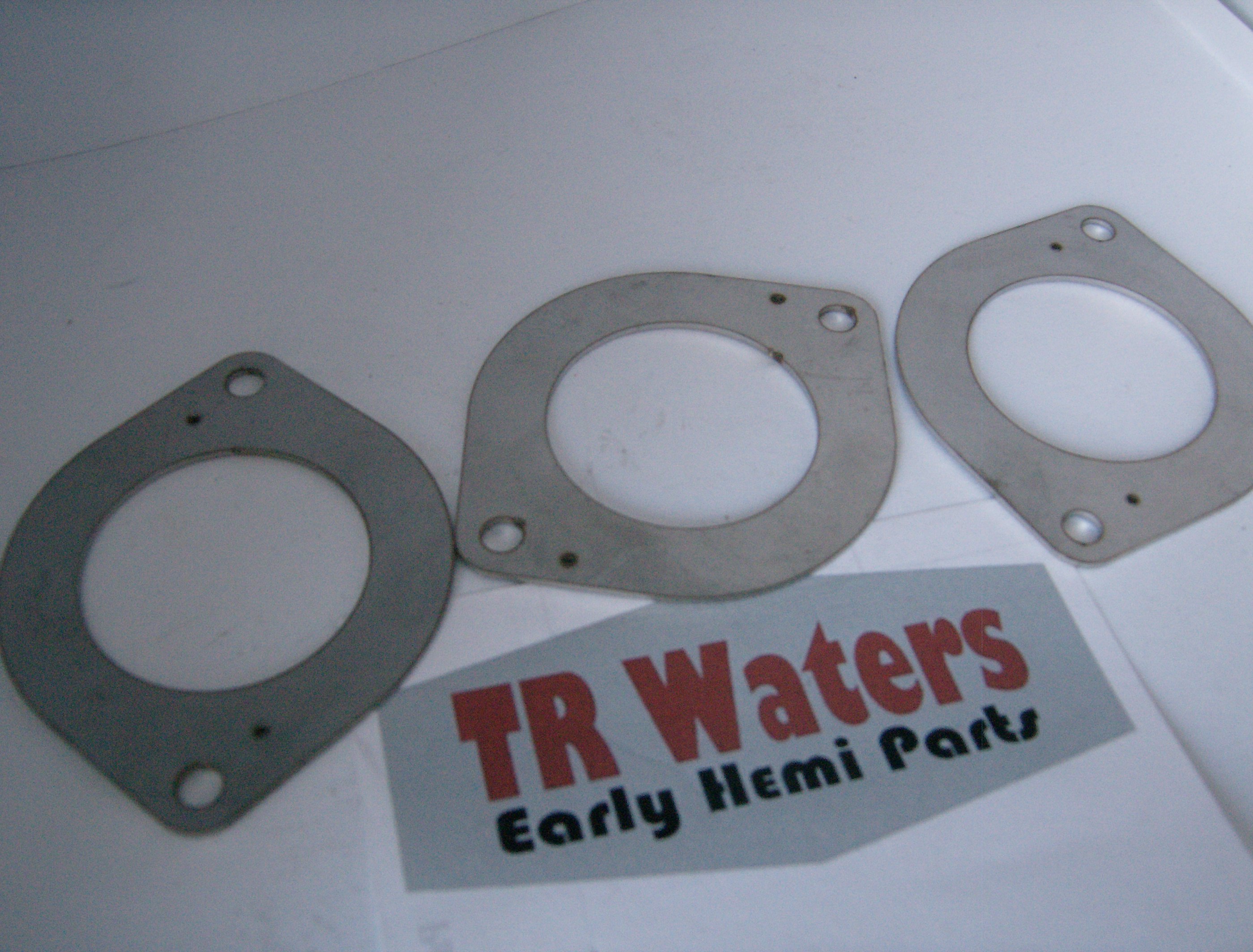

    1. Early Hemi Tech
    The tubes fit quite snug in the Dodge and Desoto heads. The Chryslers do not. It is more of a pain than a problem. I reproduce the early type of lower tube seals which fasten to the head. These use an additional set of the rubber seals as used on the top of the tubes. There are also press in lower seal assemblies from other vendors, most of which require some machining.
    To the OP, are you sure the correct O-rings are in the HH tube seals you are using?
