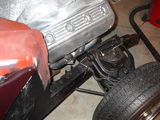

  9. '31 sedan, 315 Dodge
  10. i'ld like to see more pics of this..looks alot like where i have my 315 height wise..still mocking it together...and i am planing , at this point, to also use the side block mounts........

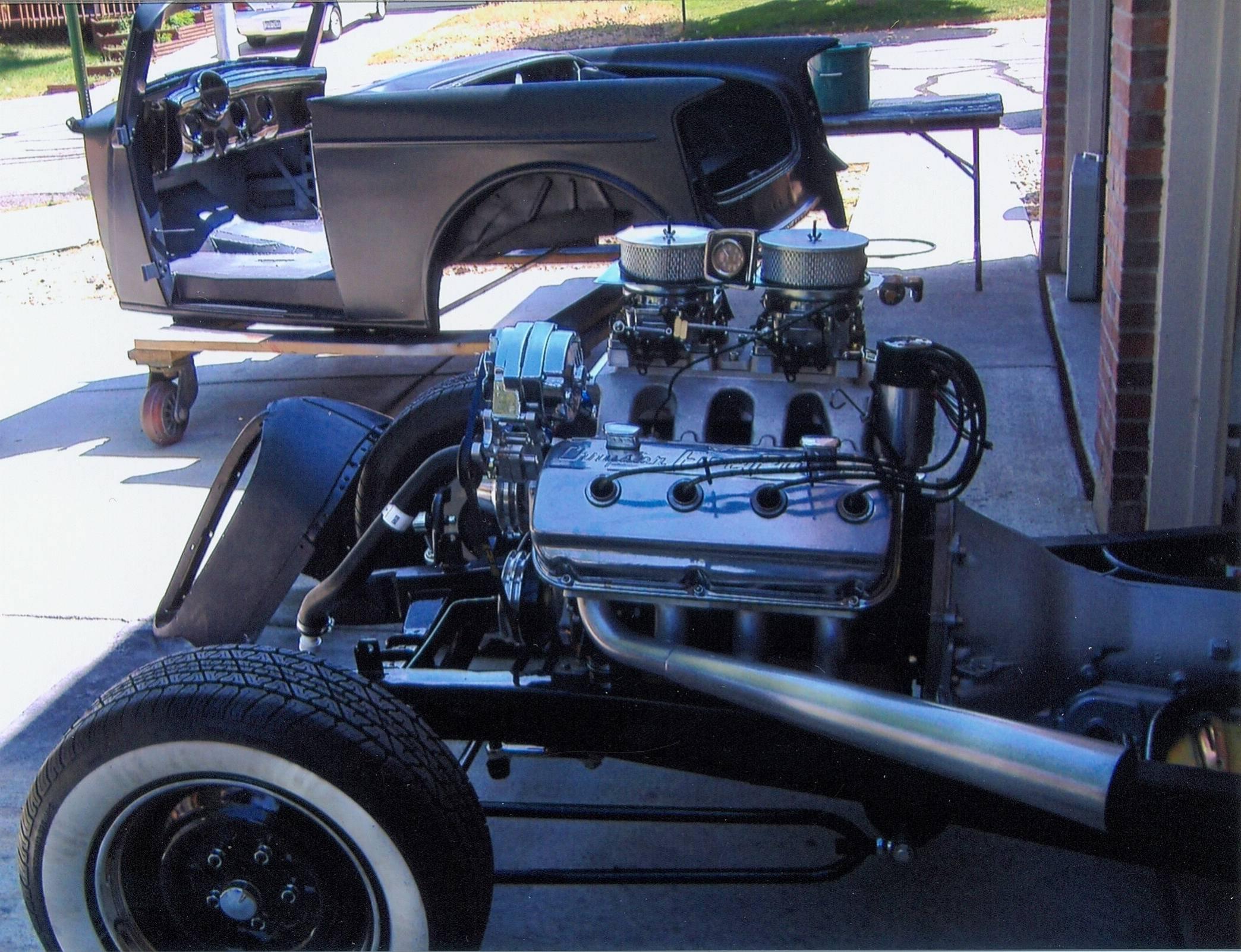

    this what it looks like now / trying to keep this post alive i know there are a lot of HEMI owners out there

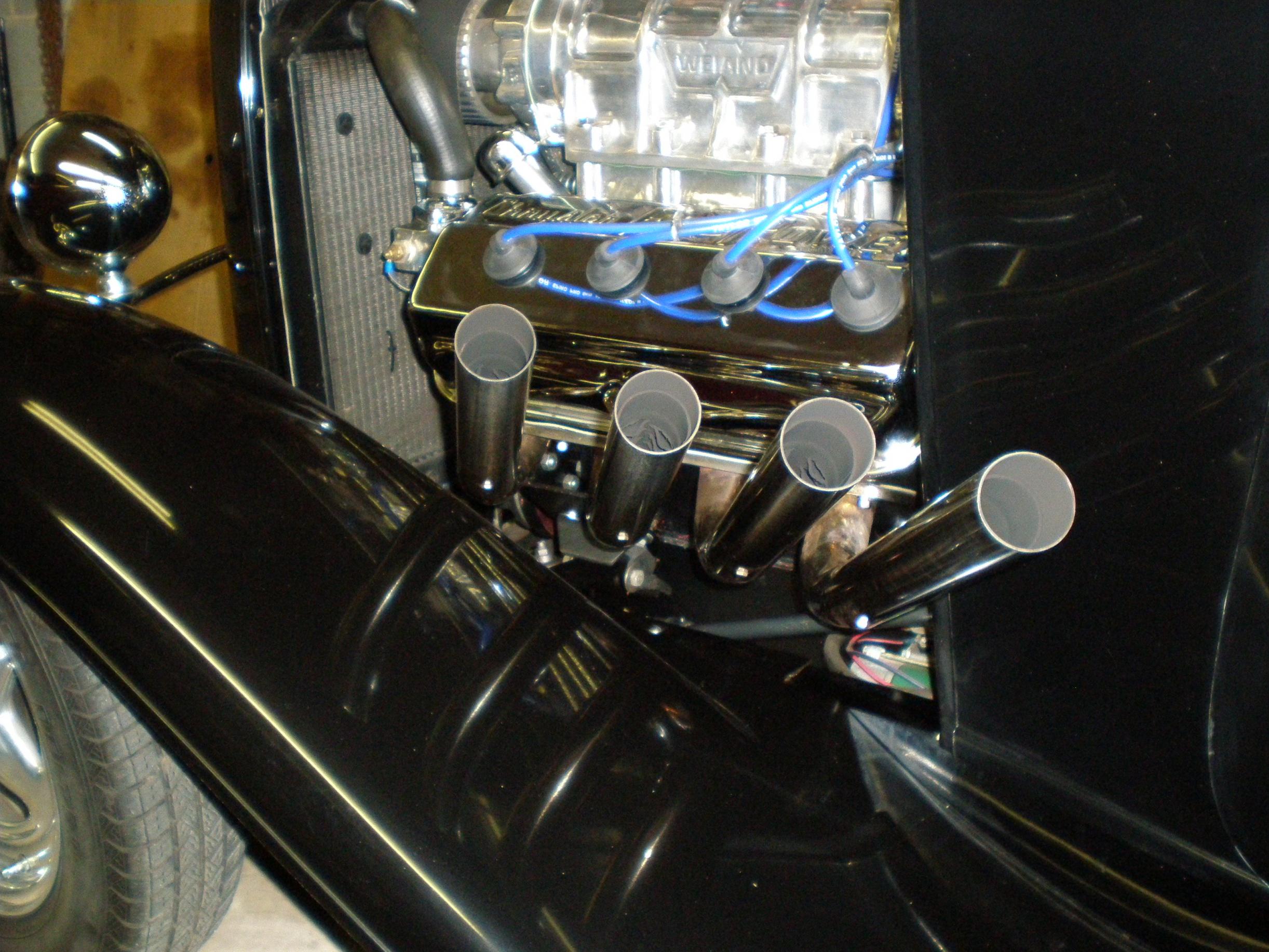

    Here are the stainless zoomies I fabbed for my full fendered 32 ford 3W with a 392.

  21. No Shit!!!!!!!!!!those pipes had to take some time!!!!!!

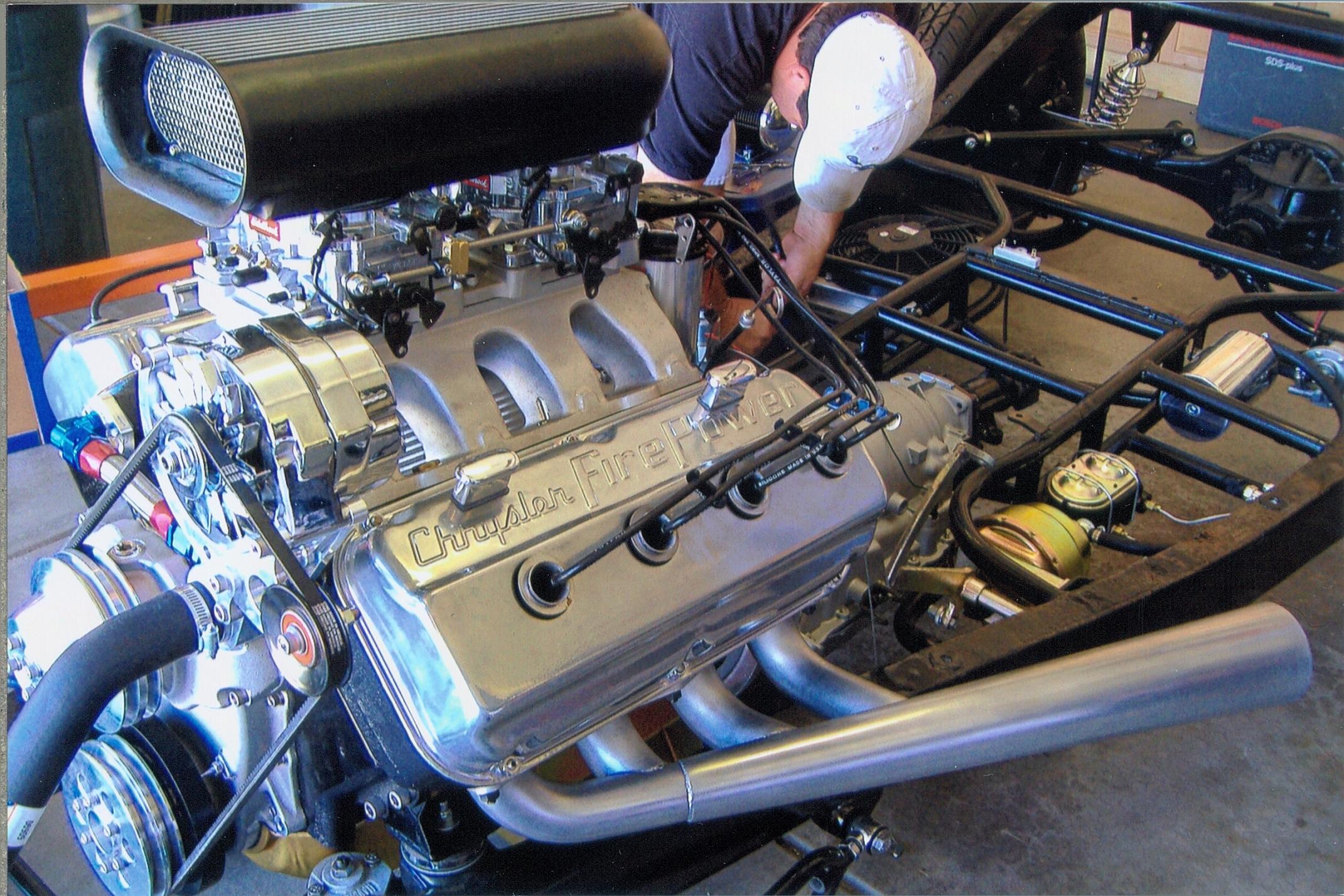

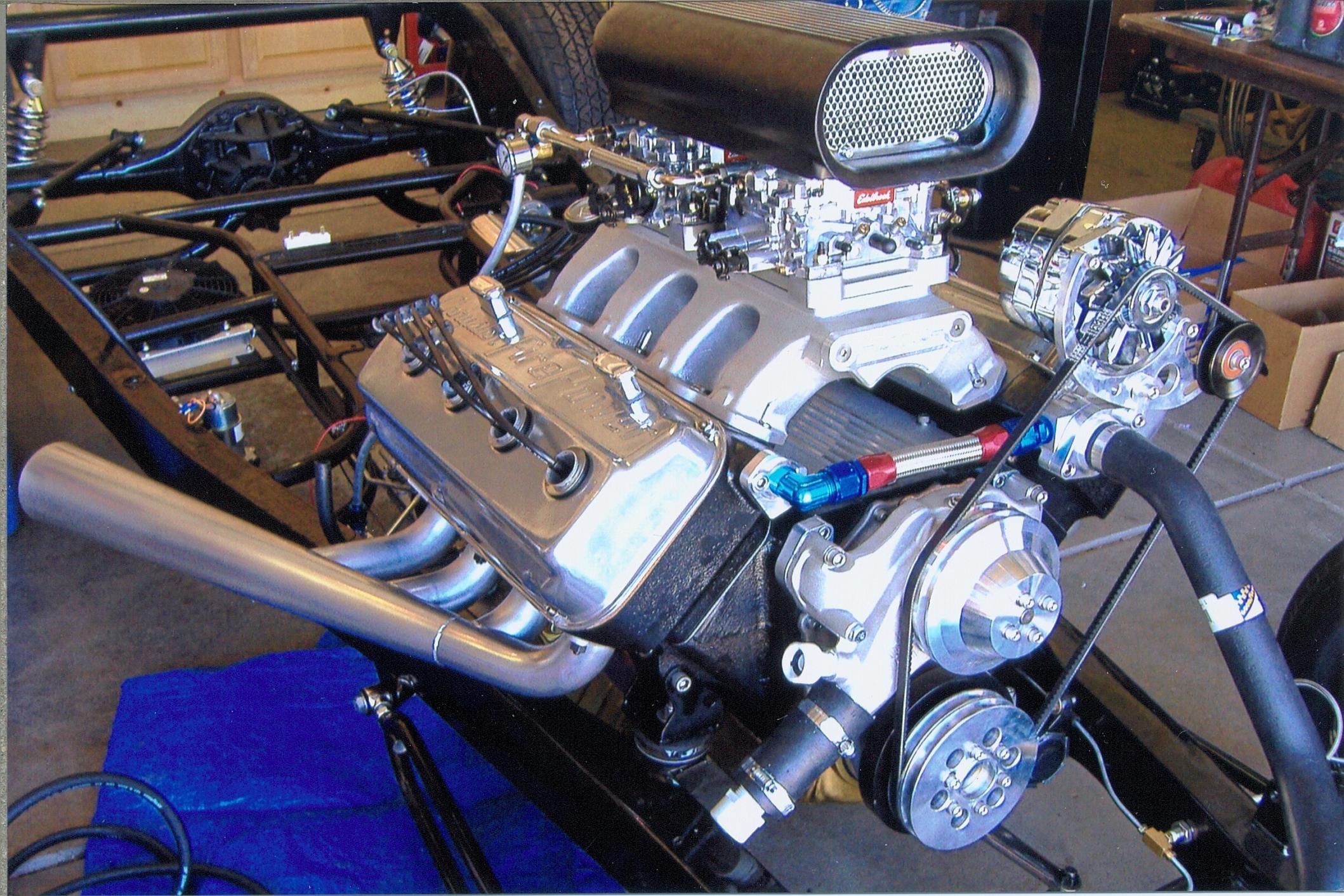

    Here is a local Austin guy's engine and headers. He doesn't do computers so I don't guess he will mind my posting a picture of his car.

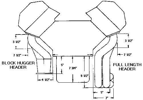

    This is from hotheads for their header dimensions

    Now that's what I'm talkin' about! :cool: :cool: :cool:

    yeah thats great I was wondering about the long tubes for a 392 in a model a frame. it looks like ill have to make a set my self

    Wow. I hate to second guess my self .i made those headers put them on the car was not sure about them and hung them on the wall .maybe I will check them out on the car one more time .thanks:rolleyes:
