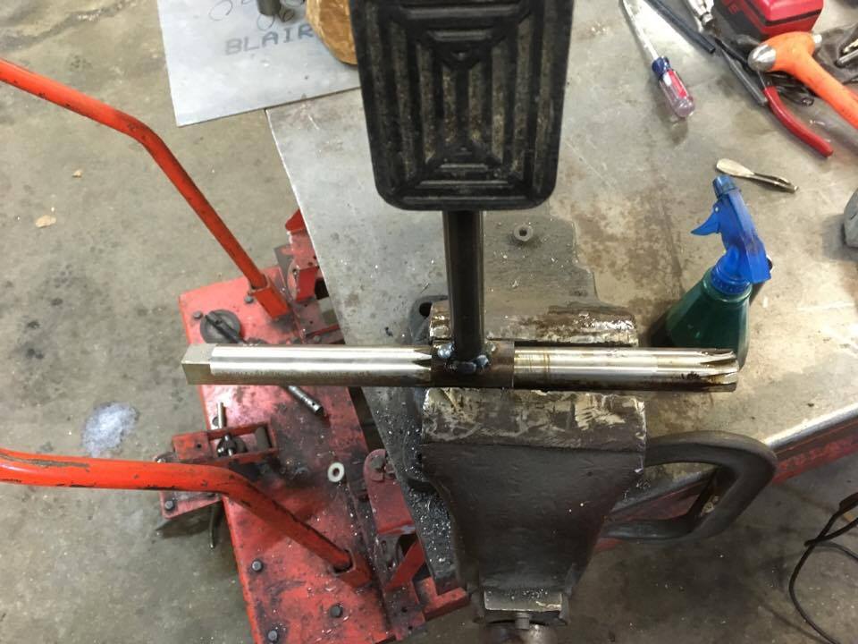

    Uncledirty616
    Did a bunch with the car today. Finished welding the brake pedal then reamed it so it would still slide on the shaft. Then finished up making the linkage for the brake and clutch. 18622850_10209272492273779_15730303_n.jpg 18643820_10209272492953796_1736086384_n.jpg

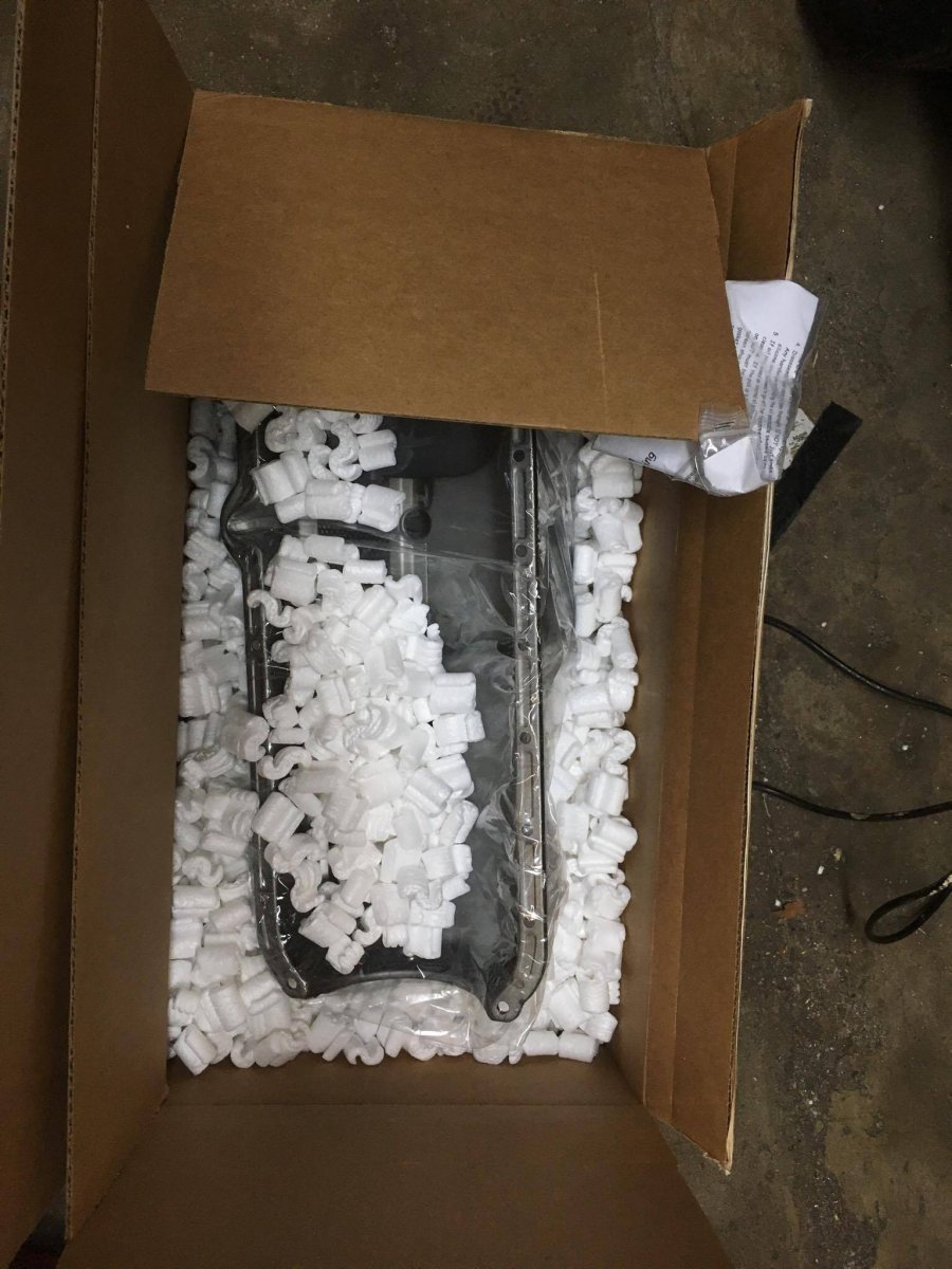

    also picked up my gaskets and hiding in the peanuts is my new oil pan....motor coming soon! =) oil pan peanust.jpg mtf.jpg
