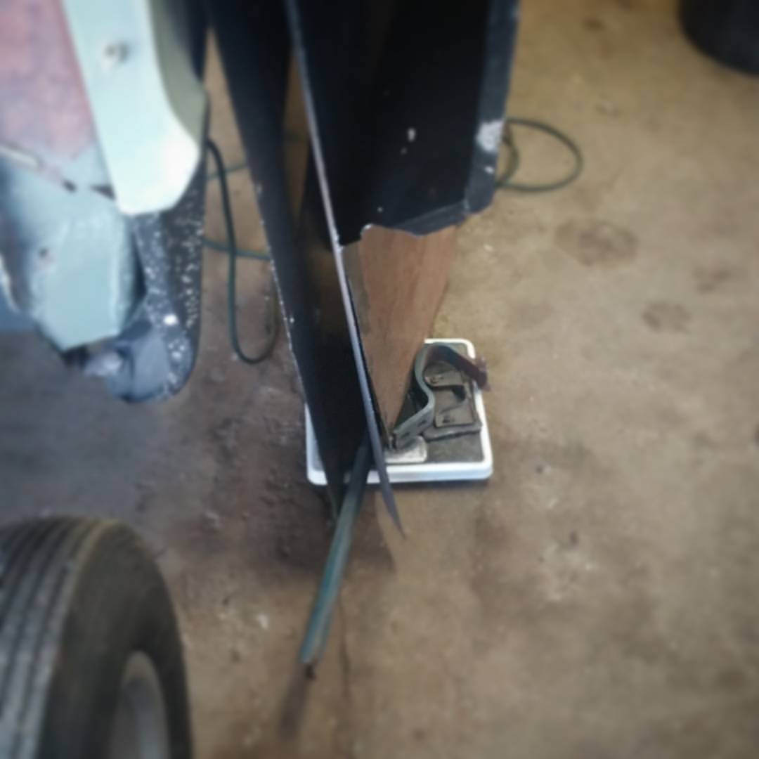

    Cut most of the floor out today. Tried to do it nice and clean so that when i put the aluminum in, it still looks nice. cuttinfloorout.jpg
    Dog_Patch and powrshftr like this.

    decided to throw what i cut out on the scale, with the trunk lid, but not including the firewall. Drumroll, a little over a hundred pounds weightsavin.jpg
    Dog_Patch, 9sectruck and powrshftr like this.

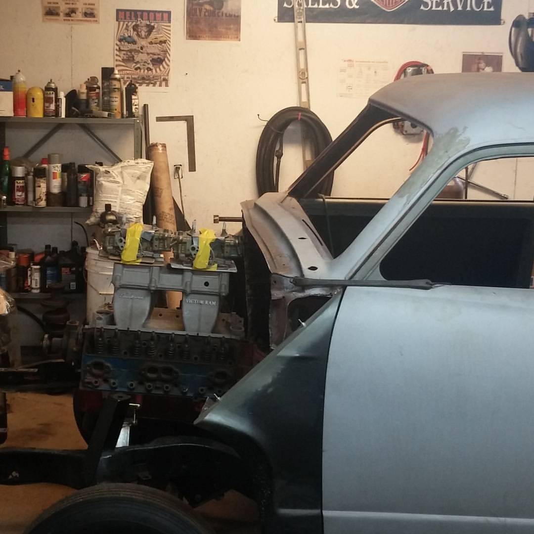

    So of course i had to throw them on the tunnel ram and see what it looks like =D tunnelramside.jpg tunnelramfront.jpg
