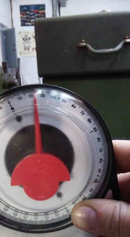

    Double checked the heads tonight. Yep 23 degrees 15310451_10207904985046953_545344186_n.jpg

    What does all this degree stuff mean? Is it the valve face to zero?

    from Missouri
    The temperature in his shop.

    If you lay the head down on so the gasket surface is on a perfectly flat surface and you measure the valve angle, its that angle. Or....It's the temp in my shop...I havent decided
