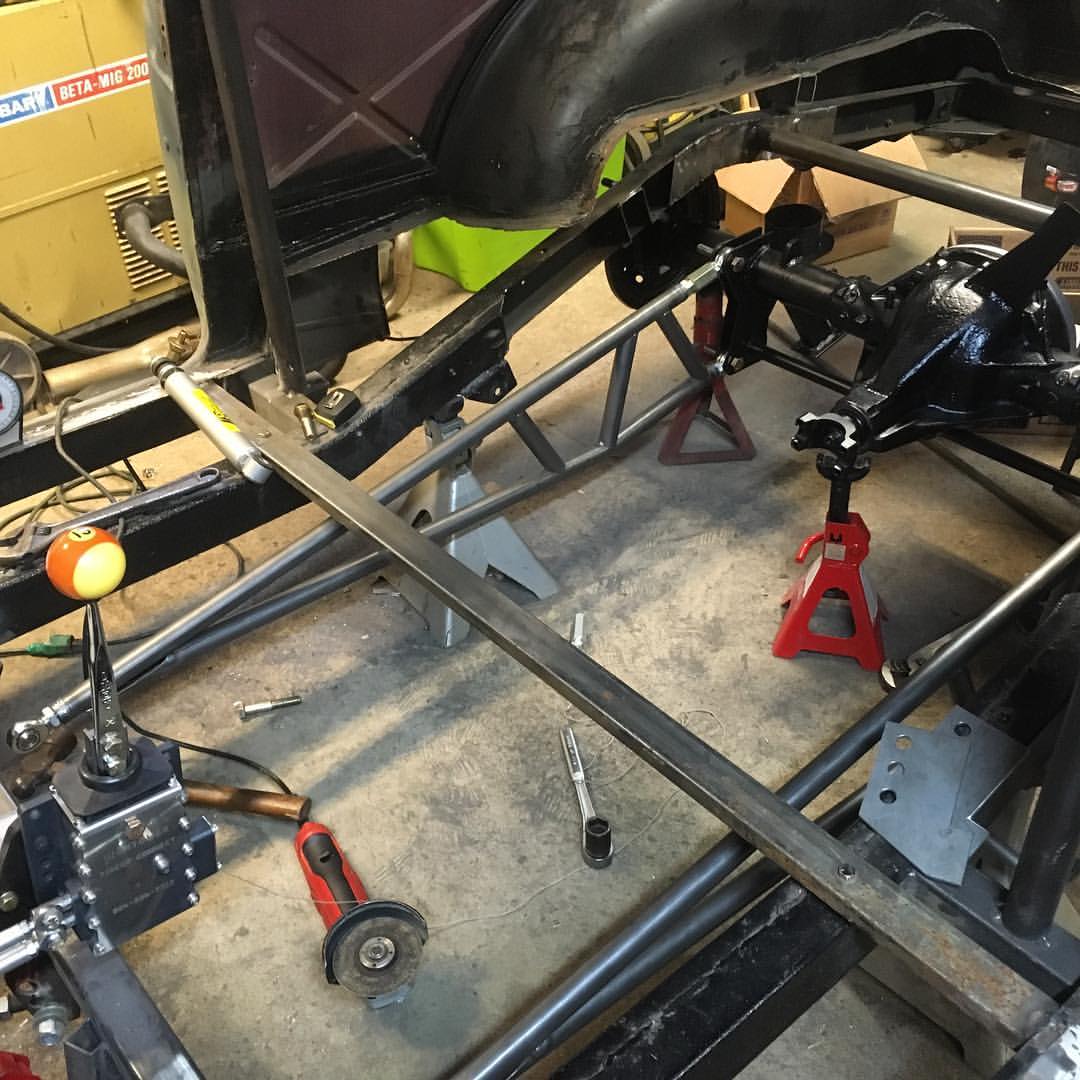

    Got the new ladder bars finished and mounted in the car. Pictures are looking repetative, but i ***ure you there is progress lol wayback.jpg

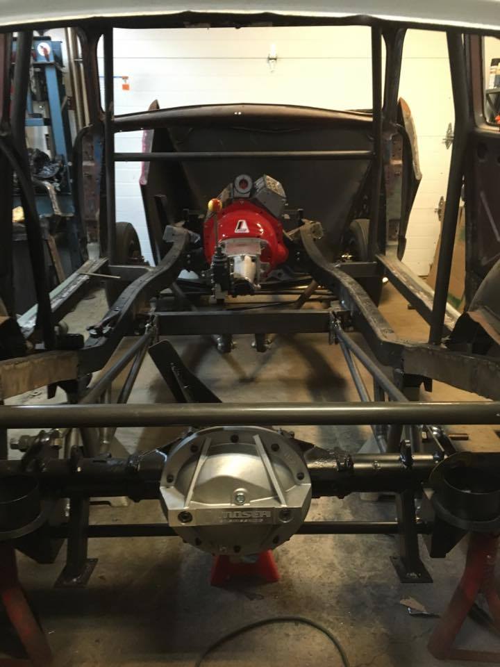

    AND....finally have the rear end in the car, just needs shocks. I know where they are going just waiting on them. Oh, and yes, the panhard bar is NOT level at the moment, car is not at ride height though. =) complets with panhard.jpg complete angle 2.jpg

    What spring rate did you decide on? Also what kind of gap are you leaving for the bump stops and the quarters?

    i have looked and looked and cant find a 110- or 115 spring rate, so i had to go with 125 which was the lightest i could find. as for my gap, i only left 3/8 gap when the bump stops hit.
