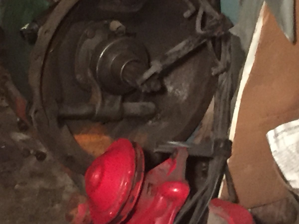

    Hey guys I joined yesterday when I finally picked up my new/old Flathead from a guy in South Jersey. Loaded it up and brought it home. Yanked it out and (weather here in Central Jersey is awesome today) left it carc*** outside. Here are a few pics. Please give me comments and thoughts on how to proceed. I have a Flathead book and have been studying it from cover to cover like a ASE exam. Again I included a few pics for some feedback. If anyone is from IMG_0059.JPG IMG_0060.JPG IMG_0061.JPG IMG_0062.JPG Jersey and wants to help wrench or spread some knowledge the beer is always cold at the shop.

  2. Nice looking old motor. But I don't think it's a flat head. Judging by the colour, it's probably a small block Chevy.
  3. 51504bat
    Joined: May 22, 2010
    Posts: 5,631
    51504bat

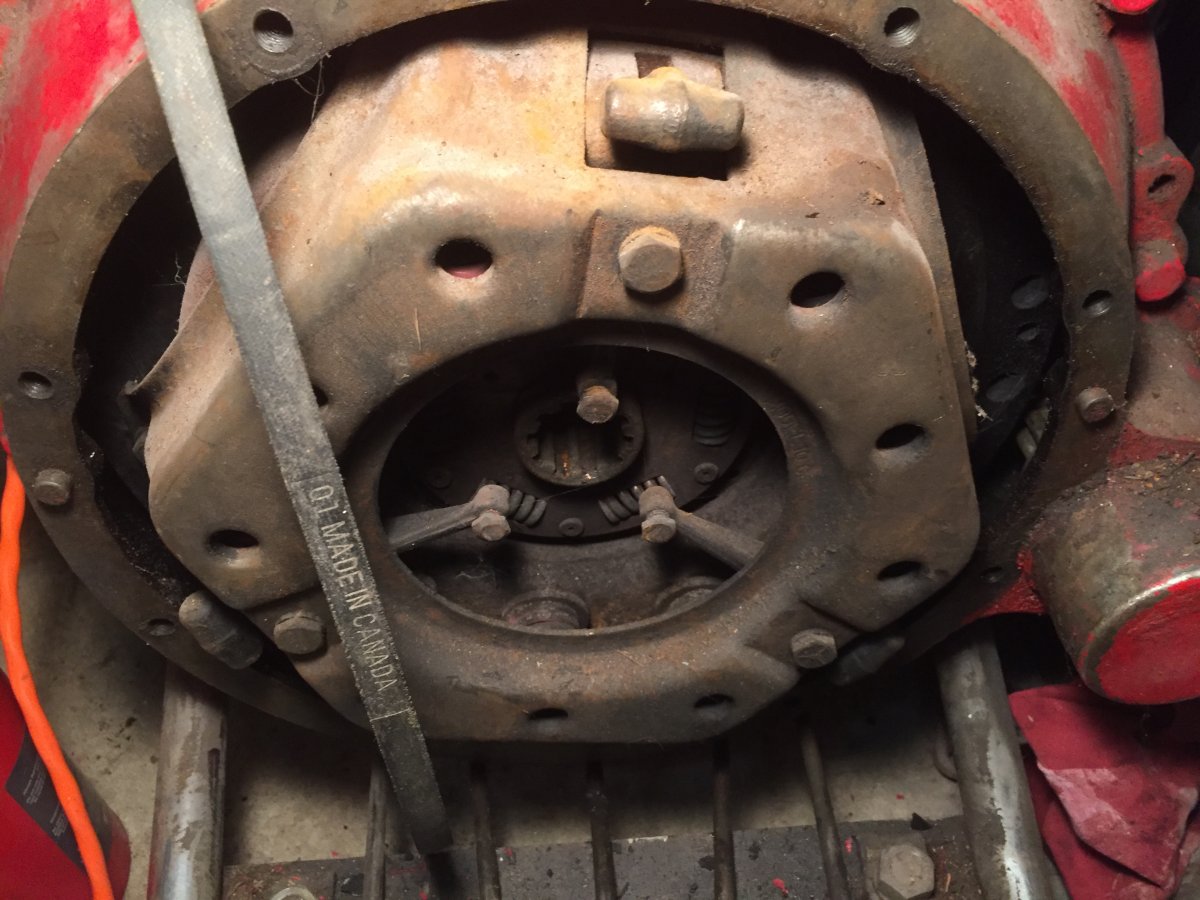

    Based on the water pumps and the 8rt on the heads you most likely have a 48-53 truck engine with an 11 inch clutch. the numbers on the back of the block mean nothing. But, things get changed around over the years. You may get lucky and find a 4 inch crank when you open her up.

    Yeah this was in a truck. What’s the issue? Plan on putting this in a ‘29 coupe.
  6. 51504bat
    Posts: 5,631
    51504bat
    No issue. The 8rt truck heads are the lowest compression of the available stock heads with EAB heads being the most desirable IMO. 8ba heads are in between the 8rt and EAB heads compression wise. You'll need the truck pumps anyway to make the install easier in your '29. What trans are you planning on using? If you run a '39 or earlier top loader you'll need a 1/2 bell housing from either a Merc (stamped steel) or a truck (cast iron). A '40 or later side loader will need a full bell housing. Or there is always the automatic option with an adapter.

    Thanks!!! your the first person to give me some great answers. If I change the heads and go aftermarket I should be able to increase compression? I was planning on a top loader trans but that option is still open. There is a guy in Pennsylvania offering one.

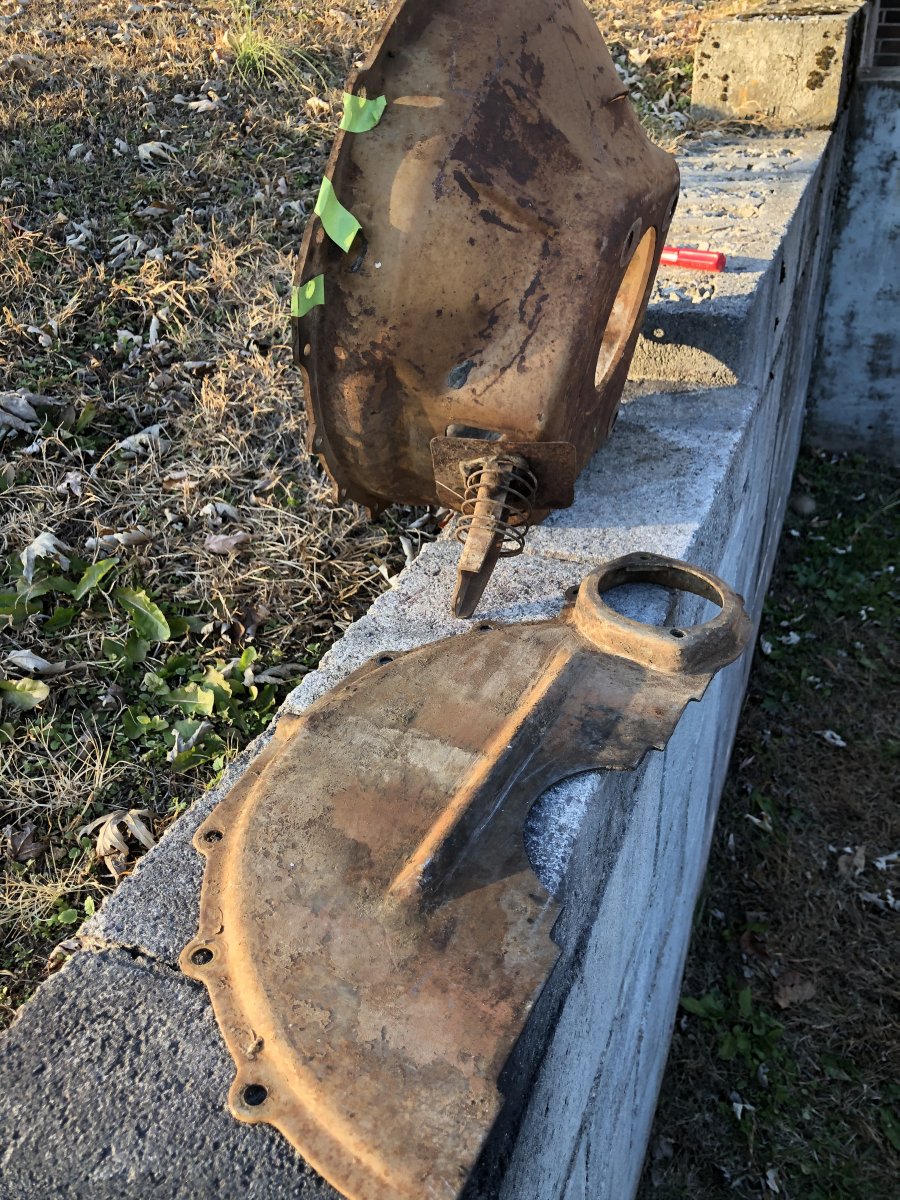

    Not to Hi Jack! but are you guys saying that a complete cast iron bell housing will not accept a '39 transmission?
  15. 51504bat
    Posts: 5,631
    51504bat
    A '39 trans will bolt up to an 8ba with either a cast iron 1/2 bell housing from a truck or a 1/2 stamped steel bell housing from a Merc. Not sure what you mean by a complete cast iron bell housing. IIRC there was a full cast iron bell housing that was used in Mercs for a short time but that used the narrow bolt pattern Ford trans not the '39 and earlier pattern.

    A '39 transmission bolts up to a 59ab block. This one is an 8BA; doesn't have the bell housing that the earlier ones have. The '39 transmission will fit onto an 8BA with a 1949 or 1950 Mercury or truck bell housing, I think. The 1951 Mercury had the small bolt pattern transmission so that bell housing is different.

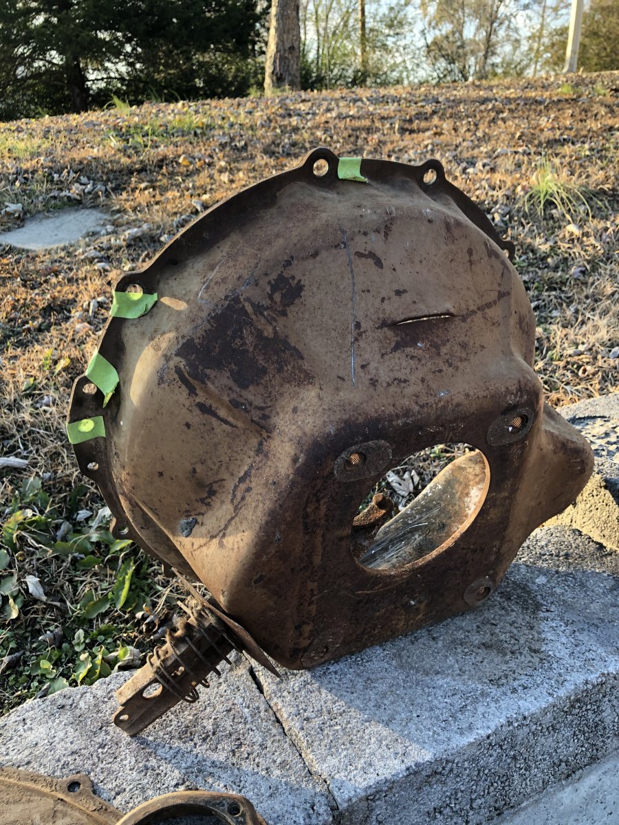

  19. Yeah,,,,here is the bell housing for my 49 Merc,,,,,it takes the narrow pattern ******.

    So these two don’t to get to be married? I actually haven’t tried a conjugal mating yet... 2CFFEB93-8CFB-478F-A9D1-1A426801C47A.jpeg

  25. Hnstray
    Joined: Aug 23, 2009
    Posts: 12,357
    Hnstray
    from Quincy, IL
    Early model year 1951 models used the same transmission design as the ‘49/‘50 Mercs.
    Mid-year’51 Mercury switched to the ‘49/‘64 Ford small bolt pattern transmission. That particular bell housing is a half year only item as the clutch throw out shaft design was same as prior models. In ‘52 Mercury adopted the lever arm that Ford introduced in ‘49 and shared the bell housing design with Ford.
    I am pretty sure that bell housing is not a ‘49 Merc item. It is either a ‘49/‘53 Ford bell housing or a ‘52/‘53 Mercury item......see comments immediately above your quoted post.

    Don't forget the bottom plate which the starter bolts to on the 8BA type of bell housing - if what you look at doesn't have it - you need to source one. That's on all the 8BA bell housings - they need the corresponding starter plate.

  28. Oh yes sir,,,
    I have the starter plate,,,it matches the bellhousing.
    Tommy

    From what I can see, that transmission fits that motor.
  30. J'st Wandering
    Joined: Jan 28, 2004
    Posts: 1,772
    J'st Wandering
    Another note to note. Six cylinder's had a pressed steel bell housing but is different. As I remember, the face where the transmission bolts on is angled or something like that.
