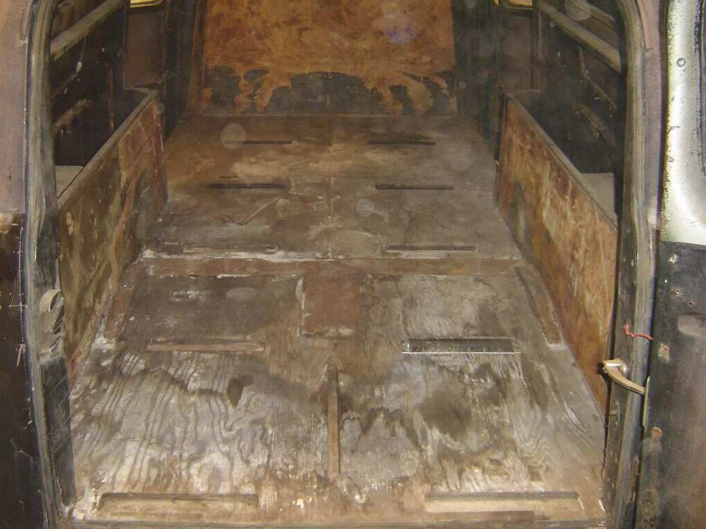

    Not gonna chop it....but I will lower it about 4 inches on each end.
    I dunno much about the history of the car. There WAS a lot of dirt and some gr*** stuck into the frame. I was kinda leaning towards it may have been bashed around a farmers field without an exhaust on it as there was only a couple of feet of pipe off the manifold. That may have burnt a few valves.
    One thing for sure..I'll be looking for a new ring and pinion of a much lower ratio....4:1 to 1 doesn't give me much milage. Either a replacement ring and pinion or a whole axle with something like a 3:08 or a 2:73 in it.
    The interior was gutted. Everything is there, just laying on the floor is all. I'll keep it to use as templates for the new interior when I can reload the money-gun.
    P***enger floor done...doing drivers side.
    Back emptied...
    When I bought it....
