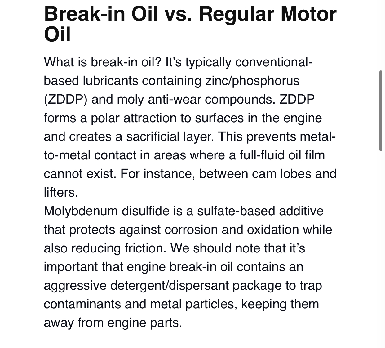

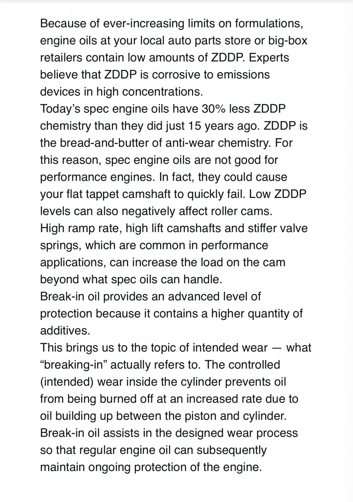

  21. loveoftiki
    Joined: Nov 11, 2006
    Posts: 9,179
    loveoftiki
    from Livonia,Mi
    I just like to make things simple…if a cam manufacturer tells me it’s what they recommend to break in their product, I’ll take their advice..all the good stuffs in it…
    8CB18A95-0052-4A7B-A570-63A491FD3E3C.jpeg D808946F-13E9-4D7B-98C3-F24C731A194E.jpeg
    So I would think second best option would be use a high quality motor oil and get some ZDDP and add it in prior to break in…
    And if Rotella floats your boat with some break in lube added to it…have at it
    Last motor a friend built used some off the shelf oil, fired it up, ran it for 20 minutes and called it good…
    lots of ways to skin a cat I guess…
    Stock Racer and Bob Lowry like this.

  23. Blues4U
    Joined: Oct 1, 2015
    Posts: 8,185
    Blues4U
    from So Cal
    OK, not trying to pick on you, but really you just posted marketing copy from somebody that is partially correct. If I was a social media fact checker I would slather some kind of "Missing Context" or "Partially True" banner on it. It's a simplified explanation intended for a non-technical consumer, but it's also marketing copy intended to sell a product.
