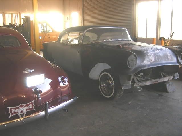

    i started out with this, everything is there, including new chrome bumpers. The fist thing i did was to pick up this set of wheels and tires for 200 bucks
    removed the front end, removed the engine and trans for inspection.

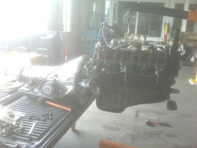

    now the trans and engine was mated, and ready to put in for mockup

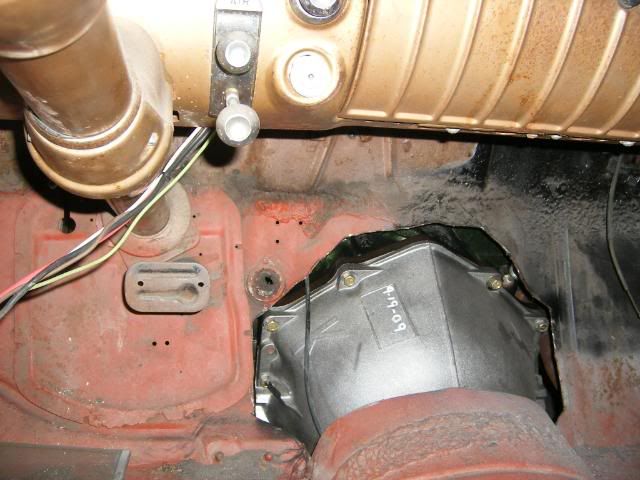

    had to cut the trans tunnel for the 700 to fit, it will get covered later.

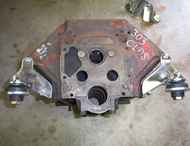

    since i had no more side mounts, i had to come up with new ones. so i got the idea from these pictures here on the hamb.
    and made these , they are not the best fabrication you have seen, but i think they will work, as they are not taking any weight, just stabilizing the engine. i kept my stock mount to take all the engine weight.
    back side
    and then i had to make the new trans mount.

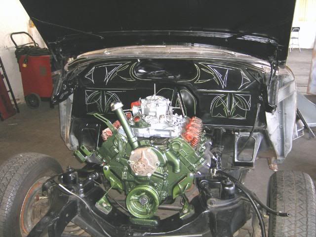

    painted the firewall(hotrod flats) had my friend pinstripe it and put in the engine for good
    and lastly this is where im at right now, hopefully it will fire up soon.

    Looking good!!! Question though. What did you do for the cowl drain?

    cisco 88 - that cowl drain...... ****, i went all crazy on the firewall and
    overlooked it. now i gotta think of something, thanks for bringing it
    up though.

    Just asking if you retained the center support engine/trans mounts or if you are only using front engine and rear trans mounts.

    rockabillyrodder - i removed the trans crossmember , and for mounts im using
    front stock mount, trans center mount, and 2 side monts at
    front of engine
