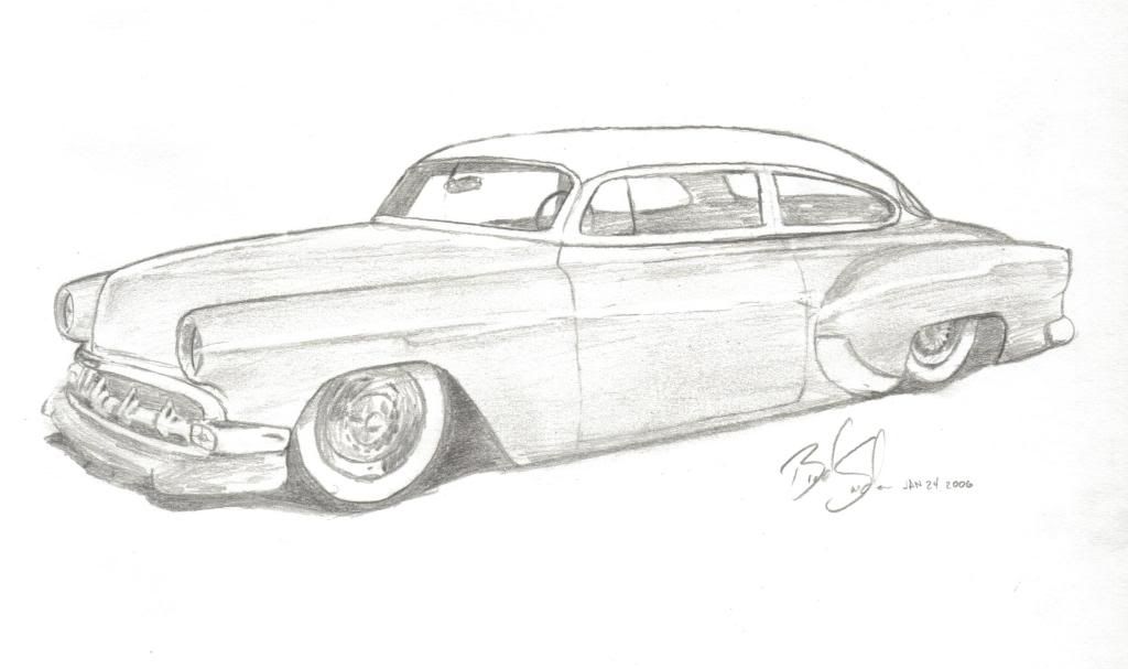

  23. I hope this counts ;)
    My dream '54, chopped and sectioned :)
    The plan for my 51 more door
  24. gimpyshotrods
    Joined: May 20, 2009
    Posts: 24,370
    gimpyshotrods
    Looks pretty good! How well is that 6 running now?
