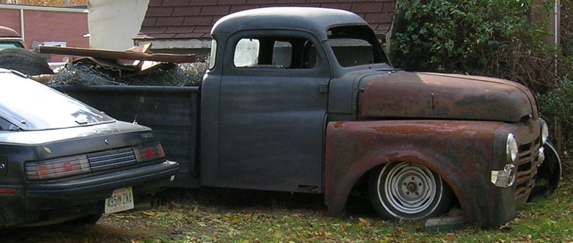

    They look darn good Chopped and Dropped too.
    Saw this one in NE Kansas years ago

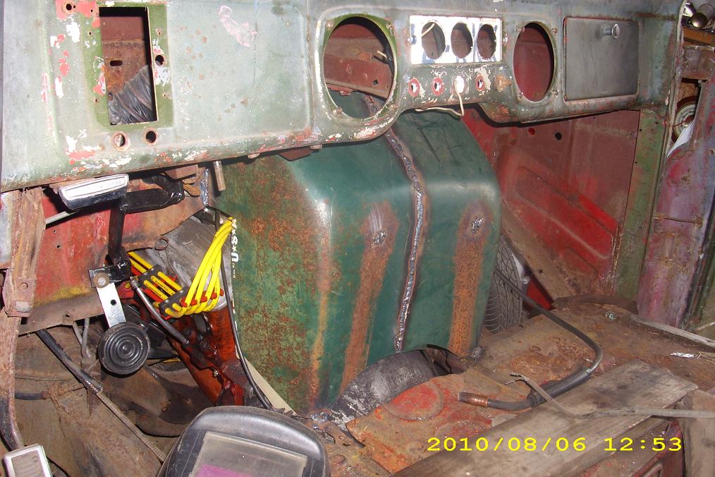

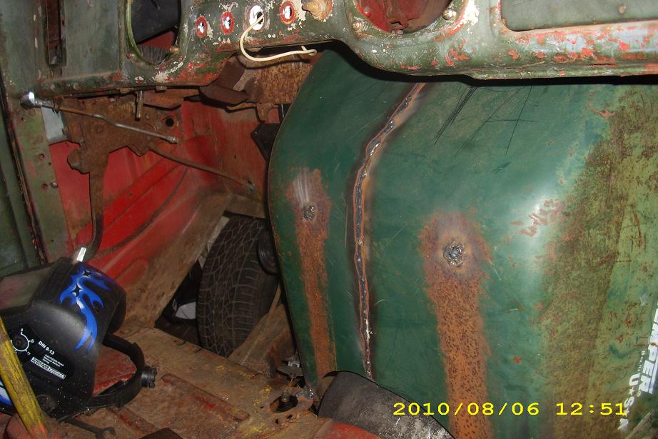

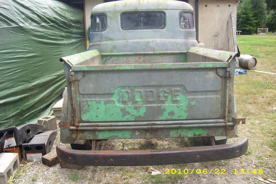

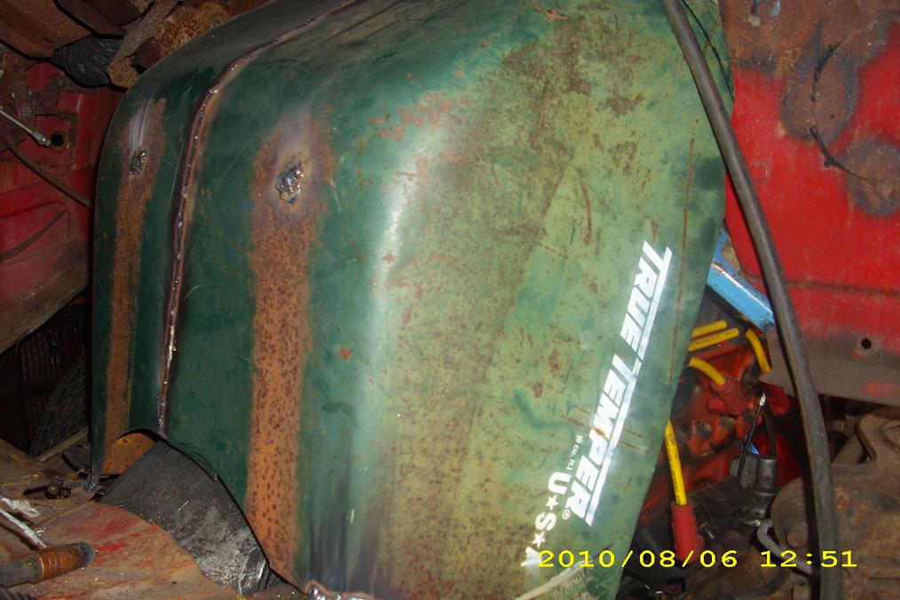

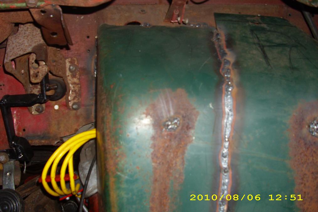

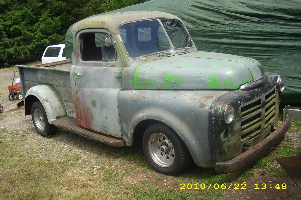

    mine is a 1948 that me and my son started in the late 90's.
    he passed away 8 years ago at age 16 and l was so grief stricken l did not touch it till 2010 . figured it was time to finish it or sell it to someone who would, so l choose to finish it.
    l used all chevy power train, 300 hp 1967 327, 1981 2OOR, 1973 camaro 3:36 12 bolt posi, 1977 nova sub-frame, 5 window cab/no chop, 1966 chevelle manual steering box , 1972 chevelle tilt coloulm and a B&M shifter.
    when l sub-framed it, the motor was hitting the firewall, we used a wheel barrow to recess the area for clearence around the back of the block . l also used 1966 chevelle motor mounts and this lowered the engine 2'' and moved it back 6''.
    you nailed the stance. really like your'e truck,
