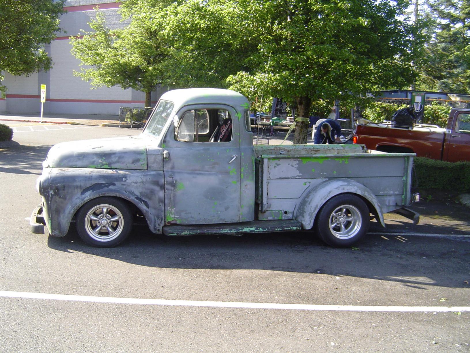

    i absolutly love this truck. i'm building a 51 fargo. putting it on a 93 dakota chassis with a 5.2 magnum EFI. Im in the process of mounting the sheet metal on the dakota frame. can you tell me how far up the rear of the cab sits off your frame? Also i'm leveling the door sill rocker with the bottom of the frame to level the cab. is this correct?

    my 48 had the cab looking way off till l raised the rear of the cab, now everything lines up. was really fighting the way front fenders lined with the doors. there was a big gap just sitting level. it sat funny till l figured out l had to adjust it this way.

    I have the cab as close as i can to weld on the mounts. i figure its easy enough to adjust or shim later. as for where my cab sits its about an inch off the frame in the rear and as i said level with the bottom of the dak frame. i have the front clip on and the rad support sits centered between the frame rails. without the doors on its tough to judge up or down but i think i got it damn close. wheels are centered dead on.
