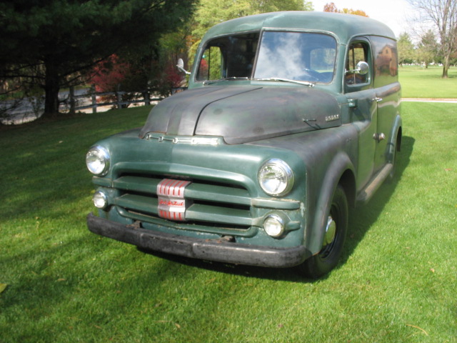

    I told my son I needed a winter project and he suggested I put a new engine/trans, rear end in Herman (http://www.jalopyjournal.com/forum/showthread.php?t=635618). He has put 7000 miles on Herman since he bought it from me and is still running around Columbus, Ohio with all original engine, trans, brakes and TIRES!! Yikes on the tires and brakes!
    This wont be my first hot rod motor installation but will be my first Mopar truck to transform. I already have the .060 over 283 built and the 5 speed bought and know what rear end I need. All of that including the re-wiring will be relatively simple for me. But here is what I need help with. What do I do with the front brakes? Leaving them stock is not an option as they are problematic now. An axle change would also be desirable as Herman has the reverse rake with the front higher than the rear of the truck. Neither my son nor I want to put Mustang II or any other independent front under the truck.And if possible we would like to leave the stock steering box/column so we can retain a stock appearance on the inside. I know he found a place to have the stock front axle dropped but we have no idea on what spindles etc can be installed to update the front brakes. I would prefer to end up with disc brakes on the front. Someone has no doubt solved this problem already, I just need to be educated as winter will be here soon (sorry!) Thanks for any help with this! C-dog

    man, that thing is ugly cool...:)
