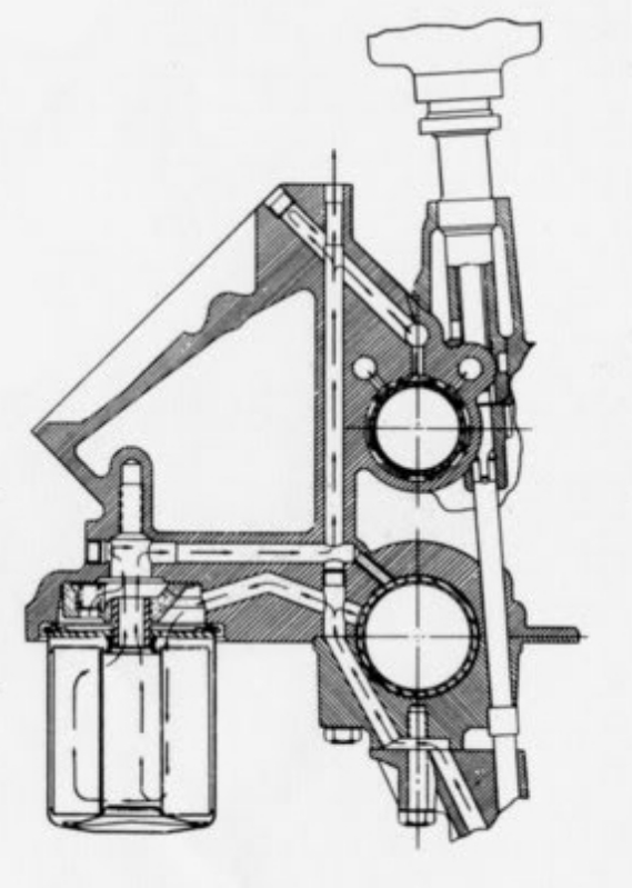

    Just as an aside, I am not a big fan of factory, m***-production lubrication systems. Too many turbulence generators where oil galleries intersect. Chrysler hi-performance engineers advised their engine builders to modify their oil routings in the LA blocks to prevent oil starvation to #4 main and its #6 and #7 rod bearings. Ford did something interesting on their 427 side oilers: the oil pump had a pressure relief valve but there was also a pressure relief valve at the end of the main gallery of a lower value, guaranteeing sufficient lubrication to all the crank bearings. As for SBC oiling, that 135 degree dog leg gallery at the rear of the block is just so engineering wrong, along with that convoluted route to the mains via the annular grooves around the cam bearings. Why else would Dart build and market priority main oiling SBC blocks?
    falcongeorge likes this.
