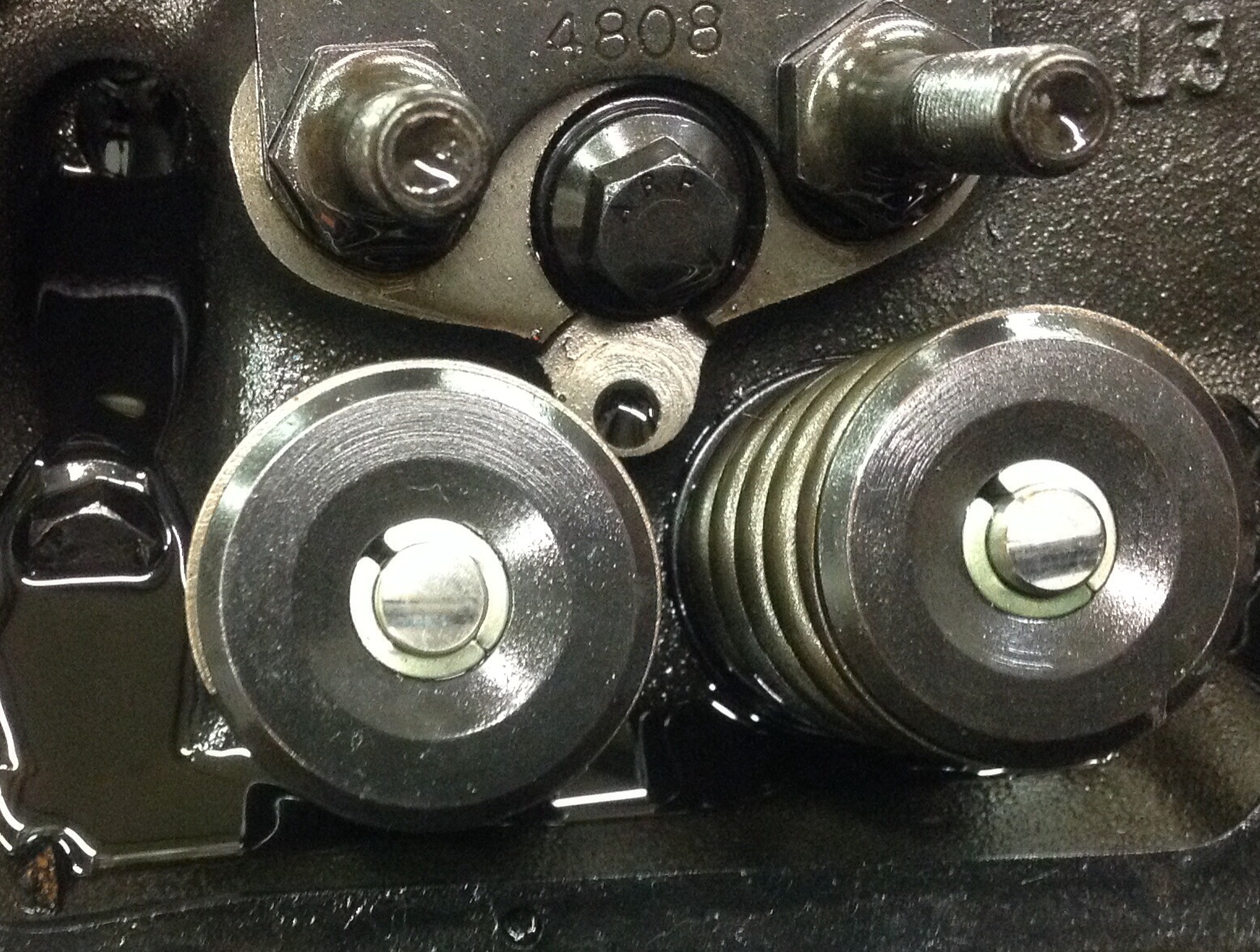

  2. With a drill running the pump with modified dizzy and starter spinning engine - # 1 and #2 get oil up top before 7&8 but 7&8 oil more. Weird

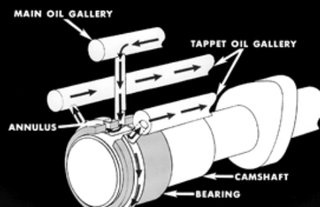

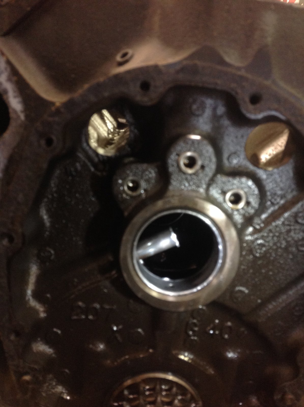

    The wide rear cam bearing with 2 holes was used from 1955 to 1963. When using these year blocks it is easy enough to just modify the block instead of the camshaft.

    You stated the drivers side rockers have plenty of oil and it is only the drivers side that has oil problems.
    I would also check the distributor for a drilled hole in the part that connects the lifter galley together. I've seen people drill a 1/16 hole to oil the bottom distributor bushing, and then I've seen someone that drilled a much larger hole that basically let the oil byp*** back to the oil pan.
  5. Who said that ?
    Extreamly low oil and equal both side
    P***enger side valvetrain is noisy but only when at operating temp.
    #8 intake has a pushrod rotational problem.

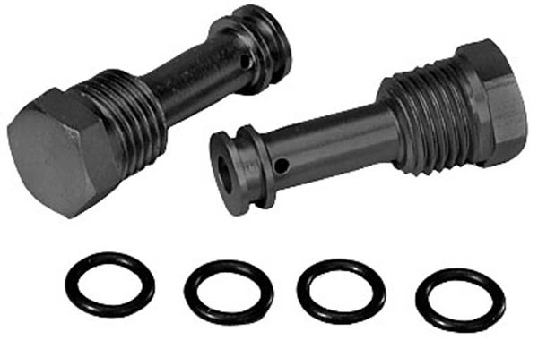

    Left side doesn't clatter? Use ZDDP in oil? Running oil pressure when cold? Pressure when warm? Where is pressure being taken from? Front above timing cover if the plug is there is the best spot, second is next to distributor, and the worst place to take it is just above the oil filter housing.
    What are the spring pressures? Too high they can collapse a lifter and eat the face of the lifter and the lobe of the cam. Is there enough room from coil binding the spring?
    A problem I've also seen before is are the lifters correct for a SBC? Sometimes if using another GM lifter for say a Buick, Pontiac, or Oldsmobile the recess for oil flow that connects the galley together can be in the wrong spot which when at max lift can uncover the galley letting oil escape, this can be checked with distributor out and turning engine over by hand and looking at the lifter in the bore.
    Does the engine look like it was ***embled with White Lithium Grease? This grease can ac***ulate and block off oil flow in al sorts of places.
    Have you looked to see if the above pictured oil restrictors are in, these are notorious for being bad on hydraulic lifters, some people use the older style restrictors that are under the rear cam bearing in the 2 lifter galley holes, the holes would be tapped and set screw with hole installed, kind of like what is done for the Ford 351C.

    funny, I thought about this early on, but thought " naw, no one would be stupid enough to do THAT". Be pretty funny if that's what it turns out to be, it meets all the symptoms...

    On July 14 I mention oil restrictors.

    Yeah I've seen this on more than one occasion, and yeah people can be that stupid. We once had a guy trying to build up oil pressure in a SBC race engine by turning the engine over with the starter. They were down in the garage and we were up in the shop and it was taking quite a while to build up pressure. Turns out they forgot to install the distributor, and these were guys that had been around the race car block a few times.

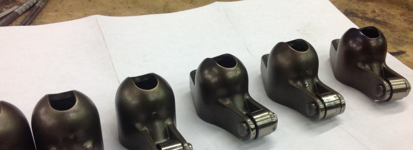

    I also think the rockers should be looked at being they are roller tip rockers. The balls might now be burnt with so little oil going to them.

  26. Few rockers with extra heat treating- ;)
    Progressing left to right more heat till its all blue on the right.
    These are PWR rockers.
    Most Every roller tip is shot now.
    Geometry off & Push rods too long - 8.100
    Beehive springs would have been a better choice here.
    More coming later
