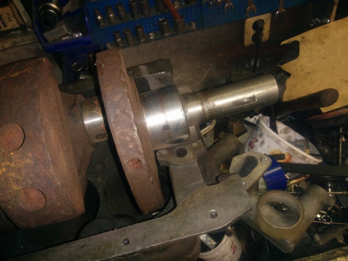

  14. Magnus B
    Joined: Jun 19, 2005
    Posts: 887
    Magnus B
    Hello
    I have been wanting to do th exact same thing. I have some pics (sorry about the mess) of a Mercury crank in Model B blokck. It's just a junk block so I machined the rear and middle bearing journal to make the crank go in. no precision work at all. And as you might see I did nothing to the bore of the journals. But it does fit and the rod journals are not that far of from the cylinders centerlines. It was a long time ago but as I remember cyllinder 2 and 3 a pretty much spot on and 1 and 4 are maybe 1/4" of. I was going to use Pontiac 1936-37 six cylinder connecting rods with a 2" journal and using a Merc crank and offset grinding it would give me a stroke of 4.125" which would be just correct since those rods are a bit longer than Model A/B rods. Using model B rods I think you could get a 4.25" stroke. Of course I don't know if it would work to grind the crank that much but that's another question.
    Great to see the build on the Fordbarn. Offsetting the mains bolts and making a block to use hydraulic lifters are other things I have been thinking about.
    //Magnus
  15. RichFox
    Joined: Dec 3, 2006
    Posts: 10,020
    RichFox
    Looks a lot better than I imagined.
