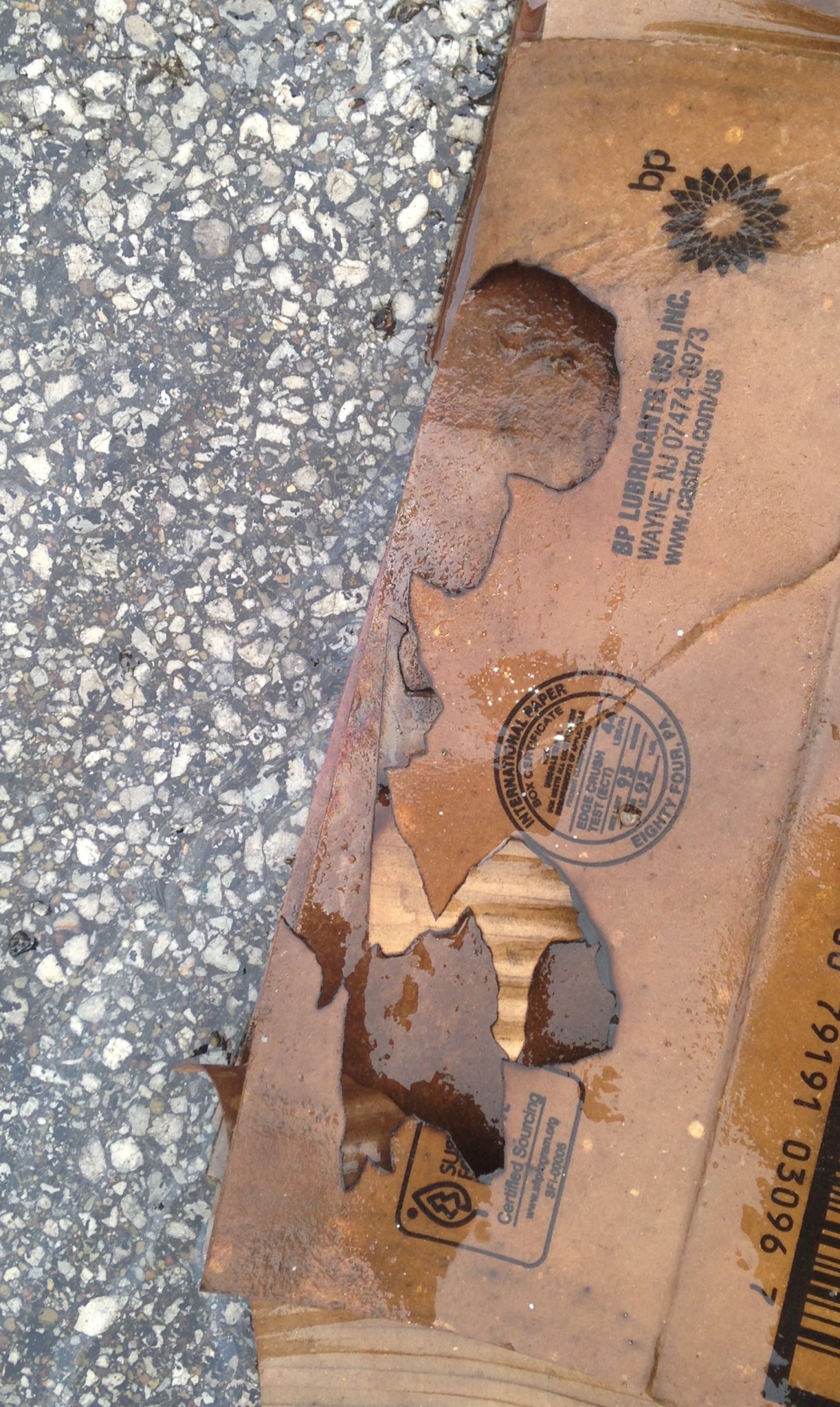

  1. No, I don't smell anything.
    You sure? Smells like a brown lunch bag or something.
    Well maybe.
    A few moments go by then...
    Man you sure you don't smell that? Kinda like fireworks minus gun powder.
    Yeah I smell it a little bit, more like card board.
    Couple seconds go by..
    Damn dude something is burning I'm telling you. Yeah, I smell it too now.
    Shit that box is smoking!!!
    Disaster averted - phew!!!!
    Out side was a cardboard box full of rags. 2 weeks ago they came out of the dirty rag hamper and mopped up big mess of coolant and engine oil when we rolled an engine over. Then they went into that box and sat outside forgotten.
    Spontaneous combustion.
    Be careful guys! This didnt have to start when we were 10 feet away. It could have started anytime.

    Ha, yeah, not an urban myth...
    I think that's why used rag depositories are metal...

    Spontaneous combustion has burned a lot of shops down. You came out lucky on that one.

    At least the box was thrown outside. Scary shit there.
