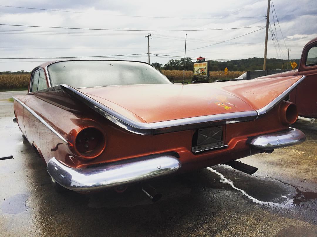

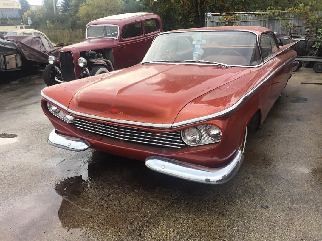

    Sorry its been a while! I work too much and spend as much time as I can with my family so I have limited internet time! Anyway I just picked up this really amazing 1959 Buick. It was one of the cars on the lost custom thread.... well I found it! Its in great shape, runs good, drives good, but doesnt have reverse. The story I got is that the guy put some sort of stop leak in the trans and then reverse went out... I have no idea if this is what really happened, but its what I was told.... the car moves forward just fine... I checked all the obvious stuff and am convinced its a trans problem.
    So I was thinking if I need a trans I would like to get a different one, maybe from a runner, or even a different core to rebuild, that way I wouldnt have to have the buick apart while the trans was getting fixed.
    So dynaflow guys what years will interchange? I found a 58 buick dynaflow on craigslist. Is this the same? Otherwise I will just pull the trans and take it to my trans guy, but If I could pick this one up or find a known good one that would rule!
    So are all dynaflows the same? I mean I understand there are different ones, just wondering what years will work in the 59 without opening a new can of worms.
    Thanks! 14700783_10211095215360323_1772122962762773511_o(1).jpg 14556784_10211103716812854_7330314939846090431_o(1).jpg
