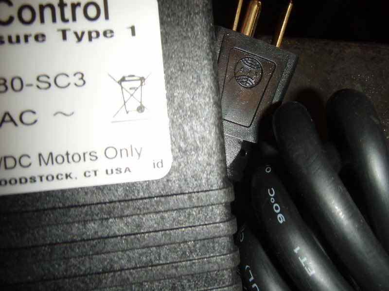

  17. Just got my Pro-Tools bead roller u-weld-it kit. $400, rariable speed, reversable, all American made even the motor.
    Nicely machined parts.
    Heavy wall 2"x3" frame.
    USA made foot switch.
    Gear reduction motor.
    I'll post a thread while I assemble it.
