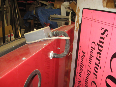

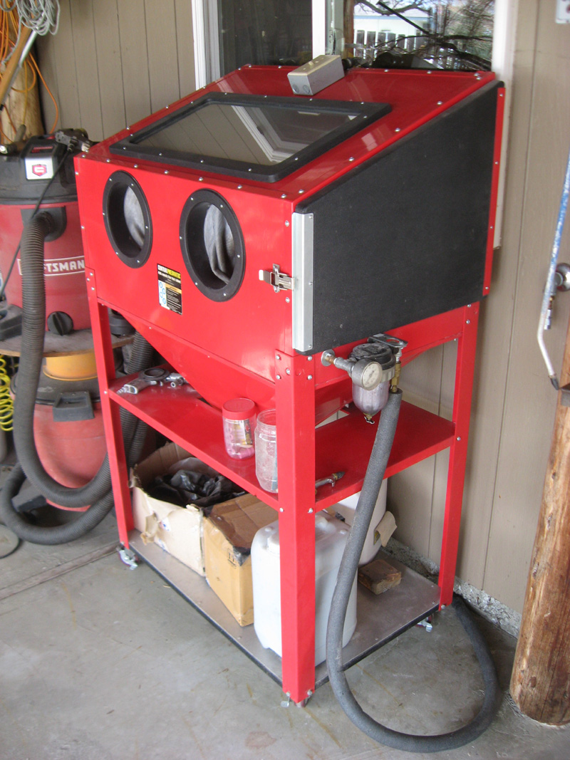

    Here is how I solved the poor lighting problem and some other deficiencies. I still have not replaced the gun but will do that soon. I had to replace the gloves with a better set from Northern tool or HP tools (I can't remember which). I also replaced the window with a pain of gl*** cut by the local gl*** shop for less than 10 bucks. I removed all of the rubber seals it came with during initial ***embly and used clear silicone instead. I also made a floor and installed some casters. This makes it very easy to move around. It's mobility makes it easier to clean up the mess it makes all around it.
    Spot lights I robbed from an old double flood light system.
    I had this old switch box laying around so I installed a simple switch in it.
    The wiring is certainly not up to code but works well.
    I built a 1 inch square tube frame to attach the casters to. I decided to make a bottom shelf which come in handy for storing the blast media off the floor.. The Craftsman vacuum is little strong for this application but really keeps the cabinet clear of dust. The bottom vacuum is just a case with no motor. I tried routing the dust through it before it enters the upper vacuum but it did not settle the dust as I had anticipated. Someday I will have to make some internal mods to it so that it will actually separate the dust from the air.
    I added a moisture separator on the side. It has made a big difference on the amount of moisture entering the sand.
    IMG_1804R.jpg The gray thing behind the spot light is a baffle that was installed last year. It seems to help separate some of the sand from the air before it enters the vacuum hose.
    So you might wonder if I think the cabinet is a piece of junk. No, it's basically a good cabinet for the hobbyist. The mods I made cost me very little as I had most of them in my pile of junk I keep around here because I might just be able to re-purpose it someday.

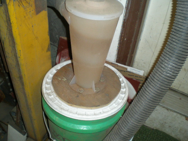

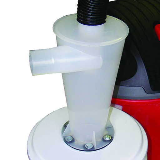

    A separator made with a "Dust Deputy" cyclone and a five gallon pail is another good addition; really saves on the filter in your vacuum getting plugged by the carry-over. I found you need to reinforce the lid with a plywood disc inside and out, not mounted directly to the lid, as in the ad picture I attached. This prevent the lid from ****ing in.
    Oilguy, '51 Norm and The 39 guy like this.

    I did some research on that gizmo a couple of years ago Rich I just never got around to buying yet. Thanks for the tip on reinforcing the lid.

    Grabbed a picture of my separator that shows the reinforcement, the inner piece is the same size. You can kinda see the spiral dust bands left by the internal air flow.

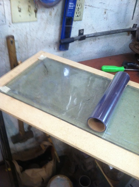

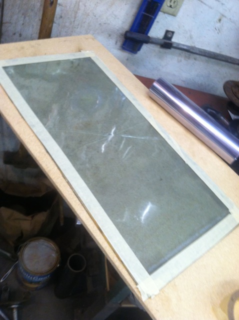

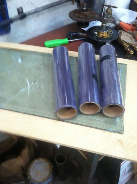

    I've posted this before; but here's another deal to extend window life without buying the expensive cover sheets; I get a roll of clear acetate from the local art store, saw the rolls to the width of my window and attach it with cheap masking tape. Works just as good as the $5 sheets the vendors sell for around 50 cents a cover.
