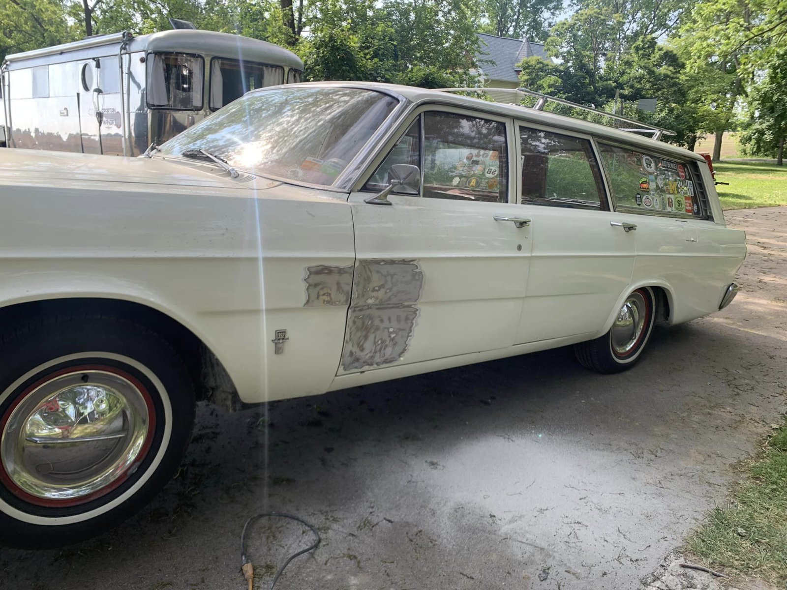

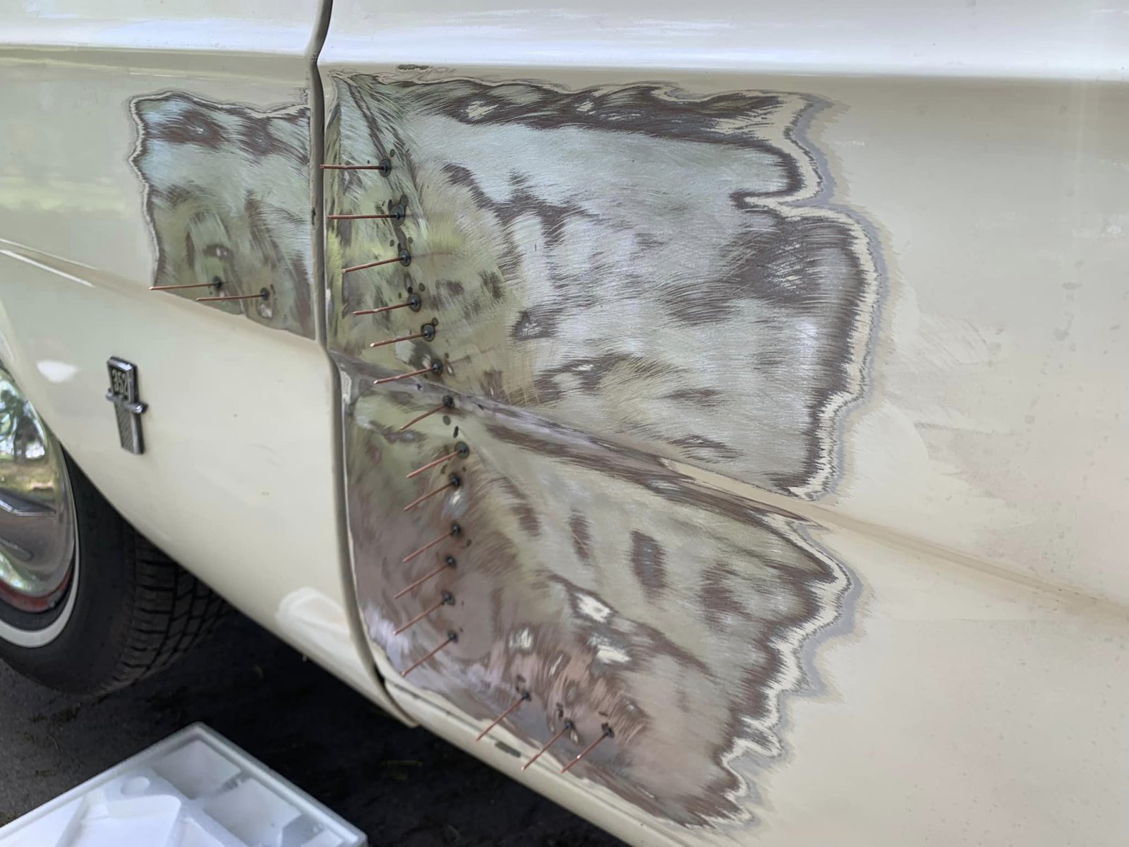

    Last fall our son's '65 Ranch Wagon was damaged when he pulled it out of their garage, and left it half across his wife's garage door. The obvious result was that, since he didn't tell her he'd moved his car there (to put their new kitchen cabinets in his side for their kitchen remodel), she opened the door and backed right into it, wrinkling the left front fender and door.
    We couldn't find a body shop that was willing to to even give an estimate on it (Hagerty insurance) because of it's age, and their refusal to believe me when I told them what was under the paint was, in that spot anyway, virgin '65 Ford sheet metal. So, Hagerty sent and adjuster out to my place (where the car was stored), and I'm going to, unwillingly, fix it.
    It had a bad crease in the front door at the character line, and minor damage to the front fender in the same spot. The paint was broken, so it had to be painted, which will allow me to take care of a slight "wow" where I welded a patch panel on the rear lower corner of that door that bothered me every time I looked at the car. Anyway, I went to HF and bought one of their cheap-o stud welders, on sale, for $77 a while back, and today I set out to see if it would work.
    Holy Cow, does it ever.
    Made the job really simple. I had taken the door card off, thinking I'd need access to the inside, but wouldn't have needed to. The only complaint about that I have is that the trigger is in an awkward place, it should be on the grip, but, other than that, for the money, it's a tool that seems indispensable for home shop bodywork. As much as a MIG welder and hammer/dolly kits and sanding blocks.
    I've got a couple hours of work with some filler and blocking before I can prime it, but it works better than I could have hoped for. 9C407BB8-457D-4A6D-A379-2BBABFB60C13.jpeg AB29A7B0-5398-4D1F-A2E4-4494E8FF8BE7.jpeg

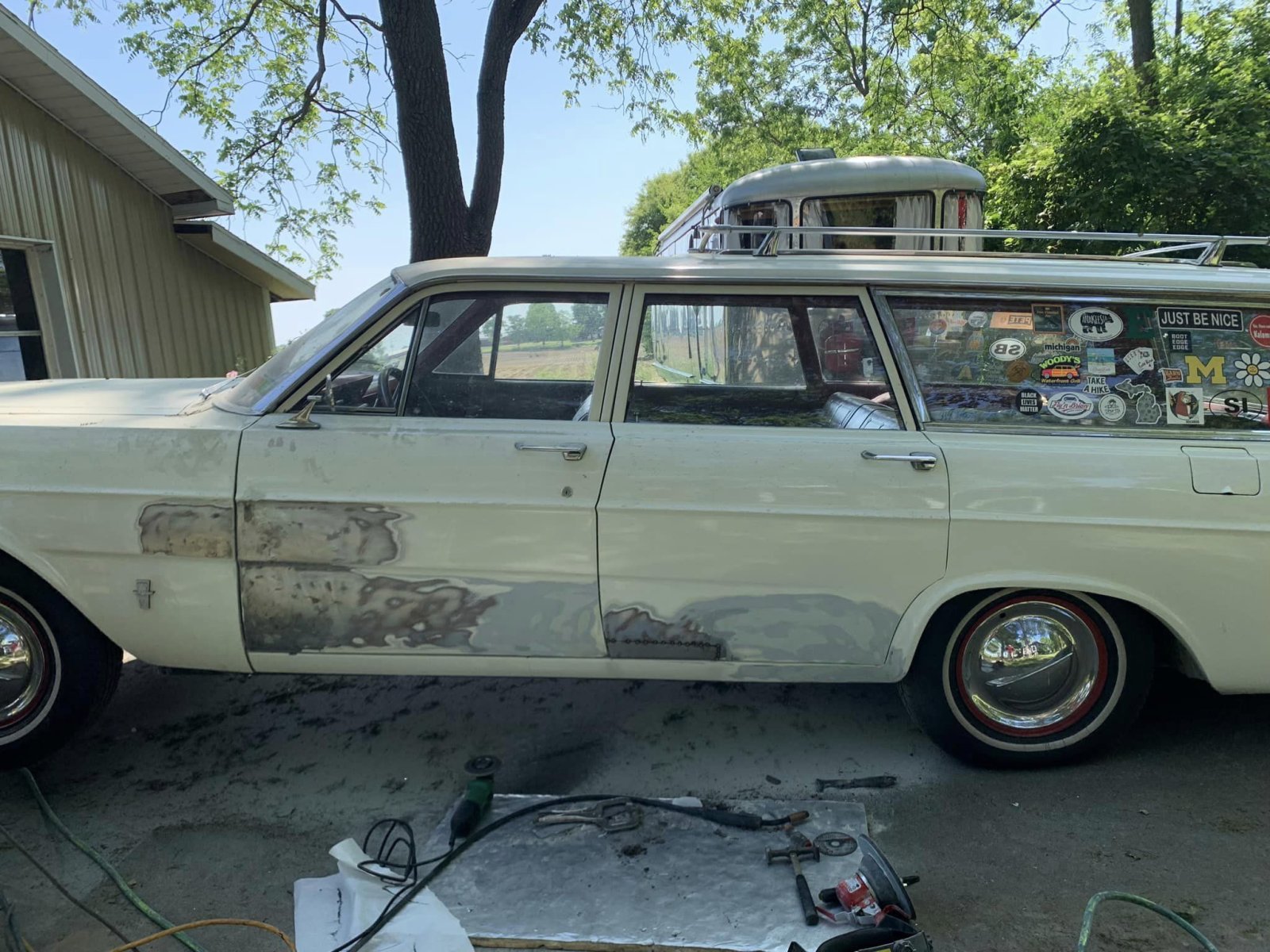

    I had to pull a couple more low spots after I cut the first round of studs off, did that, then used a shrinker wheel. It barely needs any filler at all. It really made what would have been a difficult job easy. May not be the RIGHT tools, but for a home shop, I'm sold.

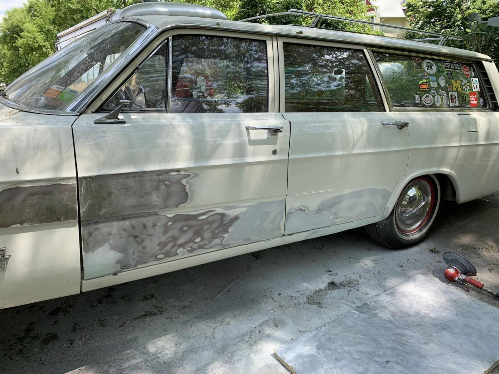

    8D7D0E65-749B-4E23-9D4A-AF68A1167235.jpeg F38C05DB-025E-47F6-B062-424EB455206D.jpeg To follow up: Yesterday I thought I'd quickly get the project pretty much wrapped up, but the reason no body shops would touch the car (or even write an estimate) was made crystal clear. At the bottom corners of both doors (where indeed the sheet metal was virgin '65 Ford) were a couple of tiny blisters in the paint, which of course had rust pinholes behind them. When I'd painted the car for our son 5 years ago, we had made new corners on the rear of both of those doors for the same reason, at the time the front corners of both showed no sign of cancer.
    That was then, this is now. It wasn't a surprise, as the blisters showed, and the dents could have been fixed without addressing the rust, but why leave it, or just pound the spots and pack a little 'gl*** filler, which is what most shops would have done.
    So, on my knees in the driveway (my decision to use the bumper lift and not get the lift out and get the car up at eye level now obviously a poor choice) I made new little patch panel. Both spots are where the outer skin almost touched the inner, dirt leaves and crud were packed in between, leading to the rust.
    My lack of practice welding was brought into sharp focus, but I managed to get them blubbered on without warping the **** out of the doors. While I was still working on the car, I went ahead and pulled three little low spots on the dent with the stud welder. It's hard with the nails on to feel where the panel is, but it's super easy to lift them once all the nails are cut off to tell what needs more work.
    I'm really glad I bought the stud gun, it made this job go really well.
