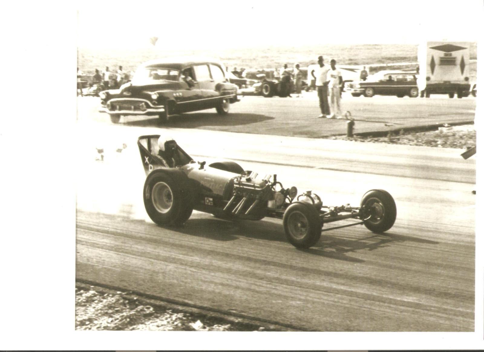

    My older brother ran an X/FD dragster in the mid 60's with a 194, sold the car in about 68, would like to know what happened to it. I've looked around for a cheap 194 but don't seem to be many left. I would like to have a 194 to put in a Model A.
