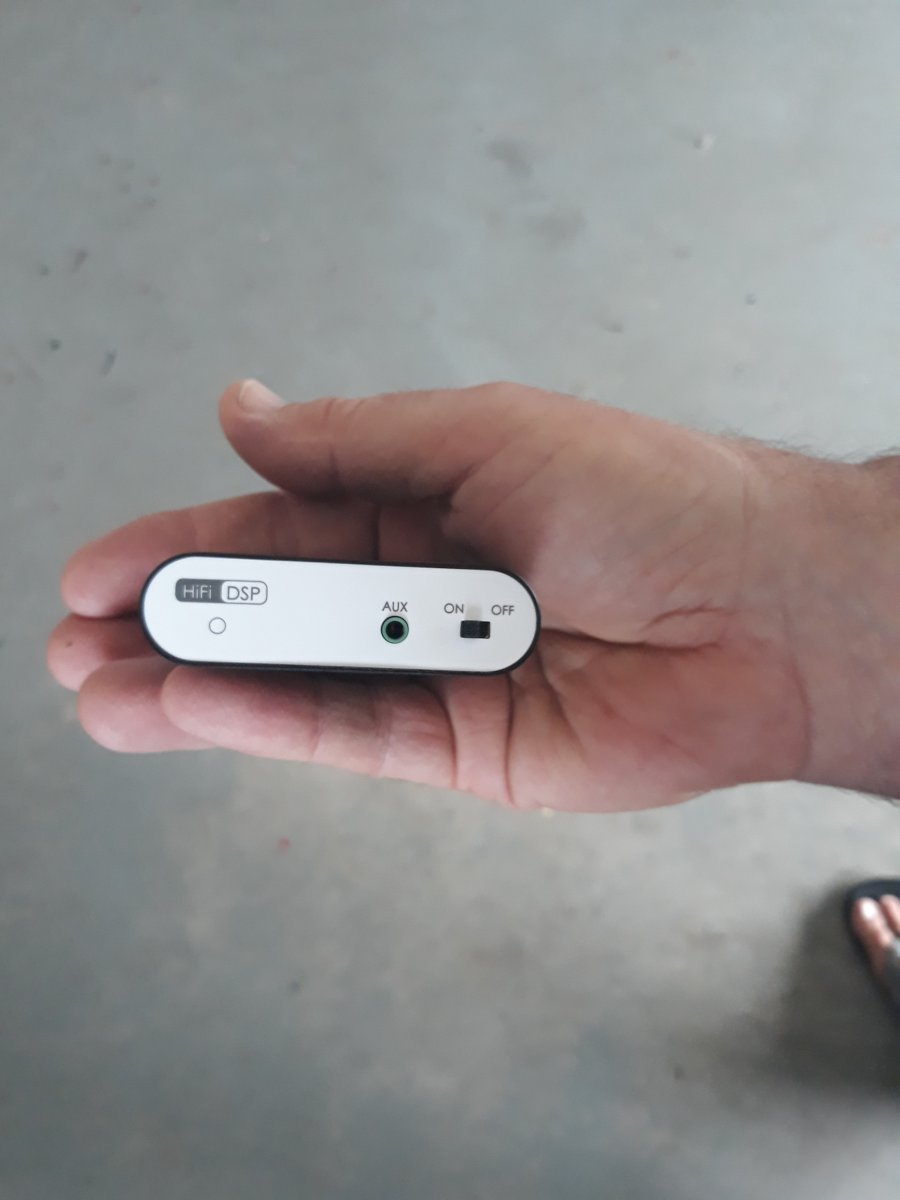

    We purchased a "Nobsound 10G pro" while in China , These are available on Ebay for $27 including shipping [or $38 with the power pack which you don't need to buy]
    https://www.ebay.com/itm/Nobsound-NS-10G-PRO-Hi-Fi-DSP-Digital-Amplifiers-Stereo-Bluetooth-4-2-Power-Amp-/273395819252 The company is trustworthy [you will get the product you ordered]
    This model was chosen over the lesser Nobsound NS-01G because it doesn't require or have a volume knob and has 100w output power. The Amp automatically defaults to "Bluetooth mode" unless a 3.5 jack is plugged into the Aux input and switches the input over to AUX input.[It uses a 3.5mm "Phone Jack" to switch over to Aux]
    The Amp was so tiny which made us skeptical . So we used a 12v computer power pack and hooked up to our home theatre speakers. We paired my phone to it and tried it out.......................It was crazy, the sound it put out was unbelievable.
    We tried an MP3 player via the AUX input and the sound was slightly better. It was now we discovered another hurdle, which was listening to FM Radio.
    To listen to FM Radio from my phone was usually via Headphones ,and the 3.5 headphone wires doubled as an aerial. As soon as I plugged a headphone jack into the phone it switched off the Bluetooth transmitter [this was a phone issue, not the Amp]
    So we needed to make the Amp AUX input accessible and hidden.

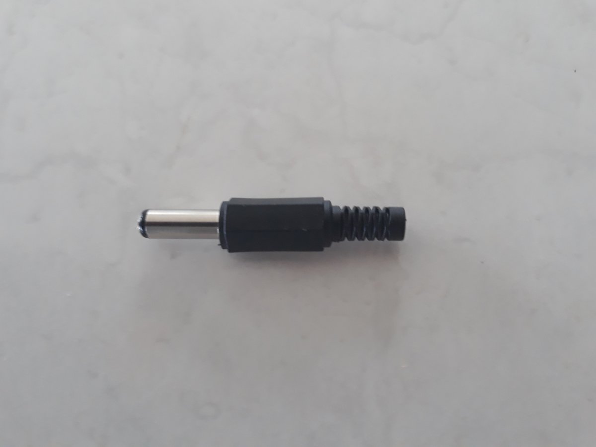

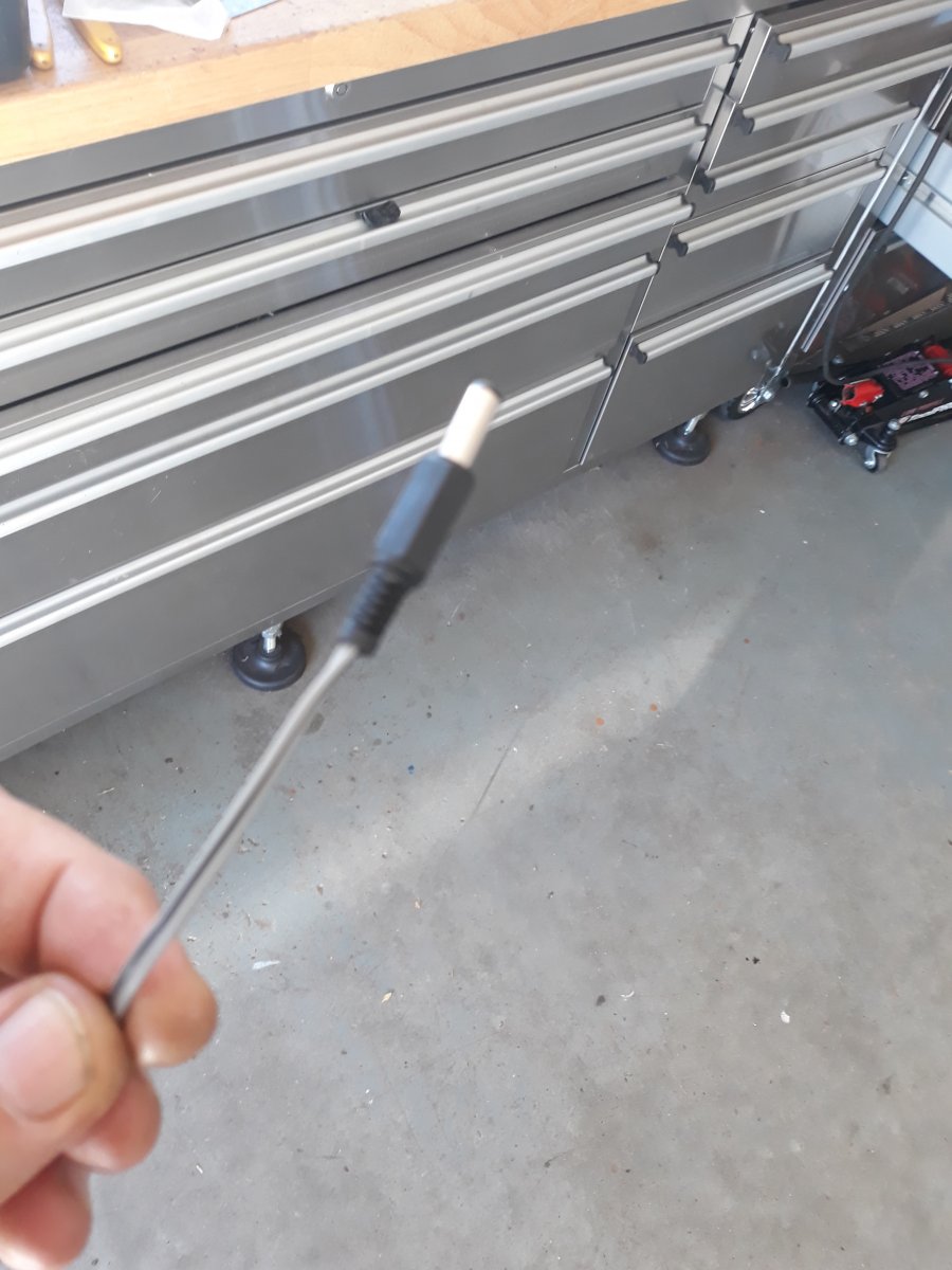

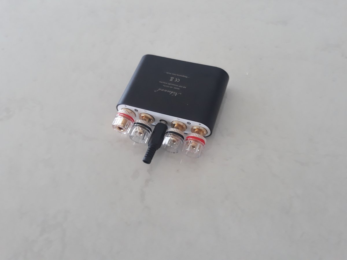

    We also picked up a male power jack plug and some male bullet connectors which are perfect size for the speaker terminals from a local electronics parts store.

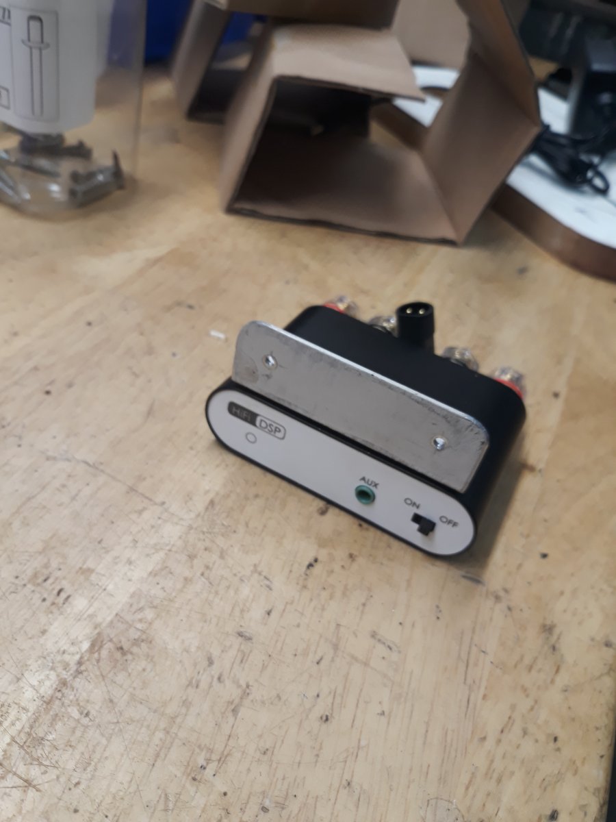

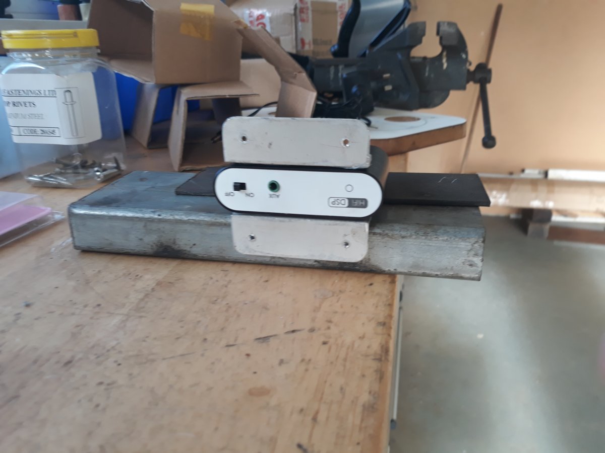

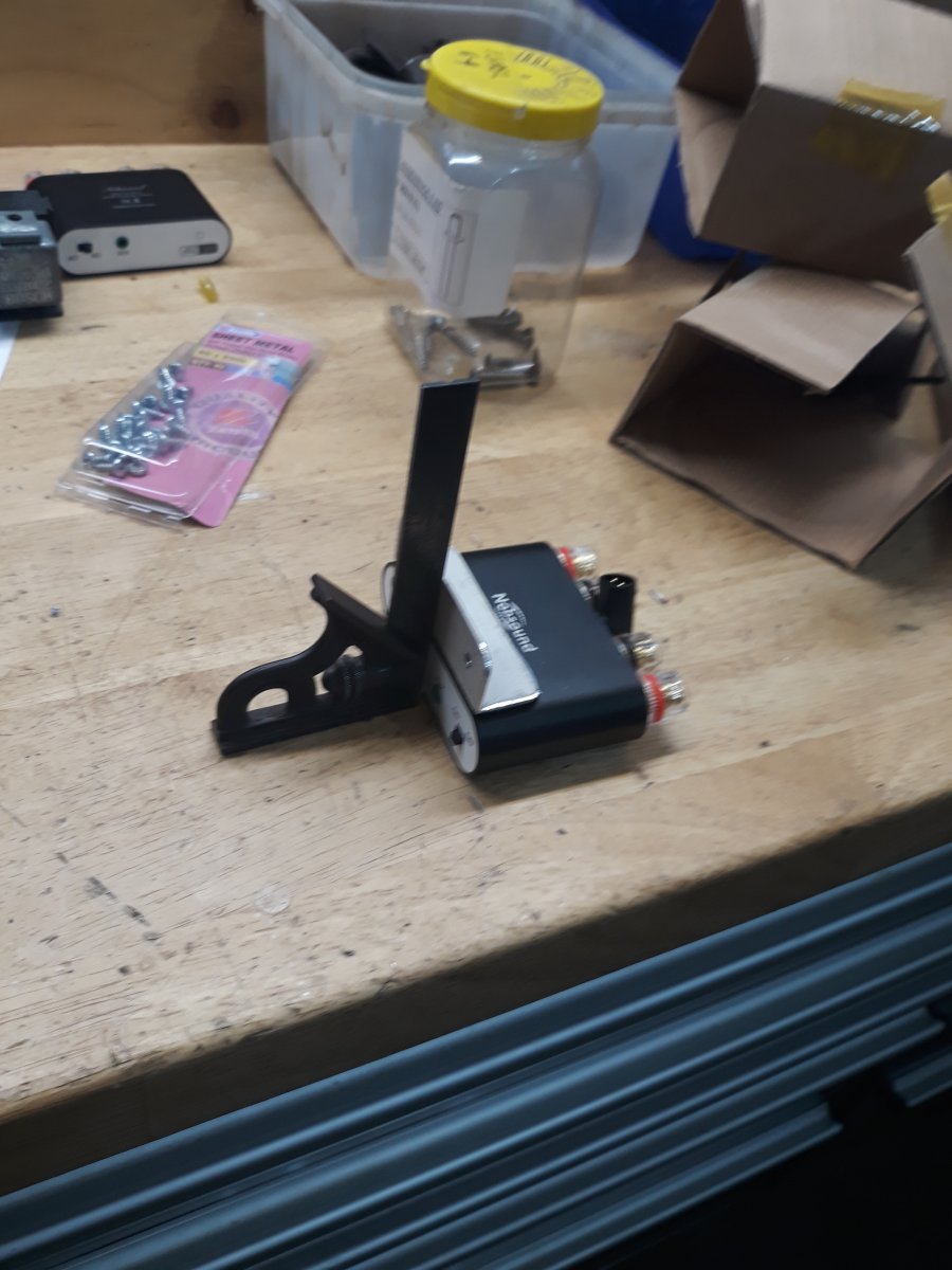

    We wanted the Amp AUX input easy to plug the jack plug into without reaching under the dash or under the seat [while driving] , or the Amp mounted inside the glove box like an afterthought.
    With the 1957 Chevy the glove box is central in the dash and the RH side is an empty space underneath. This space is ideal to mount the Amp flush up against the glove box liner and have a tiny hole punched into the cardboard for the AUX input.

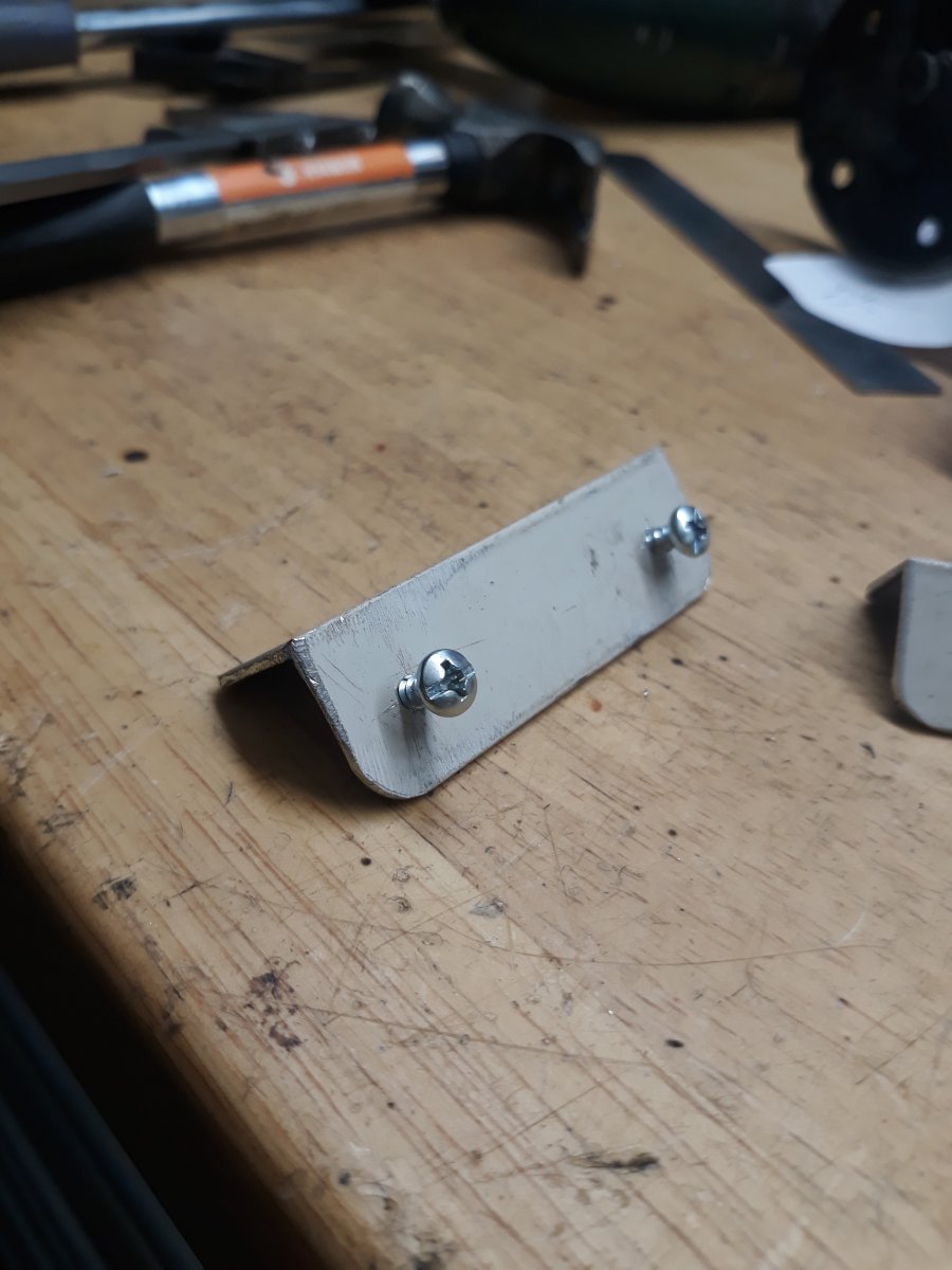

    The Amp has no method to mount it using this method, so we needed to make some brackets. We had some 19mm Aluminium angle which has cut into 2 pieces at 65mm.
    The pieces were cleaned up with corners radiuses, then predrilled and pre-threaded for mounting screws.
    Then we glued the pieces to the Amp [1 bracket on top and 1 on the bottom] , This needs to be done one side at a time, and 12 hours apart .A square was used to keep the face of the brackets level with the Amp face.
    The glue we used was a Urethane which is very strong [Bostik , Simson ISR 70-03]

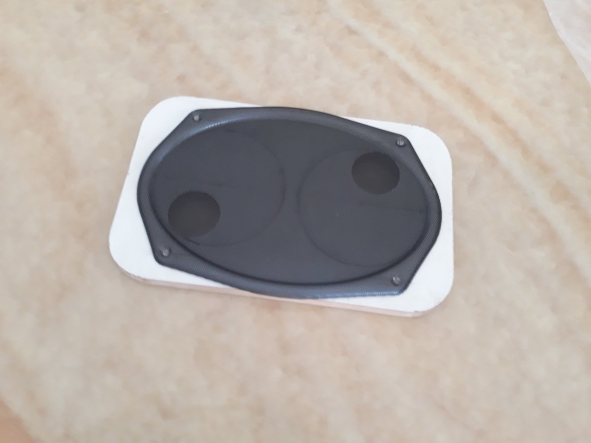

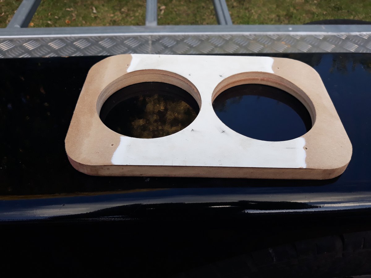

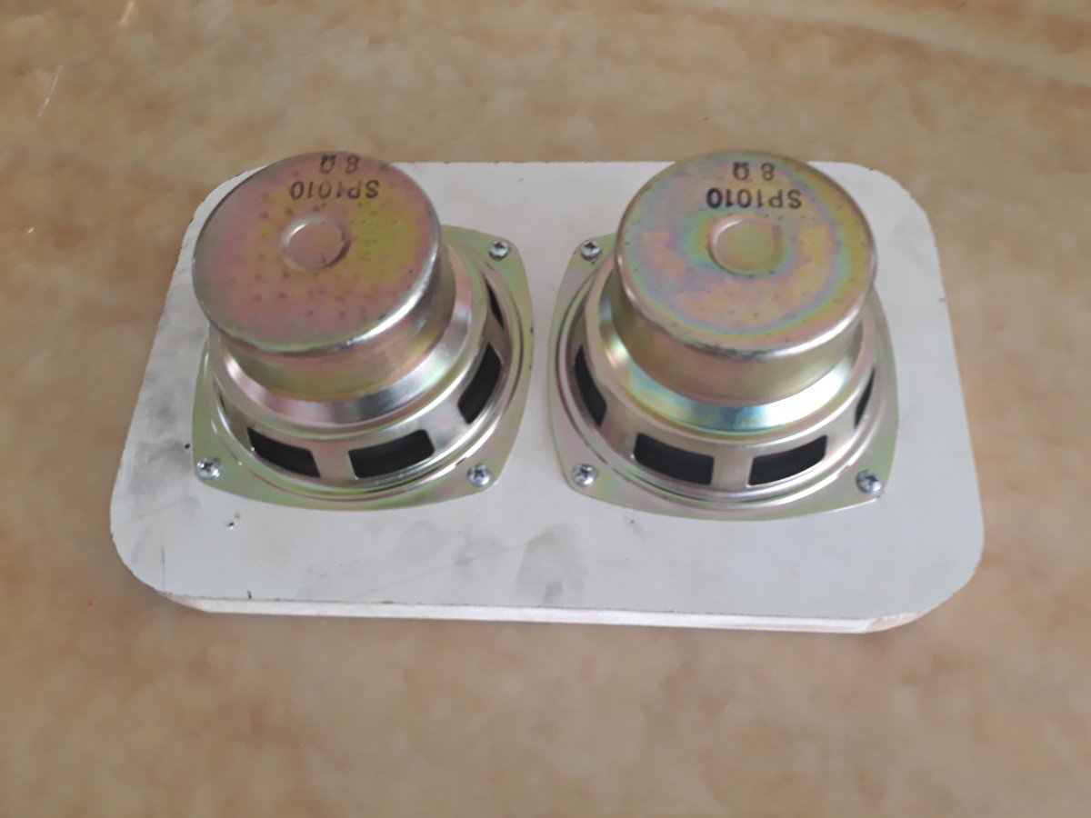

    While the glue was curing , we decided to address the speaker issue [we didn't want to tamper with the existing Factory speaker in the centre of the dash. 1957 Chevy's had a rear speaker option, and the holes for the speaker are already in the rear parcel shelf from the factory, So we picked up a reproduction rear speaker grille.

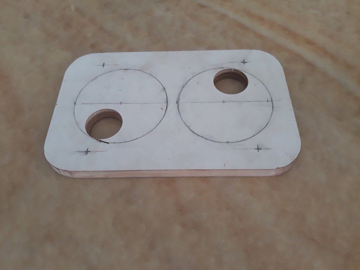

    Using a cardboard template, we marked out all the holes and cut out a piece of 20mm thick MDF [from an old kitchen shelf] This was needed to screw the grille downward through the original holes. and be capable of screwing upwards 2 x modern speakers which probably wont line up with the original holes.
    A friend gave us some old 4" Clarion speakers to try out. These actually sounded OK for us non-Audiophiles but not as good as my home theatre speakers. So quality speakers will make a difference to the end results
    more to come tomorrow ......

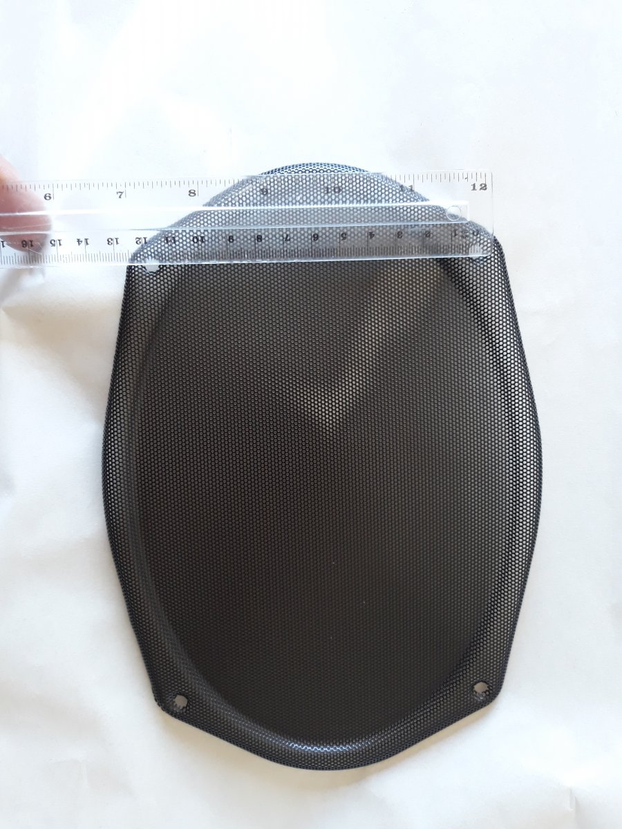

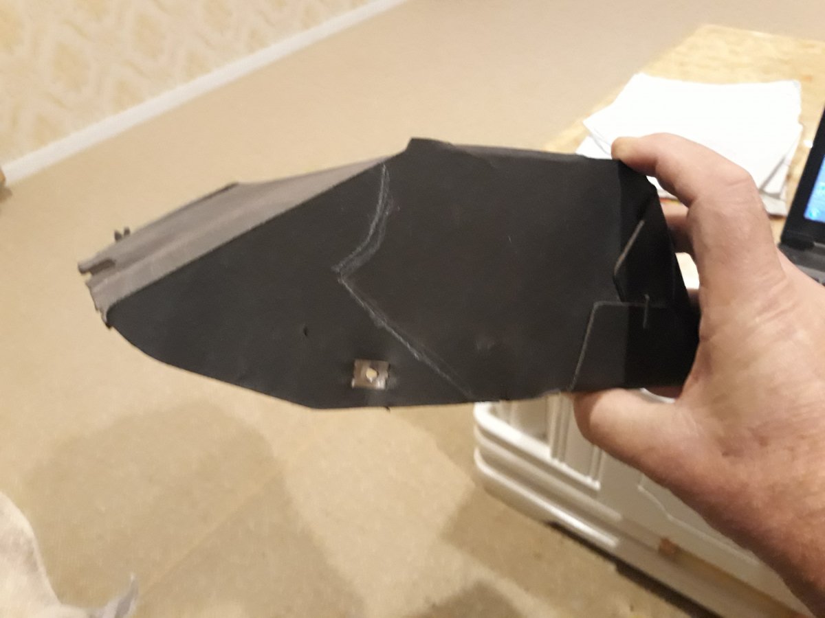

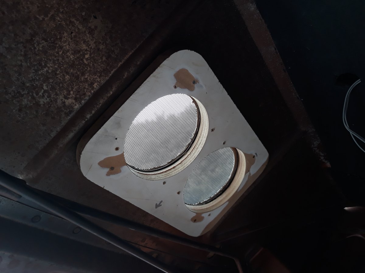

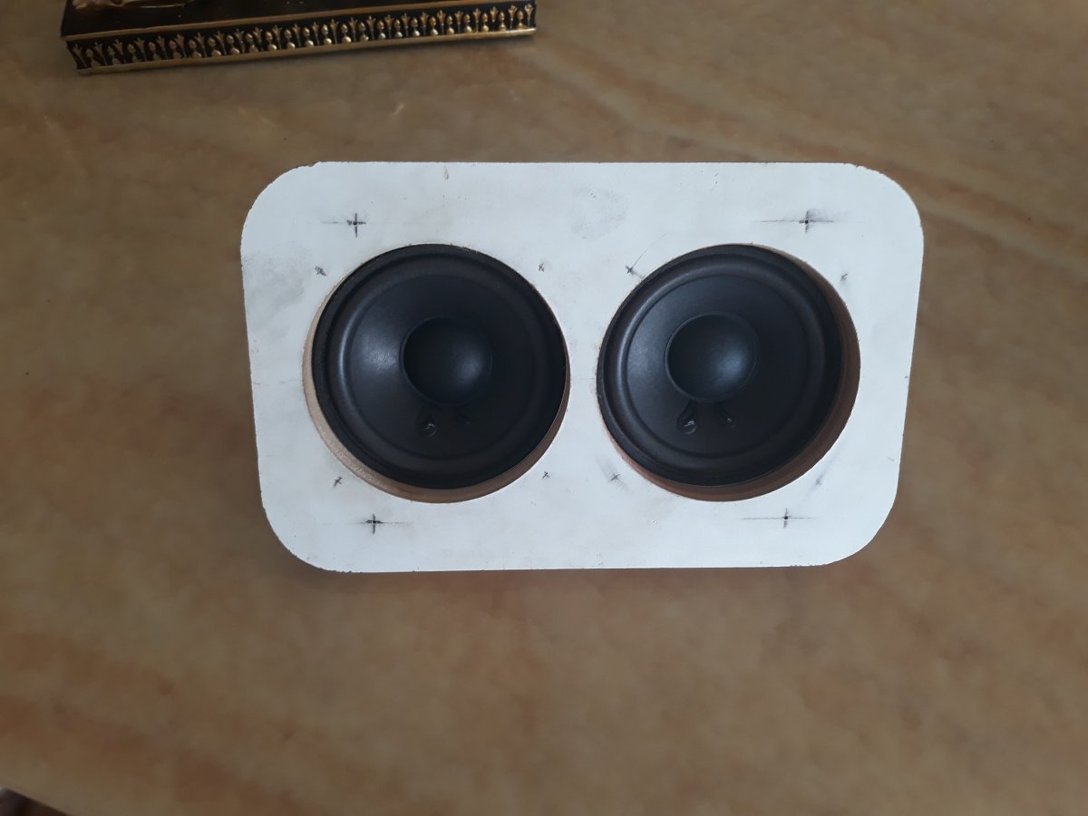

    A trial fit of the speaker mount revealed a curvature in the rear parcel shelf, so out with the 5" grinder and a 40 grit flap disk and this was quickly corrected.[Photo 1]
    When the grille and speaker mount were installed the flap disc was also used to take off about 2mm of the screws that were poking through. [Photo 2]

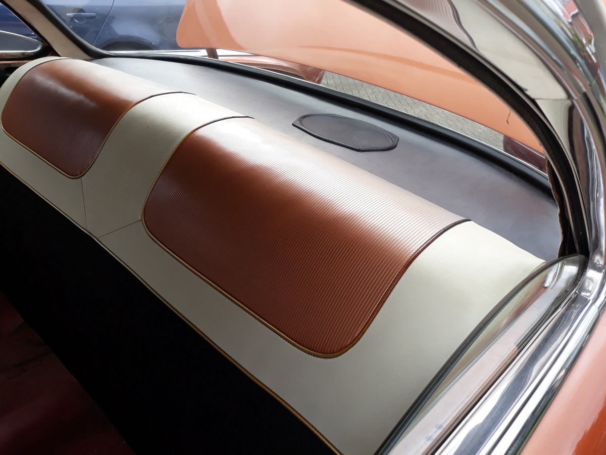

    [Photo 3] shows the speaker wires poking through the hole where the rear seat panel tabs are folded. The speaker wires were routed along the R/H side of the car under the wiring covers and up the kick panel. This is normally the most difficult part of the whole job but my husband showed me a trick. He pushed curtain wire down behind the rear seat and inside the wiring covers and taped the speaker wires to it, and dragged the wires through . The seat squab needed to be lifted forward a bit for access.
    [Photo 4] shows the rear seat with speaker grille finished

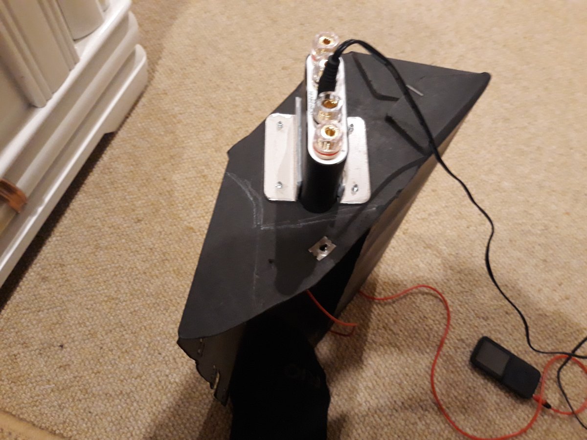

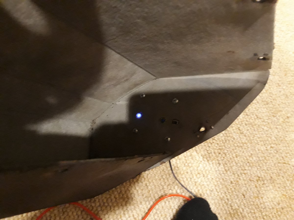

    Now that the glue has cured on the Amp it is time to mount it to the glove box liner. Before this was removed, we needed to check to see if the glove box door stopper/arm didn't cause any interference issues.
    The glove box door was closed, and the stopper was marked with a white marker.[Photo 1] Also the glove box roof angle was measured to get the Amp mounted level. A scriber was used to poke holes in the liner and it was screwed in place from inside the glove box. [Photo 2]
    The Amp was removed, and a paper template was made using the holes to locate it. The template was needed to mark holes needed for the AUX input jack and the coloured Indicator light [both were 7mm holes] . Also a tiny rectangle hole was cut for the on/off switch .
    [Photo 3] shows the blue indicator light on Bluetooth mode and this same light glows green on AUX input mode.
    The glove box line was re-installed . The most difficult part of this whole project was re-aligning the glove box door to close properly

    The speakers were easy to connect, crimped bullet connectors fit into the holes in the Amp Terminals nicely. And the male power jack plug was soldered to some dual core wire. As an extra precaution some hot glue was used to keep the wires from touching each other.
    In most installs it could easily be finished now by simply connecting this wire to a 12v switched source and Ground. [photo 1]

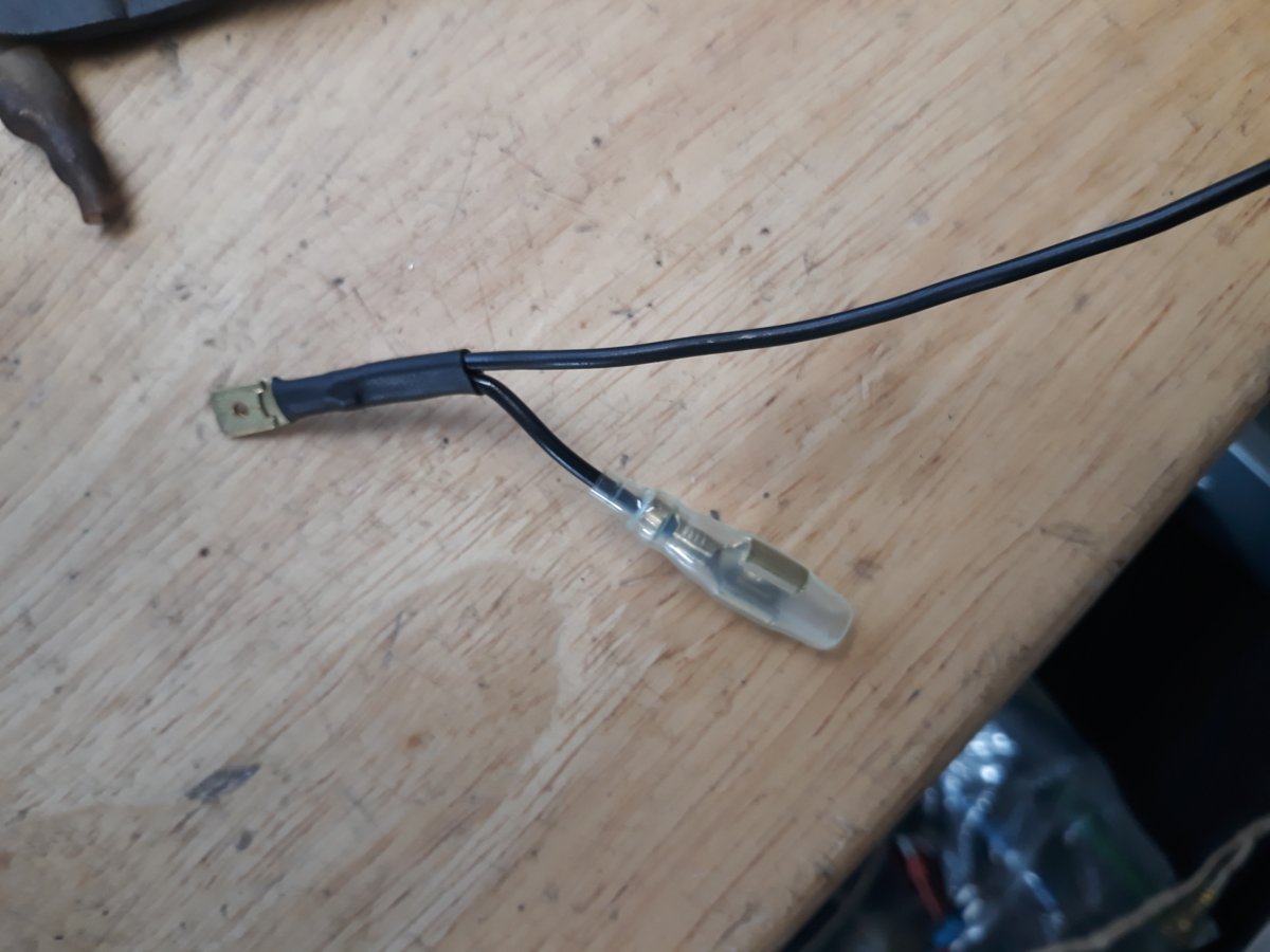

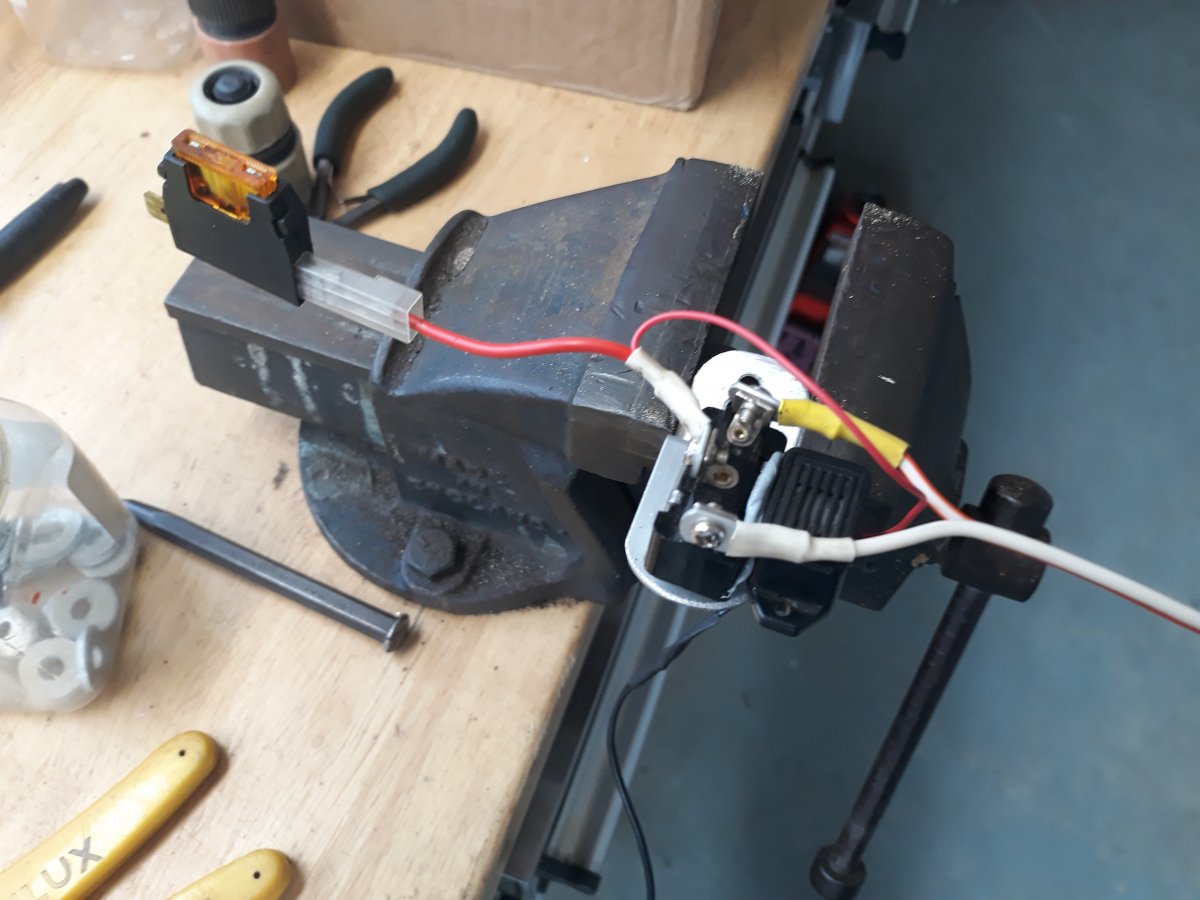

    But early Chevy's have a minor problem caused by the lack of accessory position on the ignition key. We both enjoy parking at the beach and listening to the radio [coffee / pizza etc]
    The power source could have simply been hard wired to the 12v power source at the fuse box [interior light circuit] but all it would take is switching off the phone/MP3 and forgetting to switch off the Amp and the battery will slowly drain over the next 7 days .

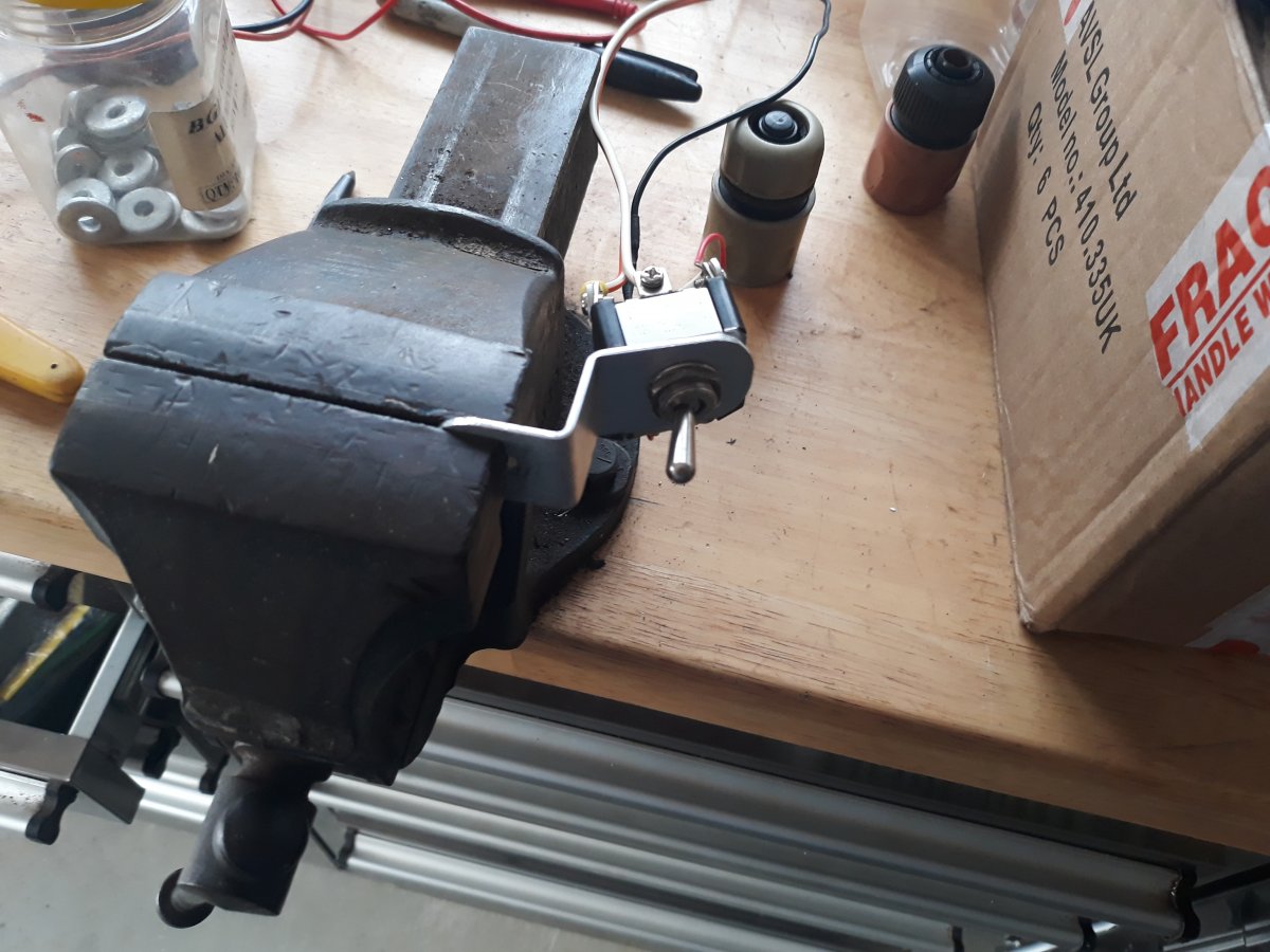

    In a box of old electrical components my husband had a 3 post diverter switch [ on / off / on ] normally the power source is the centre post and it can be switched either direction diverting the circuit.
    [Photos 2 & 3] show this switch, and the simple dogleg bracket was shaped to fit inside the folded edge under the dash. There were some existing factory holes under the dash beside the handbrake lever.
    This switch was reverse wired. The centre post goes to the Amp and the 2 outer posts come from the 2 different power sources [one is the normal key switched side of the fuse box, and the other from the 12v interior light circuit power source on the fuse box ]
    So when we want to listen to the radio without the engine running ,a simple flick of the switch can save the points ignition burning out

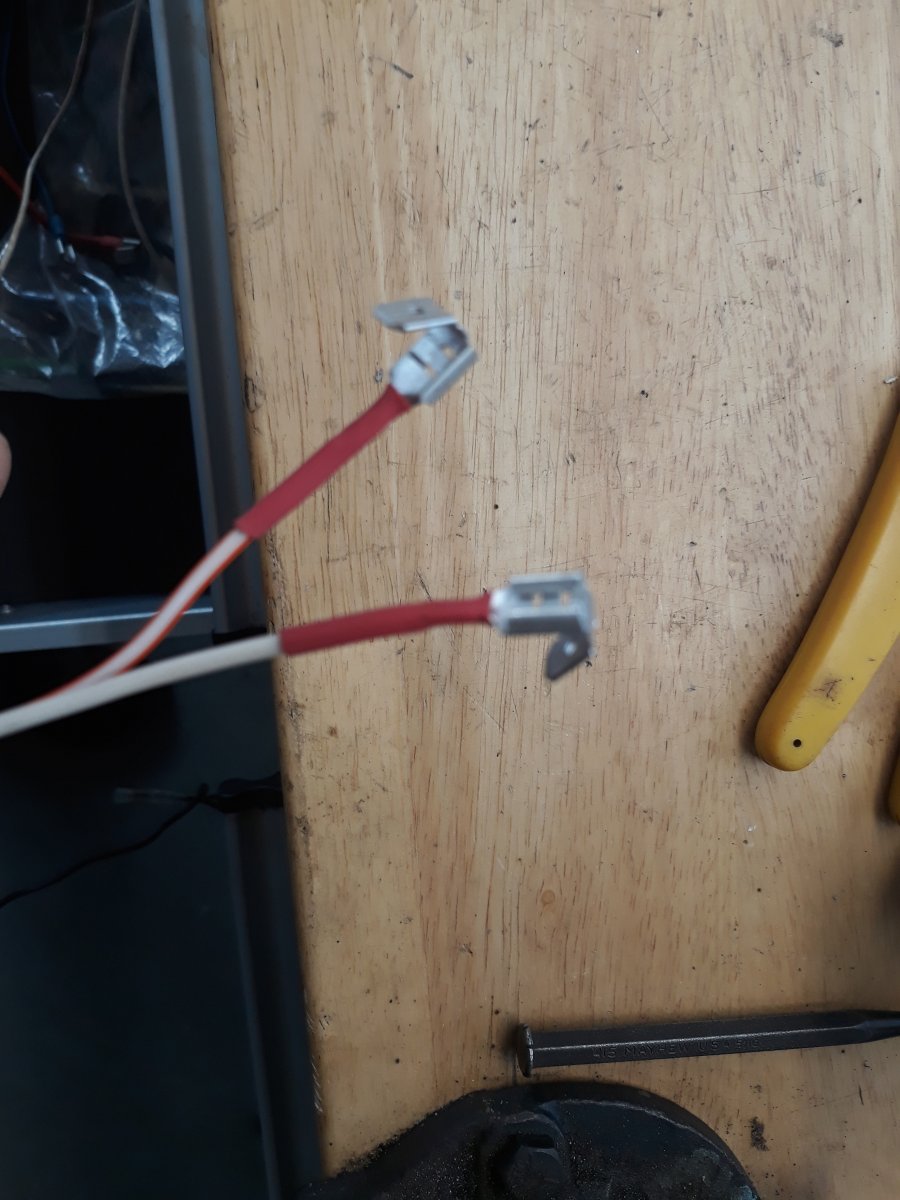

    [Photo 4] shows the 2 fuse box wires with male/female spade terminals . These go in between the Interior light and the factory radio terminals and can simply be restored later by unplugging.

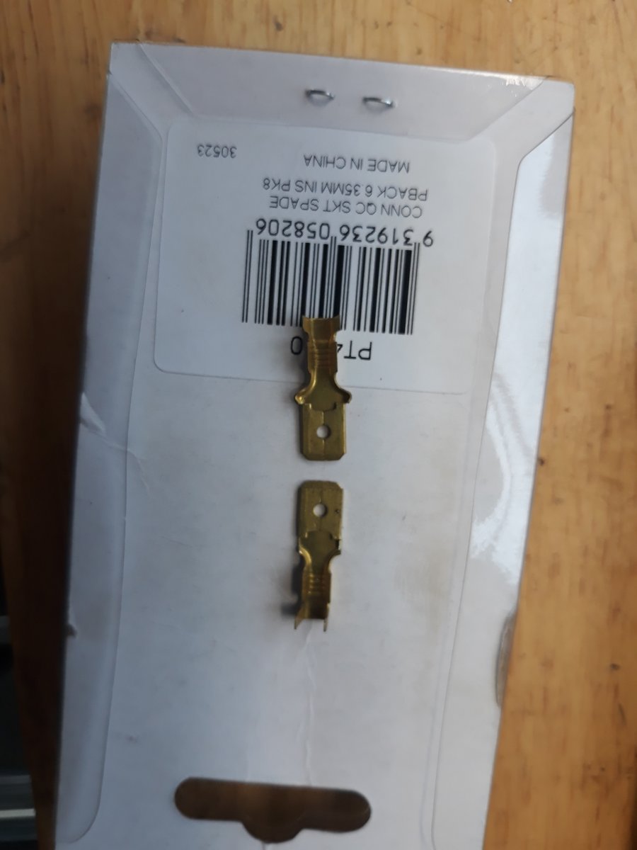

    [Photo 3] The tangs on a male spade terminal were filed down to fit into the factory Chevy door switch ,and a female spade terminal was spliced to this to re-connect the original factory door switch wire. [Photo 4] Again this can be simply unplugged and restored
    This Piezoelectric buzzer only buzzes when the door is open AND the Amp is getting power. so if the key is OFF and the switch is in normal position it will be quiet. If the switch is left on in the 12v constant power position [interior light side] it will buzz when the door is open.
