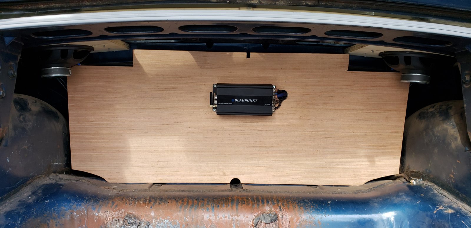

    The Amp is in the 1st post .
    There is a link.
    I connected 2 dedicated speakers on the parcel shelf directly to the amp.
    My 57 radio has it's own speaker on the dash which has not been tampered with.
    If I was to do this again, I would mount the Amp under the seat or parcel shelf and forget about the Aux input.
    Bluetooth from the phone is good enough for my needs.
