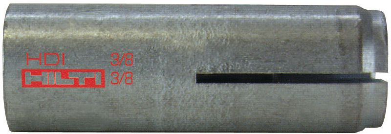

    I've got one of those cheapie tire machines. Don't know what brand it is 'cause I bought it at a swap meet about 20 years ago. It looks just like the HF model shown below though.
    I want to put 4 anchors in the middle of my concrete shop floor that I can use to bolt this to when I need to use it. BUT, 99.99% of the time I won't want it there. So I need a way to put bolts into the anchors but not have the bolt heads stick up where I would trip on them. If there're no bolts in the empty anchors in about 3 days the holes will be full of dirt/grit and no bolt would ever go into the anchor again.
    I've had this thing bolted to a pallet ever since I bought it, but I need the floor space and want to get it off of the pallet.
    I'm thinking if I had a masonry drill bit larger than the bolt head (and appropriate sized socket) I could just countersink the bolts down into the concrete to where the bolt head is flush with the surrounding concrete. Unfortunately I don't have any such animal and don't really want to put out the ca$h to buy one to countersink 4 holes.
    Anyone got any better suggestions than buying a drill bit?

    Check with Lowes or Menards and look in their cement section and see what they use to anchor things in cement.

    put four set screws into the anchors when you're not using the thing. You can make them by cutting the heads off bolts, and cutting a slot in the end with a hacksaw.

    Look for a female threaded drop in anchor. Hilti makes different sizes. Plenty strong once set.
    It makes sense to machine a screwdriver tanged top .. to replace the bolt. Thanks for the idea, Squirrel.

    Suggest looking at a HILTI catalog for flush concrete inserts. They work just like any insert, except they are "innies" as opposed to "outies", & you use bolts to retain your tire machine, & have a flush surface when you remove them. I would also suggest using allen set screws in the holes when the machine is in storage, to keep dirt out of the holes. It's really a lot simpler/easier than it sounds!! LOL!

    you can rent a larger concrete drill bit to counter sink the hole so the bolt head sits flush to the floor once you thread it back into the insert
    Or carefully chisel a recess in
    Only gotta go down the thickness of the bolt head.
    And like squirrel said, use a hack saw and cut a line in the top of the bolt so you can unscrew it with a screw driver once it’s in flush.
    or be fancy and use Allen head bolts !!

    also, check Grainger and other hardware supply locations for Red Head concrete anchor fasteners

    Recess the anchors slightly and use rounded head Allen bolts.

    Years ago at work we put lead sleeves in the hole and then thread a Lag bolt into that which can then be unscrewed leaving the sleeve in place.

    I would use anti seize on the bolt threads when you screw them in. It will help keep them from binding up with the grit from the floor that will find its way into the socket threads.

    I used those inserts on my floor. When I need to use them I just blow it our with my air compressor.

    "Set-screw" type allen will thread down into floor-anchored nut of about any size you want. (You'll probably have to clean the dirt out of the end of it when you want to get the allen wrench in it for removal.) allen.jpg

    Thats what I used. Small ones from hydraulic fittings work perfect.

    Like a few have said. Flush shell anchors are the cat’s ***.

    Thanx everyone for your replies. I hadn't thought of hacksawing a slot in a bolt or using allen head set screws.
    I like those ideas.
