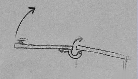

    Not sure if any of the aftermarket hidden hinge kits are like your setup, but, the way to make the doors clear the body is to have a u bend originating from the door. The "U" portion of the hinge attaches to the door, the extreme end of the U is the pivot and that happens in the cowl area. That way the door opens and swings OUT. Seems to me you are pretty lucky it opens as far as it does. The design you have there (which looks very clean and good workmanship too) has the pivot point directly between the door and cowl which will force the door in the body.

    I think you want to move your hinge point more forward (towards front of car) and then extend your mounts to fit it there. I find Drawing a sketch (overhead view) and even cutting out the pieces parts and maniupulating them through their actual travel can be a huge benefit.
    Think like setting up a tilt front end - having the pivot point LOWER than you horizontal cut plane allows the GAP to increase as soon as you tilt it. having the pivot too high actually closes the gap as you initially tilt it. Same sort of thing here - since you are using a simple pivot design (single pivot) you need to space the pivot forward so things move on a less severe arc. Now you know why the early manufacturers stuck those hinges OUT so far and why the later ones went to mulitple pivots and linkage. Not being there to see exactly your problem makes it hard to be certain, but moving forward makes sense in my head.
    I hope it helps.

    here's a quick CAD sketch showing one way it might work,
    move the pin forward and put a longer dog leg in it
  6. The key to the hidden hinge design is to get the pivot as close as possible to the cowls outer skin.

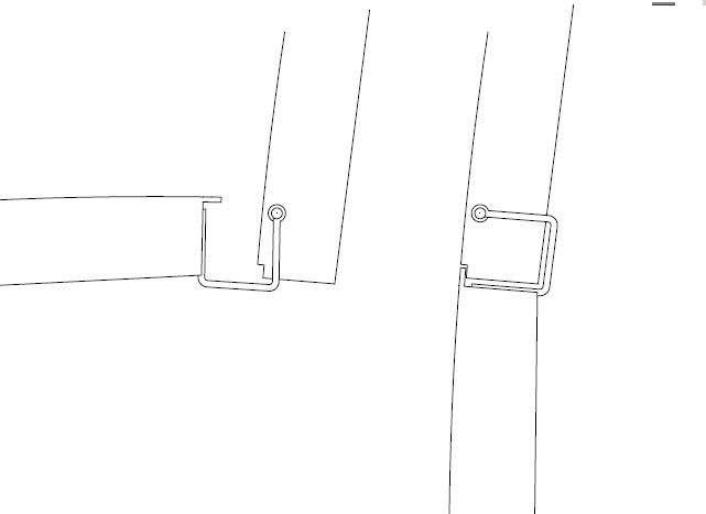

    I made my own hidden hinges very similar to yours so I’ll through a few comments out. The most important part is the hinge pin location and remember every thing is going to be a compromise. Right now your look to be to close to the door jamb and located to far inwards on the body.
    This diagram shows a rough position of your hinge. The closer your pin location is to the jamb the smaller the arc of the door opening. This will cause interference at the leading edge when opening the door.
    By moving the pin location away from the door you will increase that arc and eliminate the interference but cause one with the hinge arm. You could make a hinge that protrudes into the cabin area but doesn’t look very good. You also put more stress on the hinge and pin by going to far back.
    Here is a diagram of my hinge and location. Final location was limited by inward curve at the bottom of the door and cowl. By moving the pin location as close to the outer cowl skin as possible you can decrease the distance between the pin and door. This also keeps the whole hinge inside the door jamb. My doors open with no clearance problems put had to make sure they stop before hitting the fenders at the bottom of the door. I also trimmed the hinge corner and door jamb so that the hinge arm would swing open a little more. I would also spread the upper and lower hinge apart as far as possible to distrubute the weight better.
