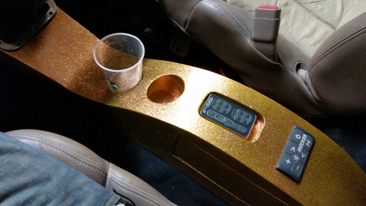

    I had posted this in another thread about wanting an out of sight-out of mind radio the other day I would definitely use it again. there are probably cheaper methods, but this was worth it to me and as it was really simple to install. theres a small rubberized remote that will flush mount in a rectangular hole also for forward/back tracks and volume controls.
    And the wired remote, I just put it a little out of sight but still plenty accessible in the seat divider/ center console
