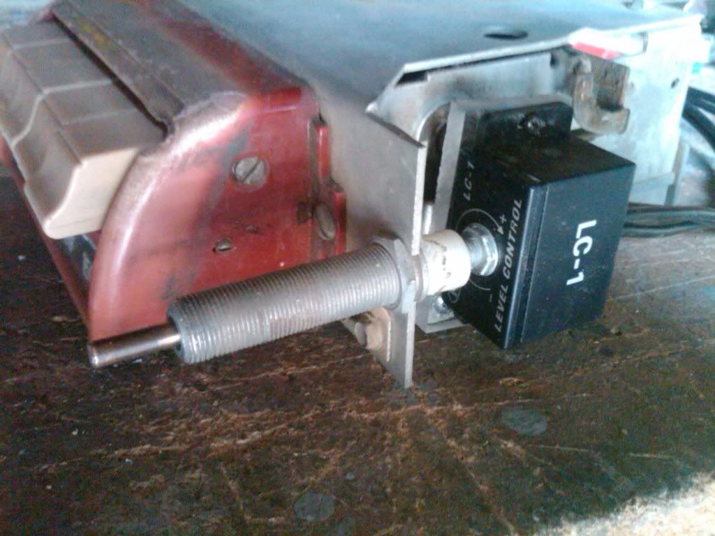

    I ordered a PAC LC-1 for my '59 last night. I have all the other parts to use the headphone jack on any mp3 player... Soon!
    I'm switching to an electric choke, so I'll have the stock choke knob location for the "volume".

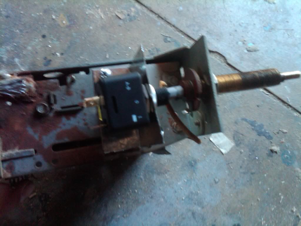

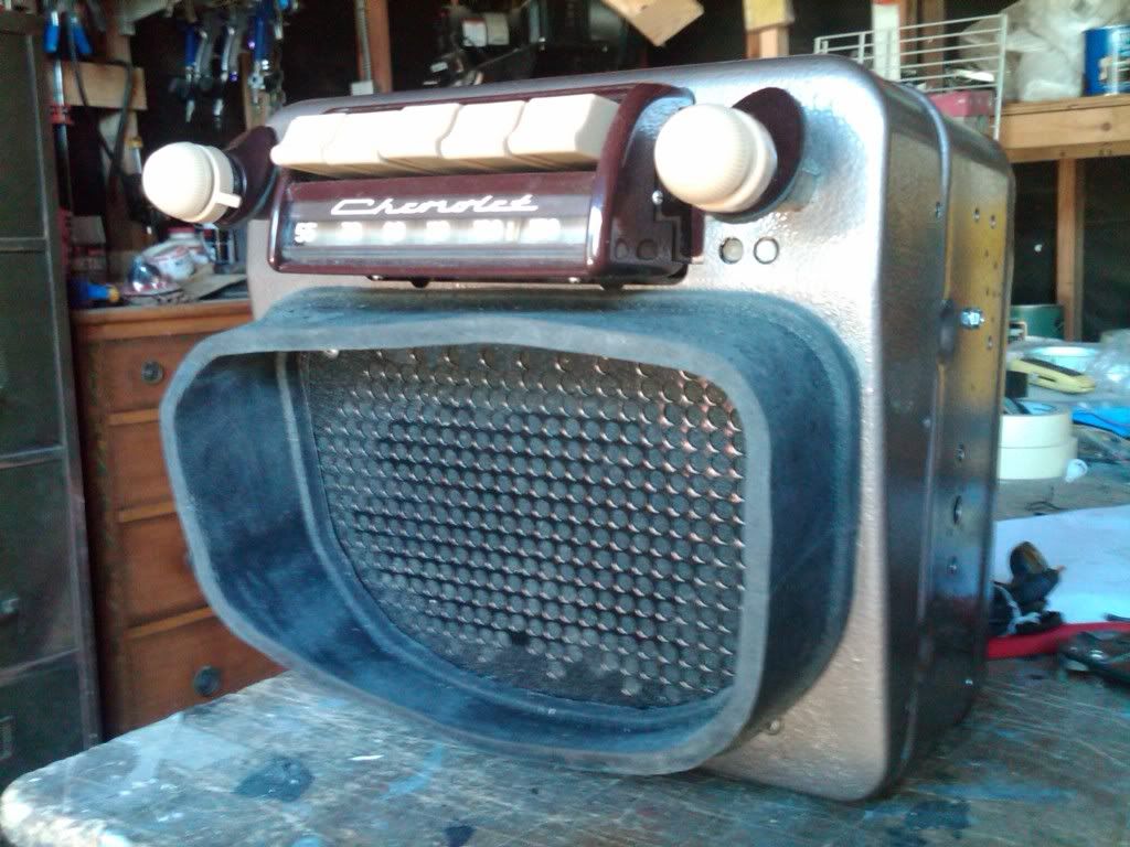

    This is a good tech. I followed a similar one up and with a bit creativity I fitted all that inside of the original radio. Hook up one knod to an on/off switch and the other to the volume control. Wired the inside light of the radio to the dash lights and splitted the output so I could use a 3mm jack for my blackberry or an IS76 for my ipod. Sound comes thru 4" polk speakers..the sound is great with nice fidelity, stil gives me some b***, not much but enough and I bet it can fool more than one looker out there.

    What did you use for the off/on switch? That is a great idea! I was thinking of doing this in my '57 using the original radio bezel/dial and then using one of the knobs for volume control like what you did. I was going to leave the other knob rigid but then your post came along. Also, since you are not using the ipod flat connection, do you now have 2 places to control the volume? I am planning on using the 3mm jack too as I just have my kids old mp3 player - they have the ipods! But that's enough for me. :cool:

    I used a rotary switch from cole hersee ($10) but you can use a wiper switch (single position, about $5 on ebay)
    With the 3mm jack I simply set the volume on the highest for the blackberry (in your case the mp3 player) and dial the volume as needed with volume control on the radio.
