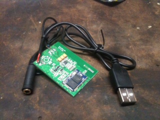

    I was thinking of going the PAC route as well, but I ran across this when I was looking for cheap speakers to use
    Bluetooth Module BT-1 - Parts Express
    Basically it's a Bluetooth antenna you can plug into any AUX input (or in my case directly to the car amp) and will play sound directly off your smartphone, wirelessly over Bluetooth. I like this because I can use the phone I already have, and it was nice and cheap. It'll even play from up to 40ft away.
    I haven't had a chance to install a stereo yet, as I am in the middle of a cross-town move, but I tried it out by hooking it up to the boom box I use for garage tunes. It works like a charm!

    This is interesting....how do you wire it?

    It gets power from the USB (which is for power ONLY and not for data) so you can either hook it up to cigarette lighter type USB adaptor, or cut it off completely and hard-wire it into your ride.
    Once you have a power source figured out, just connect the audio out to your receiver, crossover, amp, or whatever will accept a music signal... you can use your phone to control volume level, so I plan on hooking it straight to an amp just to keep things simple. :)
    So far this thing has been working great. While packing it has been dutifully playing the music on my phone through the garage stereo (where I hooked it up temporarily) even though my phone is in my pocket and I'm walking around... should be great in my ride!

    Check out page 10, post 181. It got me thinking.........Yes, I'm putting tunes in my Plymouth g***er even though I won't be able to hear them:D. So, I had done Ryan's install in my 64 Belair and it worked good. But I didn't like it plugged in - wires, knob, etc.....Plugging it in and out every time:(. Most of my trips are short / I don't need the device to be charged by the car. So I start to research the BT-1 on post 181 and it is a 5v input, not impossible to do - but the damn thing doesn't even come in an enclosure. It also has bad reviews because it's so fragile. So I wondered - does someone make a 12v unit that comes in a finished housing? Here's what I found.........
    http://www.ebay.com/itm/350575749971?ssPageName=STRK:MEWAX:IT&_trksid=p3984.m1423.l2649
    Yeah, it's a bit more $ (still cheap) but it's 12v and finished in a case! Amp + this thing in the trunk and done. Besides, the battery is already back there!:cool:
